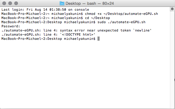

Dschijn Posted August 13, 2015 Share Posted August 13, 2015 @Misha: Please use this script: http://forum.techinferno.com/mac-os-x-discussion/10289-script-automating-installation-egpu-os-x-inc-display-output.html- Why do you use a riser?- How do you power the AKiTiO?- Connect the external monitors directly to the eGPU to get eGPU performance. Don't connect them to the MacBook or any Thunderbolt ports! Quote Link to comment Share on other sites More sharing options...
Misha Posted August 14, 2015 Share Posted August 14, 2015 @Misha: Please use this script: http://forum.techinferno.com/mac-os-x-discussion/10289-script-automating-installation-egpu-os-x-inc-display-output.html- Why do you use a riser? - How do you power the AKiTiO? - Connect the external monitors directly to the eGPU to get eGPU performance. Don't connect them to the MacBook or any Thunderbolt ports! Thank you very much for your answer! I really missed this step. I downloaded file "automate-eGPU.sh" on desktop, and then step by step introduced the team to the terminal. But I'm not sure that everything is done correctly. I attach photo from the terminal. I followed the advice of this article https://odd-one-out.serek.eu/thunderbolt-2-egpu-setup-using-akitio-thunder2/#comment-1120 Do you think the riser is not necessary? At the moment, the original power cable is not connected to Akitio Unfortunately, after this operation, my monitor still does not see the signal from eGPU connected directly to it. P.S. I'm really junior in this topic and I apologize for the maybe stupid questions, and I hope your answers will not be too difficult for me. Quote Link to comment Share on other sites More sharing options...
Dschijn Posted August 14, 2015 Share Posted August 14, 2015 No, you shouldn't use a riser!- Try to power the AKiTiO with your Corsair CX500M. Did you do that? http://forum.techinferno.com/enclosures-adapters/8317-%5Bguide%5D-making-molex-barrel-adapter.html http://forum.techinferno.com/enclosures-adapters/10090-visual-guide-opening-akitio-thunder-2-pcie-box-powering-via-barrel-plug.html- Seems like you didn't download the "automate-eGPU.sh" correctly (sth that I am totally confused by as well at github....). Please open the file with a text editor and make a screenshot as well- Any questions regarding the script, please post them here: http://forum.techinferno.com/mac-os-x-discussion/10289-script-automating-installation-egpu-os-x-inc-display-output-16.htmlEdit: @Misha: Here is the direct DL link: https://github.com/goalque/automate-eGPU/archive/master.zip Quote Link to comment Share on other sites More sharing options...
Misha Posted August 15, 2015 Share Posted August 15, 2015 No, you shouldn't use a riser!- Try to power the AKiTiO with your Corsair CX500M. Did you do that? http://forum.techinferno.com/enclosures-adapters/8317-%5Bguide%5D-making-molex-barrel-adapter.html http://forum.techinferno.com/enclosures-adapters/10090-visual-guide-opening-akitio-thunder-2-pcie-box-powering-via-barrel-plug.html- Seems like you didn't download the "automate-eGPU.sh" correctly (sth that I am totally confused by as well at github....). Please open the file with a text editor and make a screenshot as well- Any questions regarding the script, please post them here: http://forum.techinferno.com/mac-os-x-discussion/10289-script-automating-installation-egpu-os-x-inc-display-output-16.htmlEdit: @Misha: Here is the direct DL link: https://github.com/goalque/automate-eGPU/archive/master.zipThanks for the answer! I will try to do molex-to-barrel adapter. In the future, I plan to use Dell ZVC220HD12S1. It is more compact and, together with the eGPU it will look better. I would be happy if you know the instructions how to connect this adapter to Akitio. As far as I understand it will be enough power for my GTX970.I downloaded automate-eGPU.sh through direct link to the desktop, and then step by step, repeated the command in the terminal and then restarted the computer. The system parameters have changed and now in the Monitor tab under two monitors the Nvidia GTX970 is displayed. However, a direct connection to the secondary monitor GTX970 works only via HDMI. When I connect a secondary monitor via DisplayPort again appears "No Signal". However, at the moment of connection the main monitor reacts to it. And besides the mouse cursor on the secondary monitor began to move with strobe as if the monitor began to show less fps. It looks very bad. And naturally deteriorated image quality as compared with connecting the monitor directly to a MacBook through a Thunderbolt DisplayPort. This is most likely due to the fact that I have 4k monitor and HDMI does not support this feature. When I connected the monitor directly to macbook back (Thunderbolt-DisplayPort) after the action in the terminal without using eGPU, mouse continued move with strobe. Maybe I made a mistake when typing commands in the terminal. At this time, I had a MacBook attached to external video card and a second monitor via thunderbolt simultaneously. How to remove strobe in the image and haw to make the DisplayPort connectors on the GTX970 work properly? Until I decided to try it with Riser. But in the nearest future the card will be connected correctly via molex-to-barrel for example Quote Link to comment Share on other sites More sharing options...

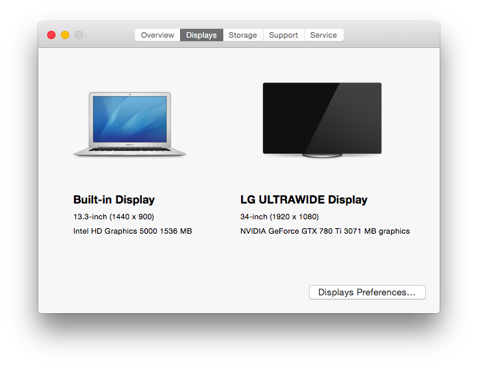

tuckerchapin Posted September 1, 2015 Share Posted September 1, 2015 Works like a beauty on 10.10.5 2013 MBA + 780Ti. However, I have two questions -- one of which its more likely you'll be able to actually answer. 1. As you can see, I have an LG 29" ultrawide which should be 2560x1080p, but OSX refuses to see it as anything but 1920x1080p and it looks super stretched. Any ideas? I'm using HDMI. 2. On a similar but much less important note, OSX doesn't detect the display (although it does have a speaker) as a viable option for audio output, any idea how this could be remedied? Not a big deal as I can just connect the 3.5mm jack, but the fewer the cords the better! Thanks! This script is FANTASTIC and makes the whole process a lot less stressful and way more accessible. Quote Link to comment Share on other sites More sharing options...
Dschijn Posted September 1, 2015 Share Posted September 1, 2015 Maybe your TV only can run FullHD from HDMI?Can you check if there is a firmware update for the TV and maybe a driver for OSX? Quote Link to comment Share on other sites More sharing options...
martinm0 Posted September 1, 2015 Share Posted September 1, 2015 [ATTACH]15854[/ATTACH]1. As you can see, I have an LG 29" ultrawide which should be 2560x1080p, but OSX refuses to see it as anything but 1920x1080p and it looks super stretched. Any ideas? I'm using HDMI.Is it possible that the HDMI out on the card only does 1080p? Have you tested another port from the GPU to see if DVI or DP provide the full resolution? Which card do you have? Quote Link to comment Share on other sites More sharing options...
