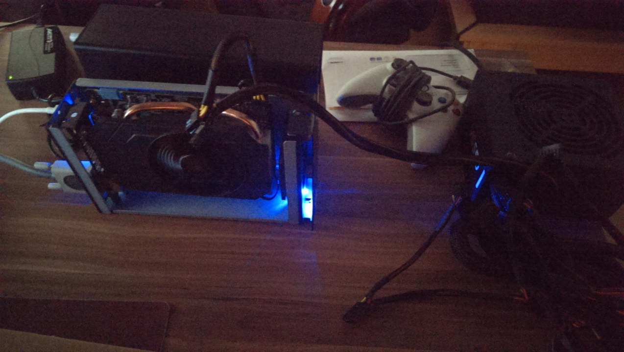

I've just started to setup my eGPU with:
Akitio Thunder 2
GTX 960 mini Gigabyte
Coolermaster 650w (Paperclip)
So my problem is I can't install the Nvidia drivers. I've put the GPU into the PCI slot in the akitio box. Then I've connected the akitio Power supply. And then I've connected the 6-pin Cable into the GTX 960 from the Cooler Master.
I'm booting up my mac (Mid 2014 13'') and pressing alt. When the bootcamp selection start I turn on the coolermaster and the akitio PSU. After that I press boot windows (windows 8.1 preview). When I'm searching for the egpu i cannot find it in the device manager either in OSX.
When I trying to install the Nvidia drivers (the newest one) it says ''Nvidia Installer cannot continue'' ''The graphic driver could not find compatible Graphics hardware''.
The fans on the GPU started the first time I booted the computer (That was in OSX) and after that thay never started again.
The akitio box blue and green light is up. I've connected the akitio through thunderbolt (ofcourse).
I've put a HDMI Cable from the GTX 960 to my external Acer minitor and made it as the main screen in windows 8.
Could you guys help me out? Why dosent my computer detect the GPU? I've tried the troubleshooting steps in the forum but it doesnt work. Help.<!-- google_ad_section_end -->
I'm using the same card with an Akitio, only difference is that I've got a MBPr 15" 2014 model and another PSU(which shouldn't be the bad guy here).
I've used the card both the way you try to do and it worked as well as the known powered riser way which I currently use so I could put it in a case.
I boot the following way:
- Power up the Macbook, hold Alt so the boot choice appears.
- Wait for the wifi networks to be found, then I power up my PSU(you need to power up both your PSU then, nothing regarding the eGPU is powered up to this point)
- Wait 30s or more
- Start Windows.
How did you install Windows? With bootcamp? Drivers are properly installed, especially the Thunderbolt drivers? Check in device manager if you've got an entry "Thunderbolt" under System devices.
If nothing helps, do a SMC reset and a NVRAM reset. I've had it too, that my eGPU wouldn't boot up properly and this fixed it because something was weirdly stuck in the system.
Found the solution. The GPU didn't got enough power.. That's probably why the fans never turned on. Waiting for a riser cable now. The Akitio box and the 6 pin didn't provide 120w if my math is correct. I'm going to pick up a gtx 970 so i can use two 6 pin and the problem should be solved.
How that? Like I told you I've got the same components and it worked. The 6 pin provides 75W. The remaining power comes from the slot even though it's labeled as 25W only.
Dosent the card need 120w to run? Hmmm I will look into your solutions!
Yes, under full load...?
You either don't read what I write or you don't want to understand what I write, I don't know.
75W by 6 pin + 45W(if 120W would be the maximum need) provided by the slot of the Akitio. The Akitio PSU provides 60W and although the slot is labeled as "25W only" it provides more than this.

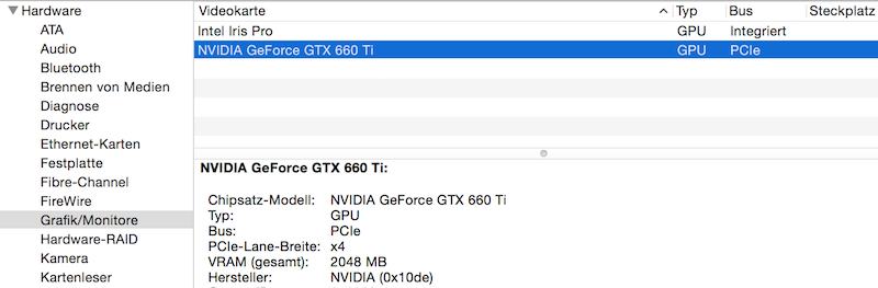

I have set up my MBPr mid 2014 15 inch with Intel Iris Pro with the Akitio thunder2 and a gtx 660ti from nVidia, however after all drivers were installed and all kext files were edited, I'm still not able to use the card as preferred. It is being recognised as shown below.
I'm able to use the external GPU to render in blender using CUDA, but it's not able to use it as an outputting device nor as a default card. Is there any way to fix this? Thanks in advance!
