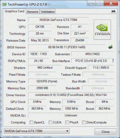

Smitry Posted September 15, 2014 Author Share Posted September 15, 2014 BSODed after last post, restarted in safe mode, disabled the 770m in device manager , restarted, works fine, but clearly not ideal. GPU z now senses the gtx 770m and heres the readout. any suggestions on what vbios to try? or what drivers with modified infs?or where to sacrifice the lambs? seriousy... anything would help me after 24 hours beating my face against the wall Quote Link to comment Share on other sites More sharing options...

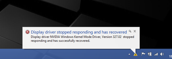

Smitry Posted September 17, 2014 Author Share Posted September 17, 2014 UPDATE: So i re-upgraded to windows 8, and downloaded all of the updates, i flashed the 770m vbios with MSI stock bios and installed forceware 327.02 driver as suggested in some thread i now lost to the vastness of the internet when i upgraded upto win 8 again, voila! GPU is now correctly recognised! VICTORY IS MINE! ,,,sort of PROBLEM #2: Windows 8, GTX 770m Driver 327.02 keeps crashing - BSOD ???_POWER_STATE_FAILURE when under load - for the first 3-5 startups. Downloaded geforce experience, installed, scanned the card correctly, downloaded appropriate drivers - BSOD - safe mode - revert drivers manually downloaded several versions of drivers - BSOD - safe mode - revert drivers Downloaded modified inf and drivers from laptopvideo2go, - BSOD - safe mode, revert drivers. Tried gaming - installed GW2, 7DTD and Bf4 - Gw2 works great, looks great - bsod every now and then for no apparent trigger (not exacerbated by on screen battles) 7dtd - works grea, looks great the gpu is DEFFO working because my intel card could barely run this prior to upgrade. -1 BSOD so far. BF4 does not work on these drivers, needs newer drivers, fails to launch Whenever i start a a game, the gpu driver crashes and restarts and i get this error popup - sometimes this preceeds a BSOD here is my gpuz read So i basically need a stable driver? Can anyone please help me with this? <3 Quote Link to comment Share on other sites More sharing options...
