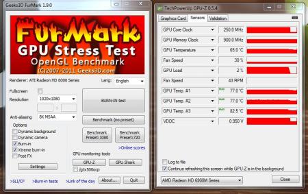

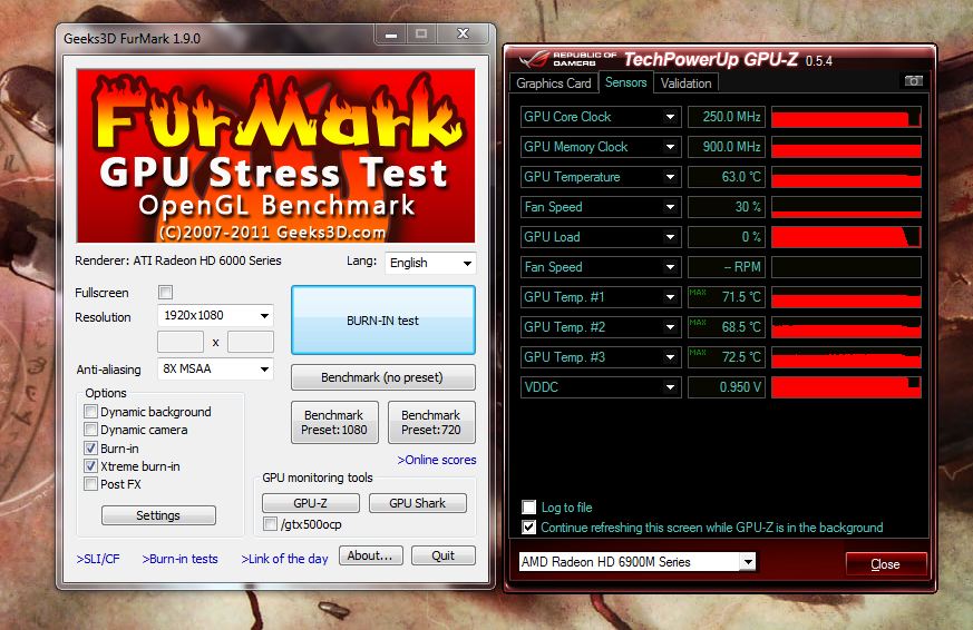

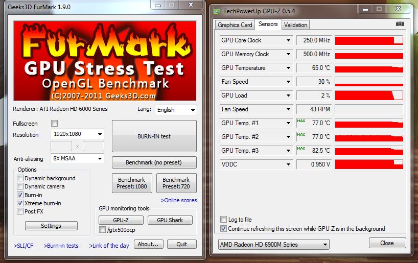

Hmm, CPU idle temps went up by about 5-7°C since I measured them short after the repaste...?? GPU is also up a couple of °C. I think I'll have to check this again when I come around to do so... I though I did well, the temps were excellent at the beginning.

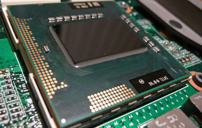

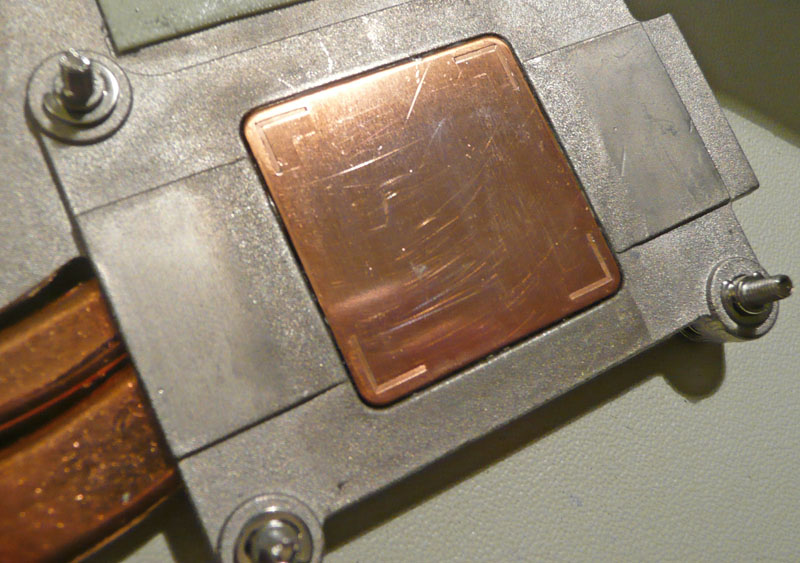

When I applied the volt mod for my last CPU benching session I had to remove the CPU heatsink, so I've seen how well my ICD24 pasting job was. I added a picture to my result post (here, at the end).

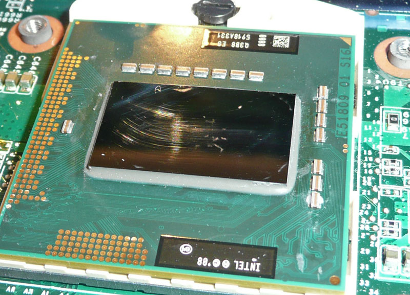

I cleaned of the paste and examined the die. The thermal compound did definitely leave scratches on the die, I guess they're mainly coming from wiping the paste off. They're very fine, but nevertheless they're there. The die was perfectly polished, absolutely free of scratches before I used ICD for the first time, so that's definitely an issue in my opinion, even though the scratches aren't deep.
It's hard to catch the scratches properly on a photograph, at least with my camera. I should somewhere have some comparison images from before applying ICD as well, I have to search them.
Here's a pic of the die after cleaning off the ICD:

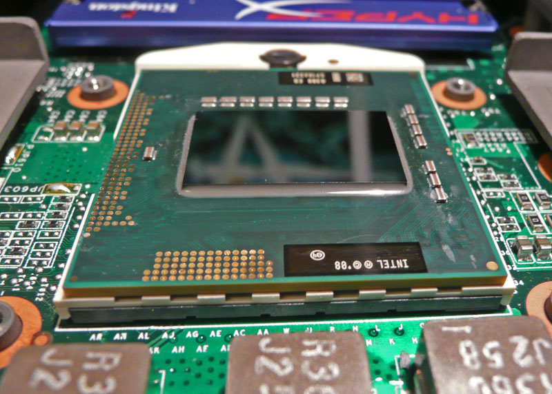

This was before using ICD for the first time:

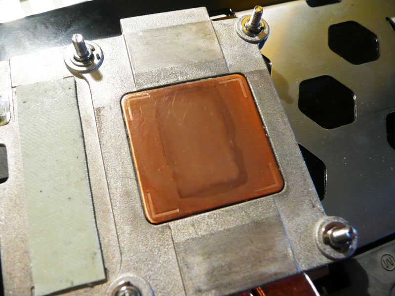

Also I noticed a quite clear discoloration of the heatsink, though this doesn't bug me as much as the scratches on the die.
And before applying ICD:
Edited by svl7
Added pics of CPU and CPU heatsink before using ICD
I added some pics of the CPU and CPU heatsink which I took just before applying ICD for the first time. I think the problem is mainly wiping off the paste when reapplying it, it's hard to make a proper photo of the scratches, but they're definitely there and can be seen easily by eye.
The discoloration on the heatsink before and after using ICD is clearly visible, though this doesn't really bother me.
I use a clean cloth and isopropyl alcohol, much cheaper and essentially the same :D I agree that it must be a cleaning issue, since this is the only time the paste gets really moved over the die, as I said the scratches are very small, but still clearly visible. I don't think I could do anything differently while wiping it off.
