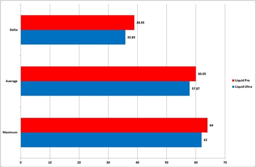

mohsen 17 Posted August 29, 2014 From this chart I think I would go with the Gelid solutions considering the alternatives. IC Diamond is right above it and scratches the die and Coolabratory will solidify if not changed every 3 months and is also potentially conductive. actually Liquid Ultra is better but may whasted one package in a round using... you don't need to change it since 6 months... and of course maybe more expensive from the others. but it costs... compare pics: before liquid ultra: after liquid ultra: Quote Share this post Link to post Share on other sites
mw86 1362 Posted August 29, 2014 Excellent Comparison Mohsen wow what a coverage of products thank you. I tested Liquid Pro and Ultra on an older laptop and got slightly better temp with Liquid Pro. I think I will retest to see if results lean towards Ultra a second time around. Thanks for this, very cool. I applied the Ultra and the Pro with the Brush from the Ultra package and I applied it to both the heatsink and the cpu die, not sure if that made a difference. I tried ultra just applying to the die and got better temps second time around applying to the heatsink as well. I think it says if heatsink surface is lapped well or very even it has less impact or need to apply to both surfaces as the die in that case would be well enough. From what I read that is true that even if the metal solidified it is until removed still in the same perfect contact using the Liquid metal even months later. Says unless you need tp change out the hardware there really is no need to reapply Liquid Metal once in use. Quote Share this post Link to post Share on other sites
Khenglish 1155 Posted August 29, 2014 The problem with liquid pro is the q-tip leaving strands behind on the die. Spread it with plastic wrap on your finger and it's slightly better than ultra. 2 Quote Share this post Link to post Share on other sites
