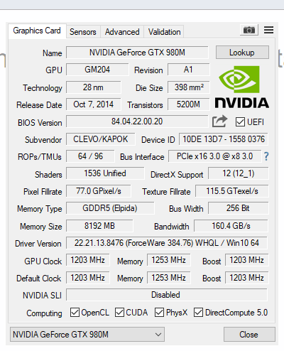

T|I Semi Advanced

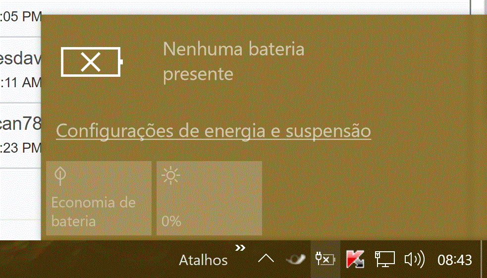

  1. IT FKING WORKED!!!!! JESUS I found a solution like this but did not work i think i put in the wrong place.... Anyways thanks a lot man!!!! FOR REAL!! Now i'm trying to figure out why the FN controls do not work and when i put in 0% the screen goes all black and if there's something to block me doing this!!
  2. Tried everything, changed the vbios of the CARD changed to an old driver... nothing seems to be working:
  3. Tried everything, uninstall reinstall using DDU removed generic pnp monior reinstall the hotkey but nothing is working :/ this is horrible cause i like the brightness in 75%
