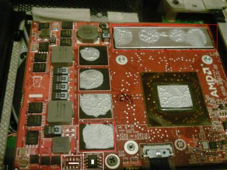

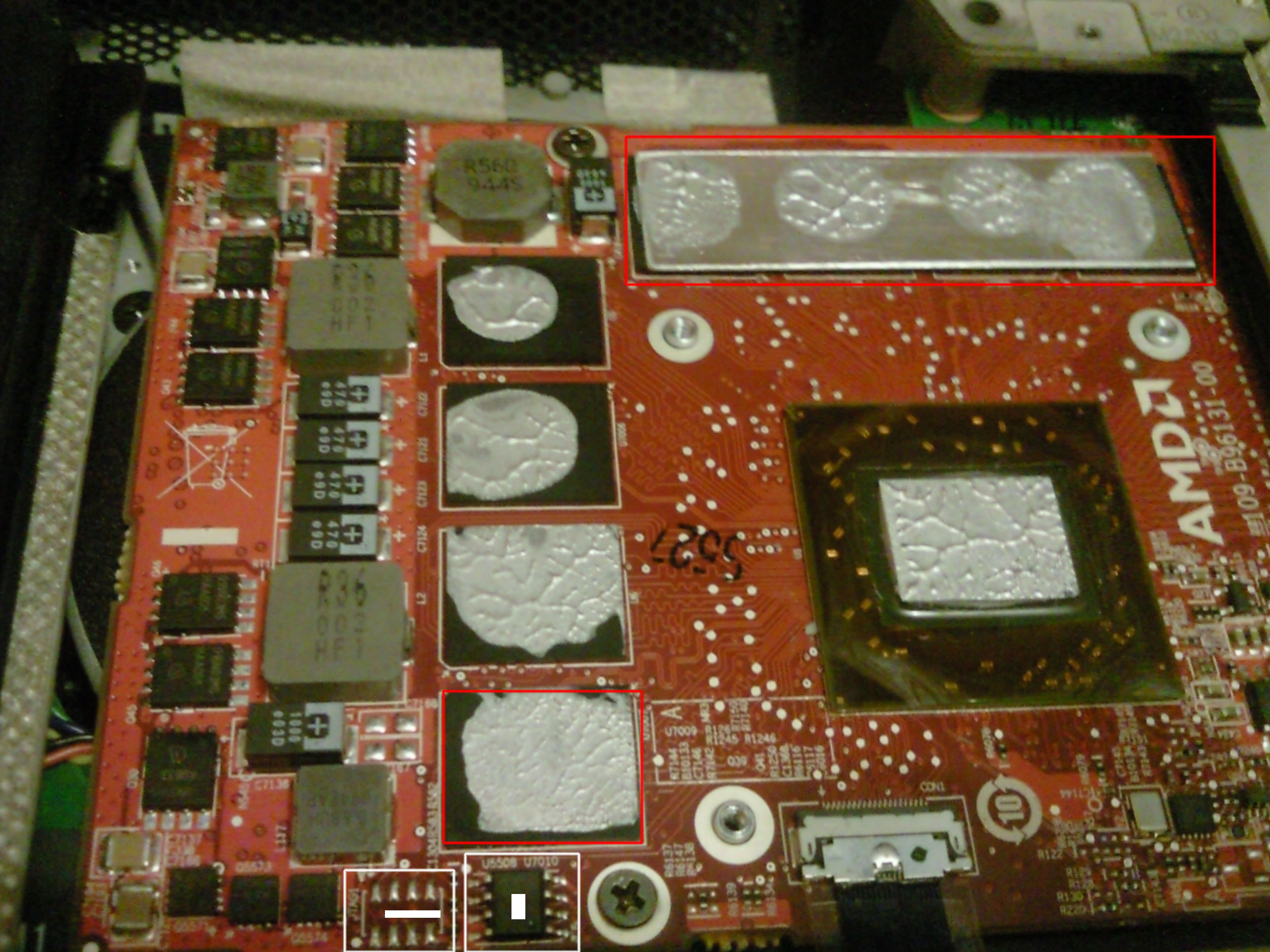

I took a closer look on the PCB of the 6970m, and it seems that I found the eeprom chip in which the vbios gets stored. I'd be able to desolder it and reprogram it per SPI, but I don't have the equipment (programmer, adapter, software...).
Maybe in the student electronic lab at the university... but I somehow doubt it.
I just found the datasheet of the eeprom chip used on the GPU... maybe there's a possibility to bypass the GPU during POST, then I could try and see whether a blind flash works, but I'm not sure whether I should try it, I don't really want to finish off the card (or system) lol. :D

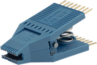

There's no need to desolder it, if I have the programmer I should be able to flash the vbios on it by using such a clip (a version with only 8 contacts):
That would be a really neat solution. It's not very difficult to desolder the chip, it's one of the biggest on the board, but this method would be neat.
Would be great if I were able to do this at home, then I could do some more experiments without having to worry that I may brick the card with a bad vbios.

These are two very good thoughts. About the eeprom chips on the GPU board, no, there's only one, and no free solder joint for another one.
