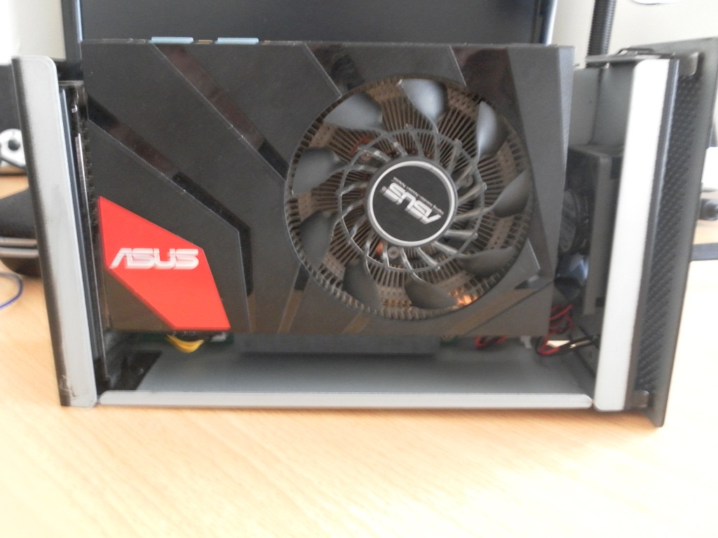

Quinalha 0 Posted January 10, 2016 14 hours ago, Dschijn said: @Quinalha 1. Yes 2. Using two Molex plugs is (imho) safer because you spread the load across this two plugs. Worst case the system might use up to 90W on that barrel plug and one molex plug brings a safty risk. Every graphics card has nowadays an adapter from 2xmolex -> 1x6-pin PCIe which is rated for loads of up to 75W. You should also notice, that the Gigabyte card is too wide for the AKiTiO to be closed. Thanks Dschijn. The problem to close the akitio is the GPU cooler or 8 pin connector? I can use without closing the akitio? Quote Share this post Link to post Share on other sites
Dschijn 329 Posted January 10, 2016 6 minutes ago, Quinalha said: Thanks Dschijn. The problem to close the akitio is the GPU cooler or 8 pin connector? I can use without closing the akitio? Of course you can run the AKiTiO openly… Please read my basic guide, since I made an example here why even short cards might not fit into the AKiTiO (the PCB is just too wide): https://www.techinferno.com/index.php?/forums/topic/7832-the-basic-egpu-hardware-guide-for-macs/ Quote Share this post Link to post Share on other sites
Quinalha 0 Posted January 10, 2016 20 minutes ago, Dschijn said: Of course you can run the AKiTiO openly… Please read my basic guide, since I made an example here why even short cards might not fit into the AKiTiO (the PCB is just too wide): https://www.techinferno.com/index.php?/forums/topic/7832-the-basic-egpu-hardware-guide-for-macs/ Thanks again. I will read carefully. Quote Share this post Link to post Share on other sites

sunghopk 10 Posted January 13, 2016 Hi, Can I use MSI GTX 980TI GAMING 6G for Akitio Thunder2? I already bend T2's enclosure. However, MSI's Gaming 6G has a backplate, which might causes an interruption with T2's Thunderbolt PCB. Can I fit in a graphic card with a backplate? Thanks Quote Share this post Link to post Share on other sites

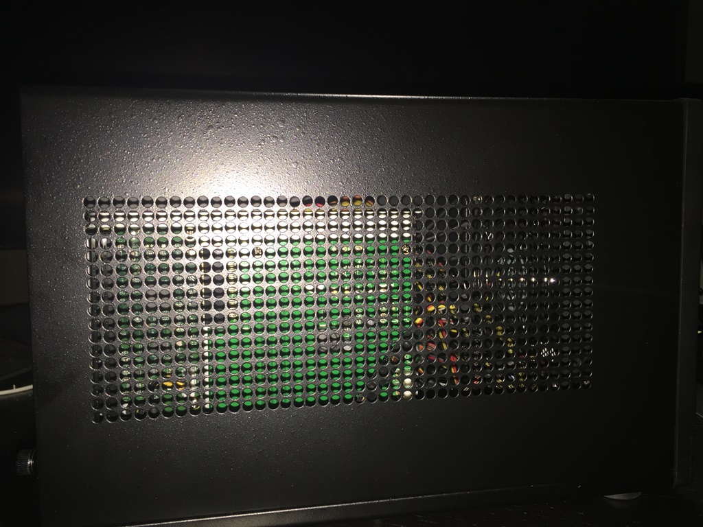

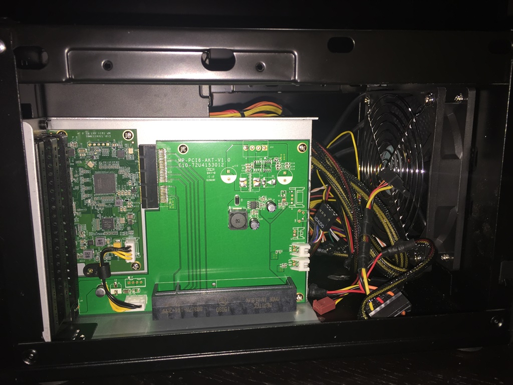

illconn 12 Posted January 14, 2016 This is a new and unused enclosure i have been putting togther while i wait for the TB3 to TB2 adapter to be released. However in the time i have been waiting I have decided i want to go with a Sonnet III D or maybe even just the Echo Express II. I need the PCI interfaces, and although im not sure I am hoping that being that my XPS has a bunch of other Bios settings in regards to Thunderbolt that I wont have many issues with the Riser board in these enclosures. The parts used are all new, and I do have the boxes but would like to ship in the case box which is protected. Parts: Thunderbolt: Akitio Thunder 2 board Case: Silverstone SG05 Lite PSU: Silverstone SFX 300W USB Hub: J5 Create Slim Hub Have done most of the work, and the slot fits my Gigabyte GXT 970, but I know it will fit an Asus 970 itx, and it will fit some slightly longer cards as well. I can get exact max length of card if needed. The max length of SG05 is: 10", and can fit a longer card with some cutting at the front since the cover takes up about 1" so around 11" card max with some more modding. Take into consideration that I have retro the Akitio frame in for strength, and the mount for the card takes up about 1/4" to 3/8 of an inch from the total length. The empty space was meant to be used for the Hard drives which i was going to Raid 1, wifi adapter, and water cooling for the GPU i was going to setup inside. Looking to get : $ 375 + Shipping(insured) Please let me know if this is not the right place to put this ad, as i could not find a classifieds section. Thank you, Rich. 1 Quote Share this post Link to post Share on other sites
illconn 12 Posted January 14, 2016 If no one wants the case, then I guess I will continue as planned, and wait for TB3 to release a dock to upgrade my board. Akitio state that they will NOT release an upgrade board, and instead an upgrade will only be avail by purchasing the New Thunder 3 enclosure which of course would not disclose release time frame lol. Quote Share this post Link to post Share on other sites

iddinmx 1 Posted January 20, 2016 On 1/18/2016 at 5:24 AM, LeoTP said: hey martinm0, I had the same problem, after the Update to OSX 10.11.2 and Nvidia Web driver 346.03.04f02 (I had to rerun the automate-egpu script) my 4k screen is now full supported. (In Display Menu and the OSX system settings) My Setup is: KFA2 GTX-960 Akitio Thunder2 Dell DA-2 PSU MacBookPro Mid 2014 Acer CB280HK Sorry this will is kinda off topic. Would like to know whether does the KFA2 GTX 960 OC able ur akitio thunder2 to close it enclosure fully? Thanks! Quote Share this post Link to post Share on other sites
LeoTP 2 Posted January 20, 2016 hey iddinmx, this card KFA² GeForce GTX 960 Gamer OC Mini Black, 4GB GDDR5, DVI, HDMI, 3x DisplayPort (96NQH8DHD8Z4) does fit into the Akitio Thunder with the Akitio fan. There are about 2mm left. But I exchanged the fan because its to noisy. Quote Share this post Link to post Share on other sites
iddinmx 1 Posted January 21, 2016 (edited) 7 hours ago, LeoTP said: hey iddinmx, this card KFA² GeForce GTX 960 Gamer OC Mini Black, 4GB GDDR5, DVI, HDMI, 3x DisplayPort (96NQH8DHD8Z4) does fit into the Akitio Thunder with the Akitio fan. There are about 2mm left. But I exchanged the fan because its to noisy. Are you able to slide the outer cover and close completely or you are not able to close like in the post below :- On 5/7/2015 at 11:37 AM, Tech Inferno Fan said: If you are referring to the Gigabyte mini ITX GTX970, yes, it fits into the chassis however it's too tall to allow the cover to slider over. It's W=43, L=183, H=129 mm(include bracket) Here's the slightly smaller ASUS mini ITX GTX970 (W=41, L=171, H=122mm) which again fits the chassis, but is too tall to allow the outer cover to slider over it. Card needs to be the standard height (4.376" - 111.15mm) to allow the AKiTiO cover to fit. The other twin-fan GTX970 cards by Galax, Zotac, ELSA, Leadertek, Inno3D listed on http://forum.techinferno.com/enclosures-adapters/7205-us%24189-akitio-thunder2-pcie-box-16gbps-tb2.html would allow this clearance but note their width and whether the fan shroud would need to be removed to fit the chassis. Since it has been highlighted in the post that the height of the GPU must be below 111.15mm to fit in completely inside the akitio including sliding over the outer cover. Standard Graphics Card Dimensions for KFA2 GTX 960 OC Length 193 mm Height 124.3 mm Width 41.5 mm Standard Graphics Card Dimensions for KFA2 GTX 970 OC Length 79 mm1 Height 111.2 mm Width 38.6 mm I am sure that both GPU will fit inside the Akitio Thunder2 without removing the front Akitio fan. But my concern is does the KFA2 GTX 960 OC fit inside the akitio with outer cover slide over the akitio? Thanks in advance and sorry TO for off-topic replies! Edited January 21, 2016 by iddinmx Picture doesnt show up Quote Share this post Link to post Share on other sites
Tech Inferno Fan 20 Posted January 21, 2016 37 minutes ago, iddinmx said: Are you able to slide the outer cover and close completely or you are not able to close like in the post below :- Since it has been highlighted in the post that the height of the GPU must be below 111.15mm to fit in completely inside the akitio including sliding over the outer cover. Standard Graphics Card Dimensions for KFA2 GTX 960 OC Length 193 mm Height 124.3 mm Width 41.5 mm Standard Graphics Card Dimensions for KFA2 GTX 970 OC Length 79 mm1 Height 111.2 mm Width 38.6 mm I am sure that both GPU will fit inside the Akitio Thunder2 without removing the front Akitio fan. But my concern is does the KFA2 GTX 960 OC fit inside the akitio with outer cover slide over the akitio? Thanks in advance and sorry TO for off-topic replies! KFA2 GTX960 OC is too tall for the AKiTIO enclosure to close over it. Look for a card under 112mm tall. Otherwise can use the KFA2 GTX960 OC but with the AKiTiO outer shell removed. Quote Share this post Link to post Share on other sites
