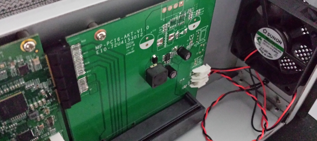

Just received the Thunder2 PCIe Box.
Unfortunately, I am still waiting for my EVGA GTX 750 Ti SC and 12V/10A power adapter to arrive before I can start testing.
[ATTACH=CONFIG]12043[/ATTACH]
At-least I got to see the innards in more detail. Can you also remove the front grill? I want to see if I can use inside my case OR I require a 16x riser/extender. Can you provide more pics from different angles?
Also, how long before you get the GPU? :)

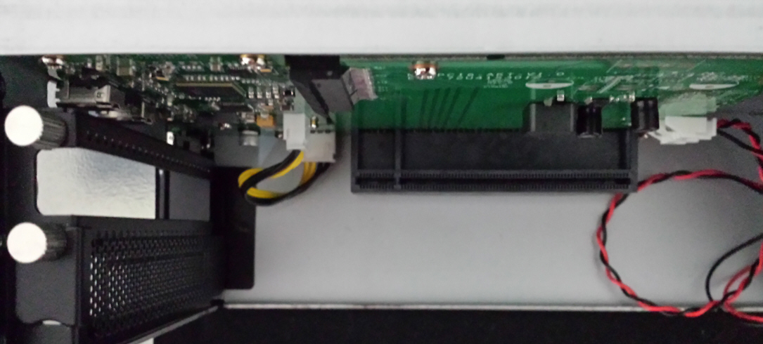

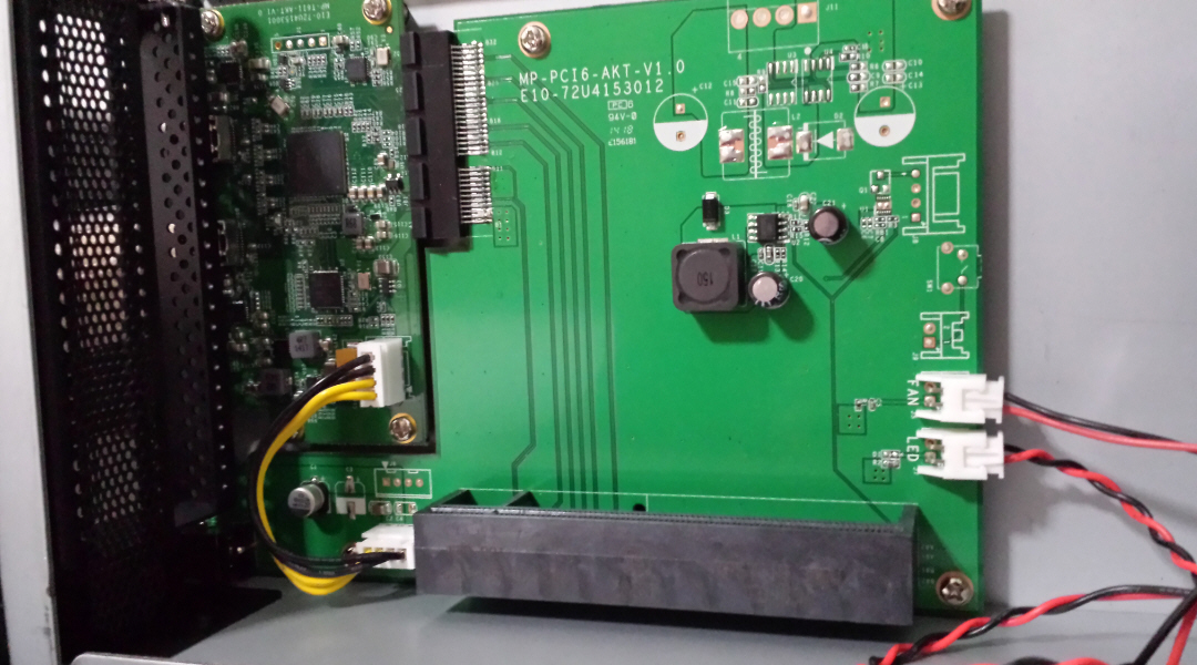

Here you go.
Don't think the front grill can be removed.
About 5 to 7 days more before I get hold of the GPU.
Here you go.
[ATTACH=CONFIG]12044[/ATTACH]
[ATTACH=CONFIG]12045[/ATTACH]
Thanks, it confirms that I need a 16x PCI-e Riser :)
Also, did you get this from Amazon OR B&H? Amazon have increased their price to 270$ :o

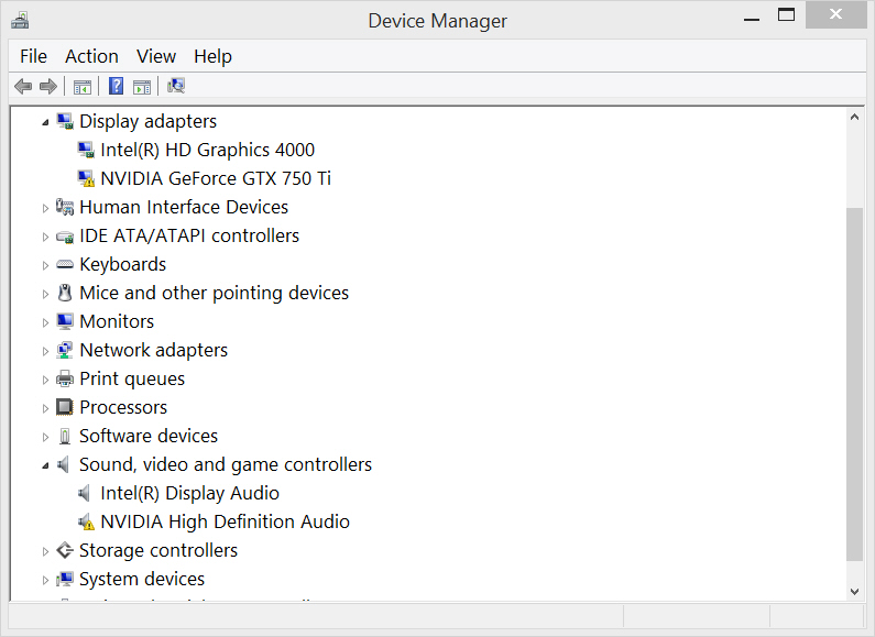

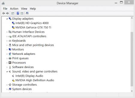

I received the 750 Ti yesterday. Installed it into the Thunder2 PCIe Box and connected it to my Intel Thunderbolt NUC with Win 8.1/EFI (it is the only Thunderbolt system that I have at the moment).
The card is detected by Win 8.1 and I can install the Nvidia graphics drivers. However, the NUC hangs after a reboot. Unplugging the Thunder2 PCIe Box allows the NUC to boot normally.
Uninstalling the graphics drivers also allows the NUC to boot normally with the Thunder2 PCIe Box attached.
Not sure what the problem is. Will start a new thread, hopefully I can get some advice on how to solve this issue.
gtx750ti power 60w, akitio pcie maximum power 25W, PSU is in need.
True ... you will need a 16x POWERED riser after a PSU
