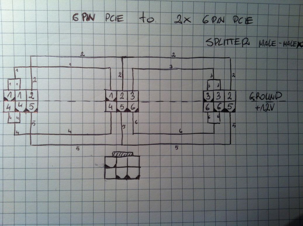

Lol, remember doing this schematic for EXP GDC 6-pin cable once:
Ok basing on Your scheme and knowledge I found over the internet, I create my own version of cable. Splitter Male-2xMale 6pin See Photo. I wish to hook up GTX 660ti.
If You would be so kind and confirm is it good or bad :D I'm not and electronics technician, but it seems You're kind of one:)
The middle one is MAIN
[ATTACH=CONFIG]12664[/ATTACH]
Hi buddy, I'm really sorry for my late reply!
I have to admit I'm a bit hung over atm...
The important part is that you end up with 12V on the lower row and GND on the upper row, do you have a multimeter to check?
I would never test the cable live w/o double/triple check it with multimeter:
1. Check that all lower rows are 12V
2. Check all upper rows are GND
3. Check all GND's are not connected to any 12V (you will get GND connected to GND, that's alright)
Nice job btw!
