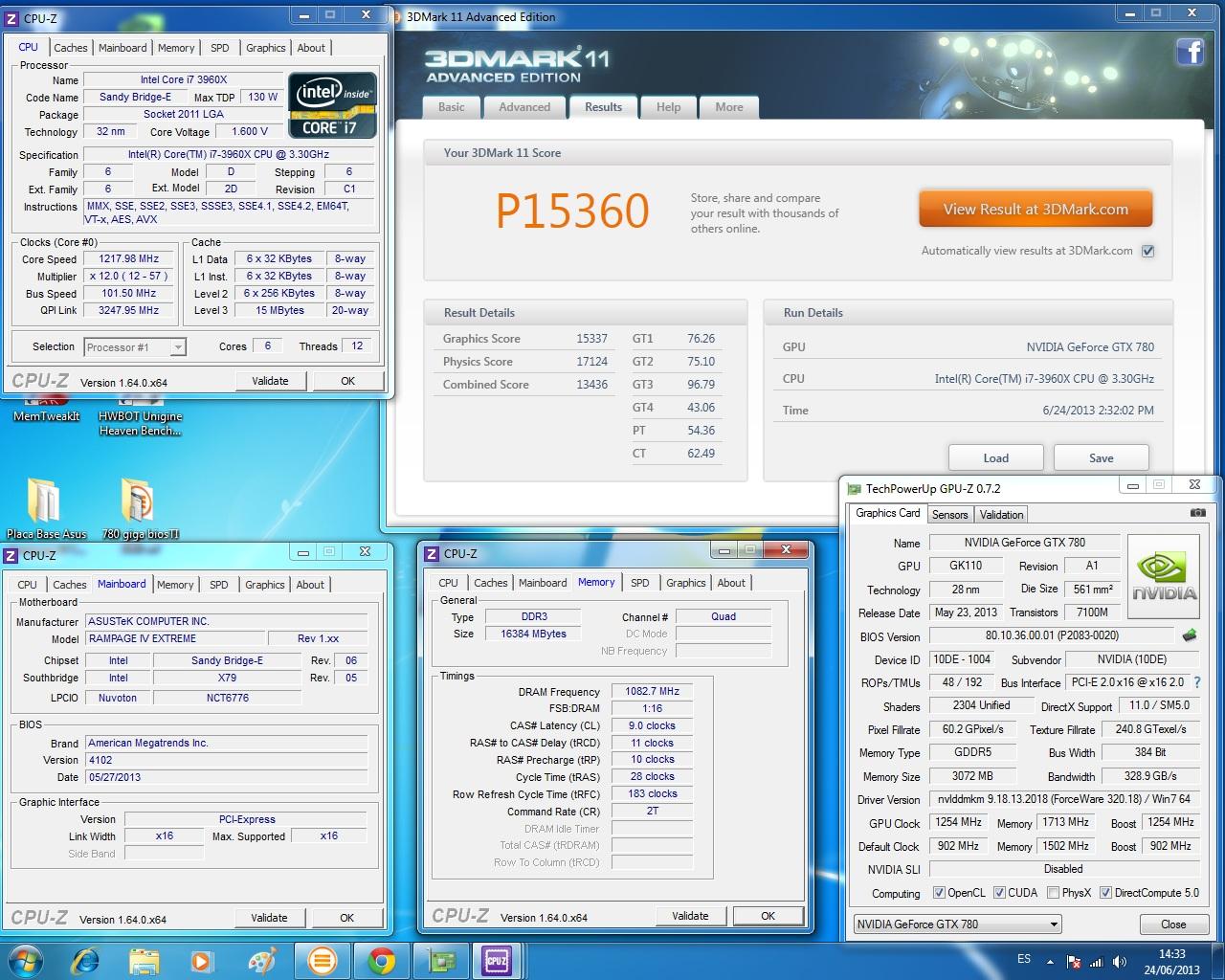

Witch bios ? Gr8 clock, what's you ASIC ? And you have to get better numbers for those clocks, I've got ~15400 GPU with 1215mhz core. Edit: Inspecting your result further, you must be throttled or instable in some kind, your GT4 is way lower than it should be with those clocks near 45 area, not 43
This bios:
Nvidia GTX 780 - 80.10.36.00.01 - 'OC edition v00'
My Asic is 65.6%
can teach your benchmark? i think my benchmark is very good for one gtx 780
