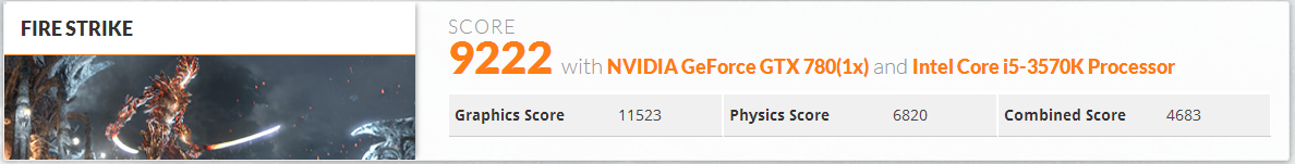

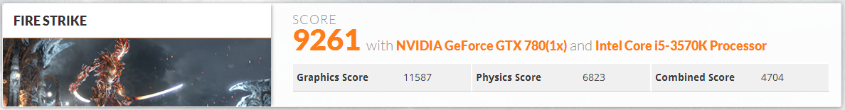

@svl7- As I mentioned on my previews post with very low OC ability, I had a bad flash and I did re-flash my both cards one by one. and i did ran some bench's with great result.
the New SC ACX vbios has maintained great OC ability, cards won't throttling down, It clocks up and down like a normal bios and voltage goes up once the cards needs to push and comes down once the cards don't needs to push. idles at 324MHz @v875 when watch youtube video clocks stay the same
9222 | C- 1241MHz - M-3005MHz vBios EVGA 780 - SC ACX - 80.10.37.00.0B - 'OC edition v00 by svl7
9261 | C- 1254MHz - M-3005MHz vBios EVGA 780 - SC ACX - 80.10.37.00.0B - 'OC edition v00 by svl7
[ATTACH=CONFIG]7775[/ATTACH]
[ATTACH=CONFIG]7776[/ATTACH]

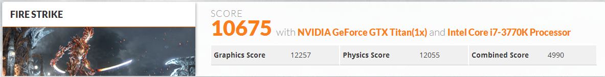

Not bad but it seems even with the GTX 780 at max clocks with an ACX cooler it doesn't beat my much lower clocked Titan (1202/3404): NVIDIA GeForce GTX Titan video card benchmark result - Intel Core i7-3770K Processor,ASUSTeK COMPUTER INC. MAXIMUS V FORMULA score: P10675 3DMarks
Of course I'd trade the slightly lower score for 40-50% off the price :D Damn you NVIDIA...DAAAAMMNN YOU!!
[ATTACH=CONFIG]7777[/ATTACH]
One thing you have to consider is the price, you already known another think you don't know is all the benchs a did was with 3570k stock clocks with intel stock cooler. Right now I'm running a shoebox :) . So my rig is down for complete. So by this weekend I goibg to put my hole back "I wish I can finish it" but at least my acx going under water on hydro's it will be here friday and I'm waiting on my third rad to arrive too. Even if I don't finish my rig my 3570k and my 780's will be under water for some serius bench and by that svl7 will realese another beast bios and I will be right behind you ;)
