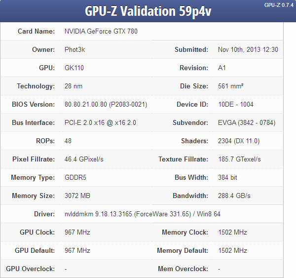

Phot3k Posted November 10, 2013 Share Posted November 10, 2013 Trying to flash your EVGA 780 - SC ACX - 80.10.3A.00.81 - 'OC edition v03' using nvflash in DOS but get a board ID mismatch (something along those lines) even with accepting with yes. Any ideas on the problem? Here is my validation: techPowerUp GPU-Z Validation 59p4v Thanks. Quote Link to comment Share on other sites More sharing options...
svl7 Posted November 10, 2013 Author Share Posted November 10, 2013 Yeah, you seem to have a newer GTX 780 classified, they changed some things... you can use the mod attached in this post.Please let me know if everything's working fine with it.EVGA 780 Classified - 80.80.21.0x.80 - 'OC edition' v03.zip Quote Link to comment Share on other sites More sharing options...

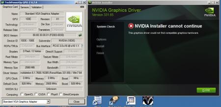

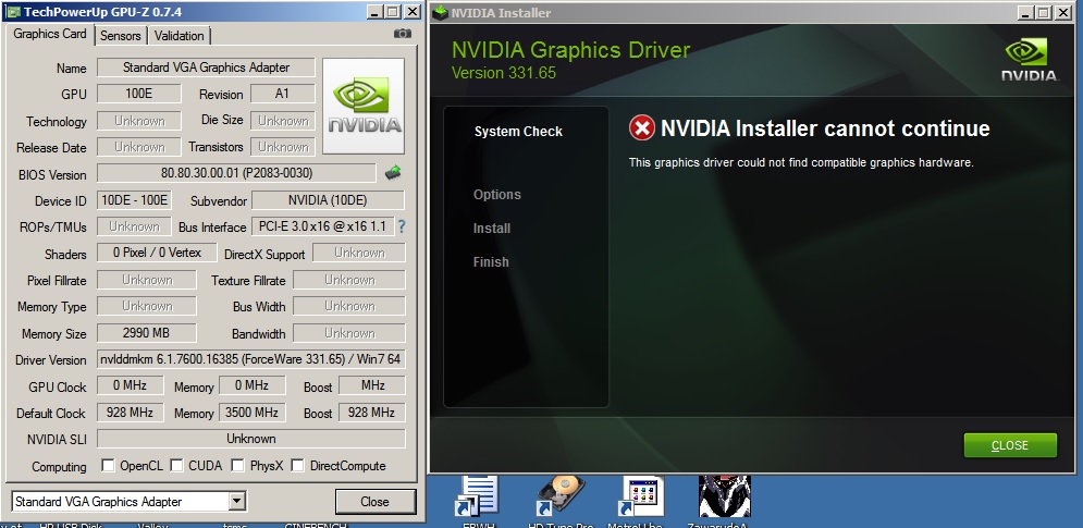

DStealth Posted November 10, 2013 Share Posted November 10, 2013 Thanks will try though , what issues to expect my biggest concern right now is fan speed with all non-ref BIOS it's lower. With TI should be fine I presume... Edit: Flashed it, but cannot install video driver, any help would be appreciated Quote Link to comment Share on other sites More sharing options...
svl7 Posted November 10, 2013 Author Share Posted November 10, 2013 Post a screenshot of your device manager showing the VGA -> details -> hardware IDs. Quote Link to comment Share on other sites More sharing options...
DStealth Posted November 10, 2013 Share Posted November 10, 2013 Post a screenshot of your device manager showing the VGA -> details -> hardware IDs.There's nothing special, also checked, but only a Standard VGA driver is shown and no hardware ID's Quote Link to comment Share on other sites More sharing options...
svl7 Posted November 10, 2013 Author Share Posted November 10, 2013 There are always hardware IDs, exactly where I described. Quote Link to comment Share on other sites More sharing options...
