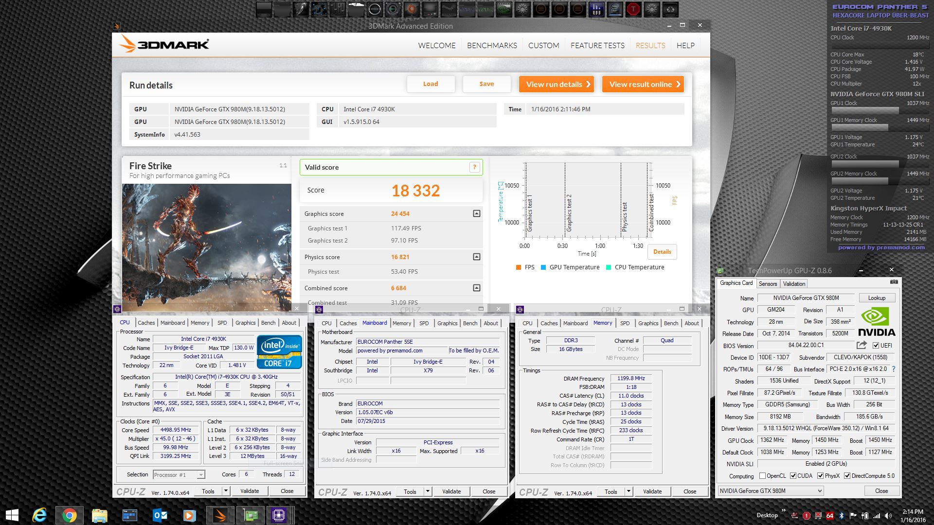

Not as good as @johnksss and @usmc362 are getting, but a personal best in 3DMark 11. This is using a @Prema vBIOS mod.
http://www.3dmark.com/3dm11/10812335
This one is not a personal best, but it completed the run successfully at 1470 | 1450 | 1.200V. Actually, three runs with that voltage, but this was the best of the three.
http://www.3dmark.com/fs/7221027

@Prema - that vBIOS is much better, bro. If I can get that combined score looking a little better should be awesome. That's the only thing allowing the Sky X9 to beat my Panther now. Combined score is way low, but graphics and physics are looking good. Finally broke my personal best Fire Strike score from 6 or 7 months ago.
http://www.3dmark.com/fs/7234823

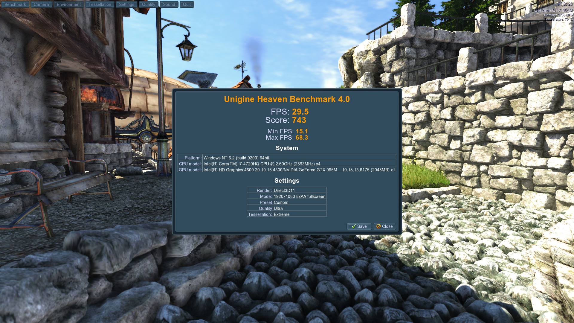

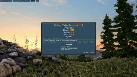

http://www.3dmark.com/3dm11/10841880
http://www.3dmark.com/3dm/10413482
