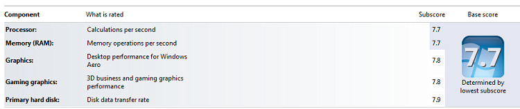

Also did a Windows performance yesterday and really good result :
