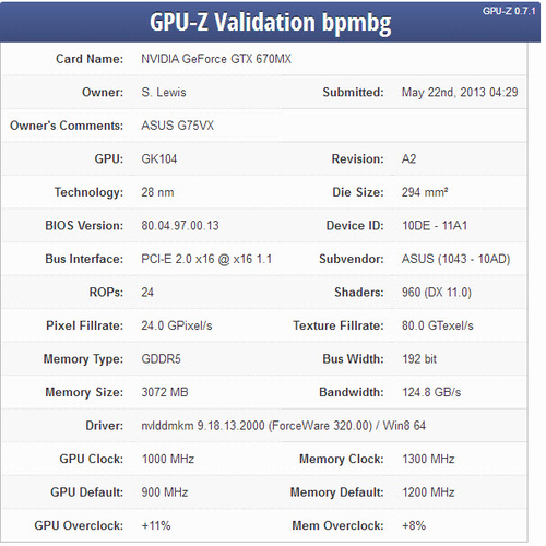

malyousef Posted May 17, 2013 Share Posted May 17, 2013 hilink to my biosrog g75vx32gb ramclocked with prem mod bios and again with htuner's gpu modbut i dunno little changes i made and maybe can be oc correctly cpu, ram and gpu...thanks for prem and htuner and for anyone willing to helpthanks Quote Link to comment Share on other sites More sharing options...
