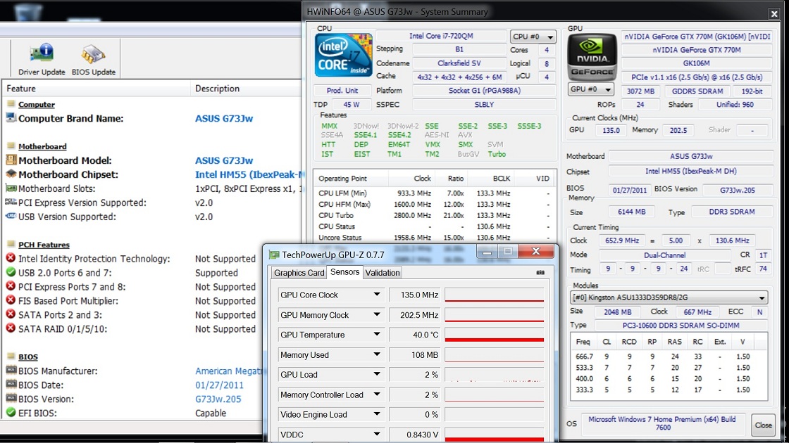

  3. Hello. So it can be confirmed that olding like G73jh can be upgraded to latest of nvidia gtx series. I must confess one thing though when thinking about this machine first thing that comes to mind is zombie Becouse it involves merging 4mb bios file of g73jh with g73jw plus moding video bios to get standard mxm 3.0b gpu be recocgnised by system. All this was neccessary becouse without bios mod there is not support for nvidia gpus in system bios but g73jw has neccessary callbacks and thus is involved in this mod. Even inside bios settings it is shown as g73jw now and all other programs like HWinfo shows it as that. With original unmodded bios there is no backlight on internal lcd before windows log in screen is loaded and both fans are on full throttle constantly. Under is some pictures and link to 3dmark11 score with standard clocks. LINK: NVIDIA GeForce GTX 770M video card benchmark result - Intel Core i7-720QM Processor ,ASUSTeK Computer Inc. G73Jw

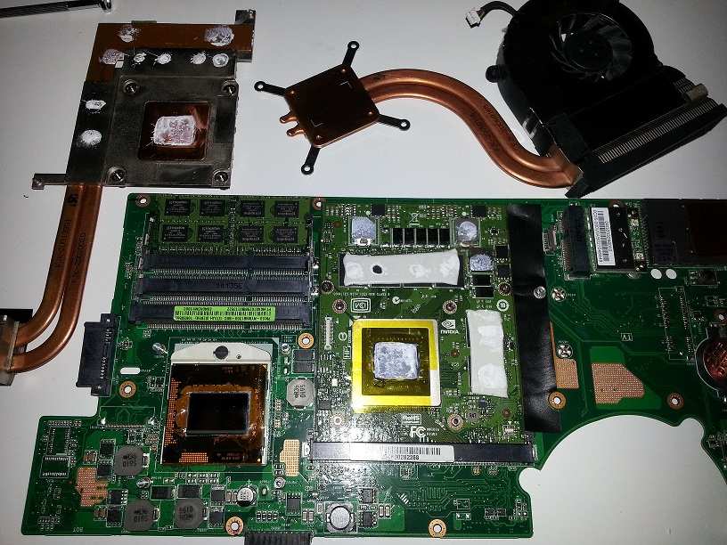

  8. Finally we got it 174 watt from socket and 81c peak temperature

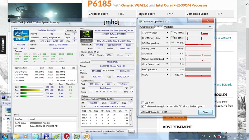

  9. Any updates IshouldGo? I dont know what else you sould try to diagnose motherboard blindly. Wait for new vbios chip so try first with that. If no progress then try with sbios reprograming. On my side, there are small steps forward. Picture on internal screen is working fine everything else also works just fine besides gpu core was limited to max 150mhz. But we managed to overclock it to 300mhz. And 3dmark11 scored total 2996 points with graphics score of 2745 which is clearly better than I couls get with overclocked 460m. Update unlocked core to 640mhz 700mhz memory and runned 3dmark11 benchmak 73 Max temp 154 Max watts from wall

  11. you didnt do anything With 460m vbios? I f not then I am very unsure what could be problem. But I remember you mentioned how you damaged 460m when removing xbracket and had red line across screen after that. It may be that damage got worst after some removing and mounting it. But try and remove gpu from Laptop and leave fans connected to motherboard. Assemble laptop and power it up if it boots with fans on max and you can toggle between caps Lock and see hdd light blinks then motherbard/sbios should be ok.
  12. I finnished my upgrade and internal lcd is working now. Have installed latest beta 320.14 driver i had to modify inf file though. But core does not go above 150mhz even that gpuz reports normal speeds. Nvidia inspector hwinfo and other programs report that core is not going above 150mhz. Even with 150mhz 680m is on pair with 460m. With 460m I got 1829 points on graphics and with 680m 1920 points. If svl7 read this can you share some thoughts please. I use 670mx vbios from asus g75vxit is only one that posts on internal lcd.

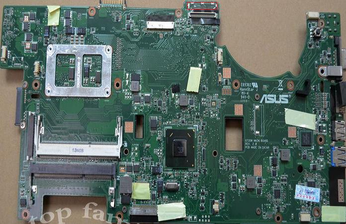

  16. Vbios chip is circled in red. They are usualymarked by some kind of pen from before.

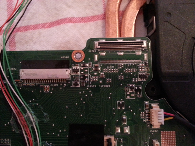

  17. Any updates IshouldGo? I still struggle with this damn fuzzy screen. Checked screen cable and it has 37 wires means duoble channel LVDS cable. Conclusion: I damaged something on motherboard. Hell I am surprised it works at all after so much soldering all over a board . But damn internal lcd works and thats what matters.

  19. Thank you very much ishouldgo. I managed to find 10.1 lcd with lvds single channel and then picture is just fine but on my AUO 1920x1080 every second vertical line is white so with that connector has not same serial number as yours I suspect that mine lcd cable is just single and not dual channel lvds. So every lcd with resolution over 1360x768 is not displayed correctly. I will examine my lcd cable closer now. Thanks again..
  20. I couldnt manage to get picture on internal screen via other connector either. Was lucky and everything works fine after soldering back screen connector on original place. With that I take break for at least one week. Have asembled all back as it was before with good old 460m. To bad that 680m just sitting in my shoes box and dusting . Thanks everyone who have helped me on this road, especialy svl7 that spend his time modding vbios files for me. I still have sbios chip soldered on sop8 socket so if anyone has need for testing something with bios I will help. Good luck IshouldGo with your modding.

  22. Tested it now and seems that screen is discovered but it still remains black. Vga dont output signal before windows welcome message apears. In windows with hwinfo it reads corectly my AUO screen. I even tested with 3 other displays and all are readed correctly. fn+f8 switch correctly to but scrren remains black. Looks like there are some parts around connector that are missing to so it does not get power for led backlight. IshouldGo if you can take picture of your motherboard especialy around screen connector on both sides I would be thankfull.
