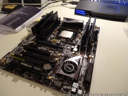

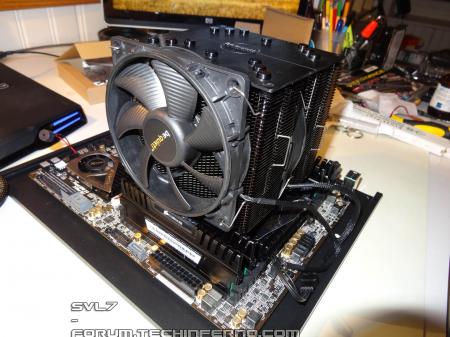

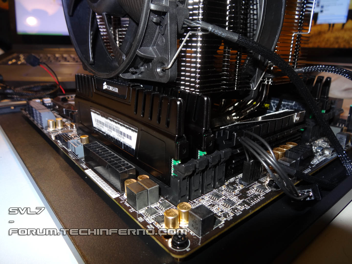

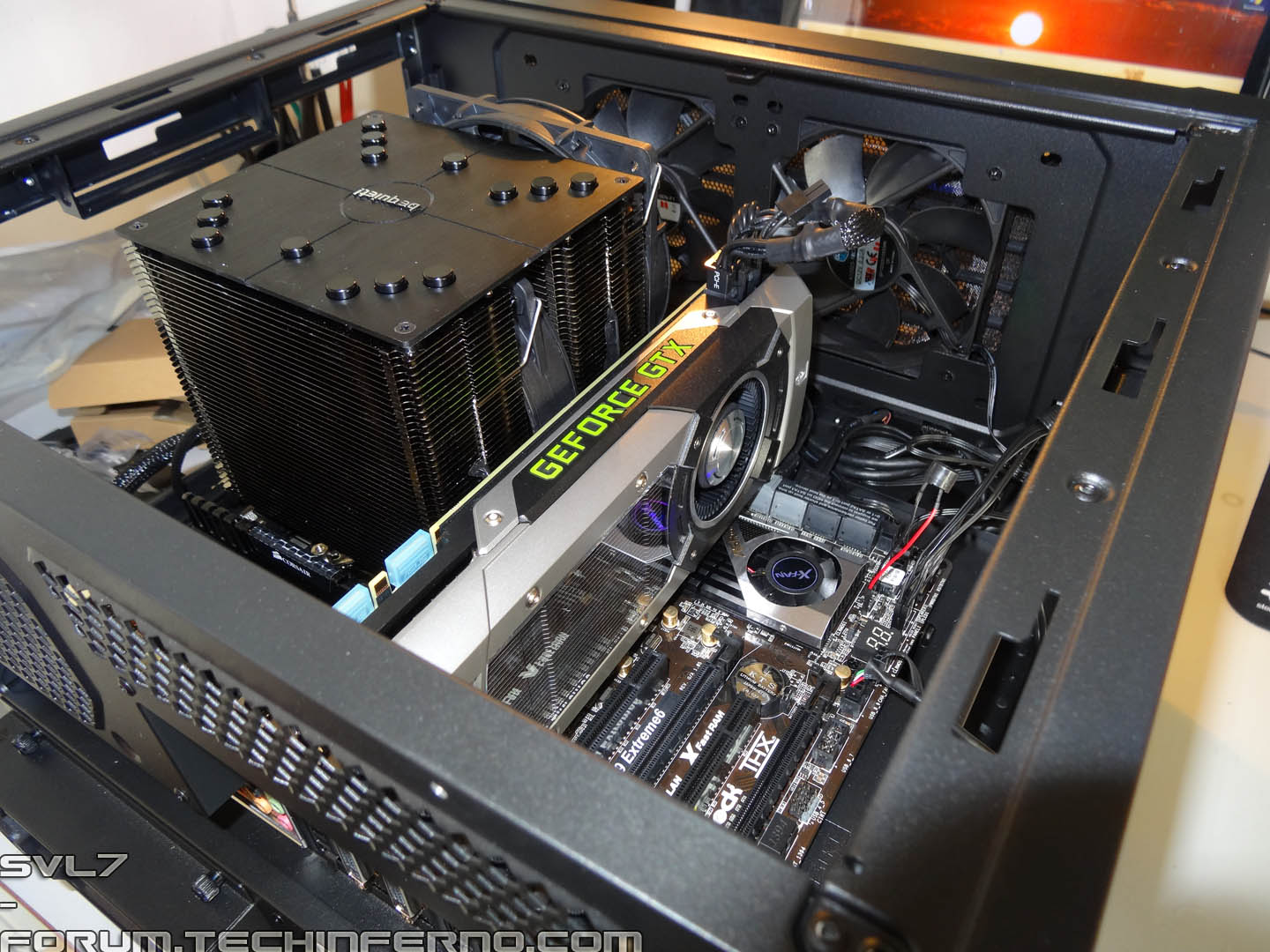

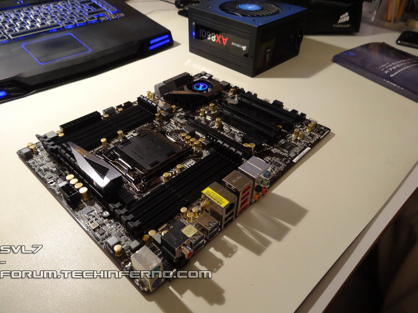

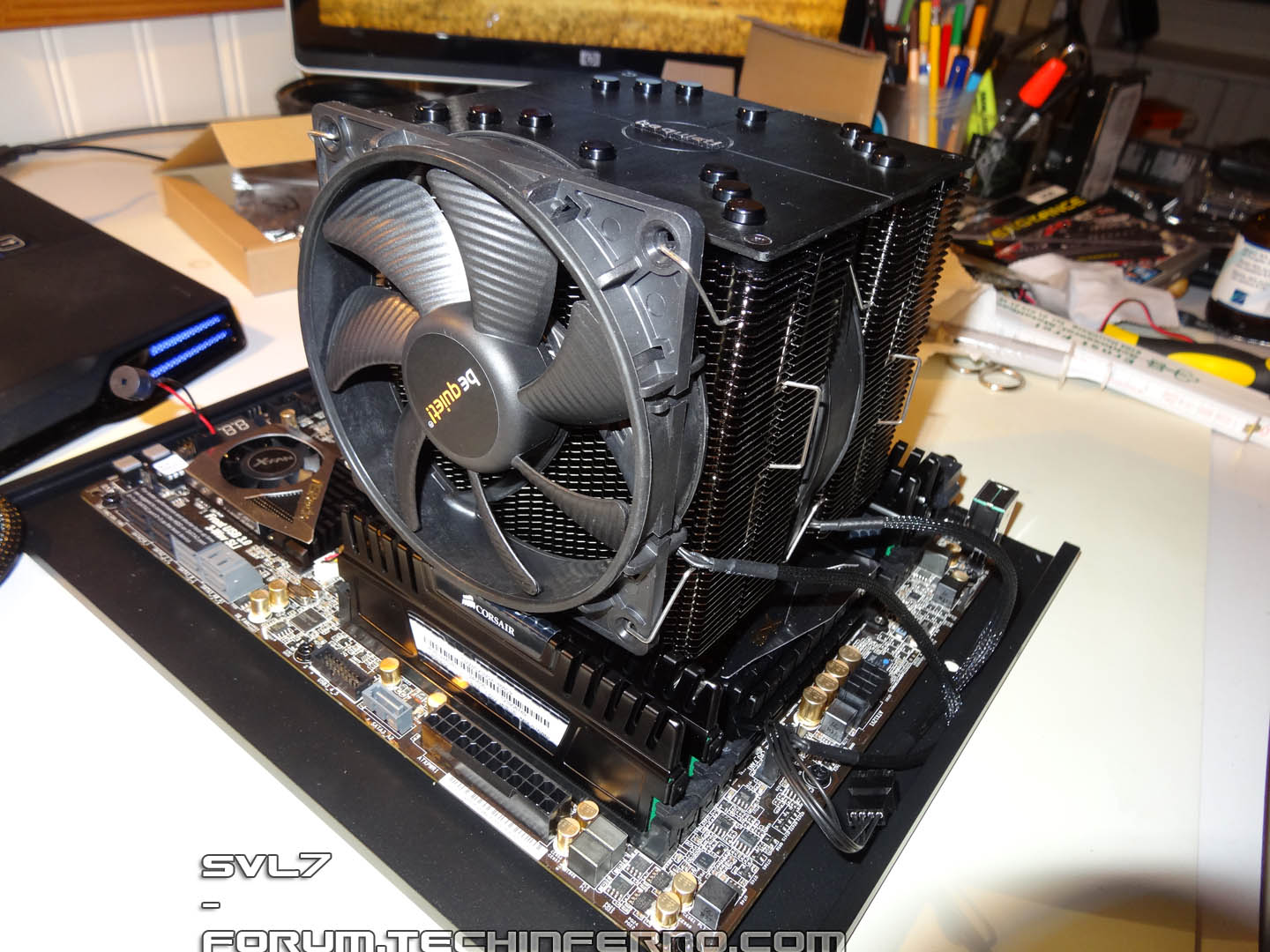

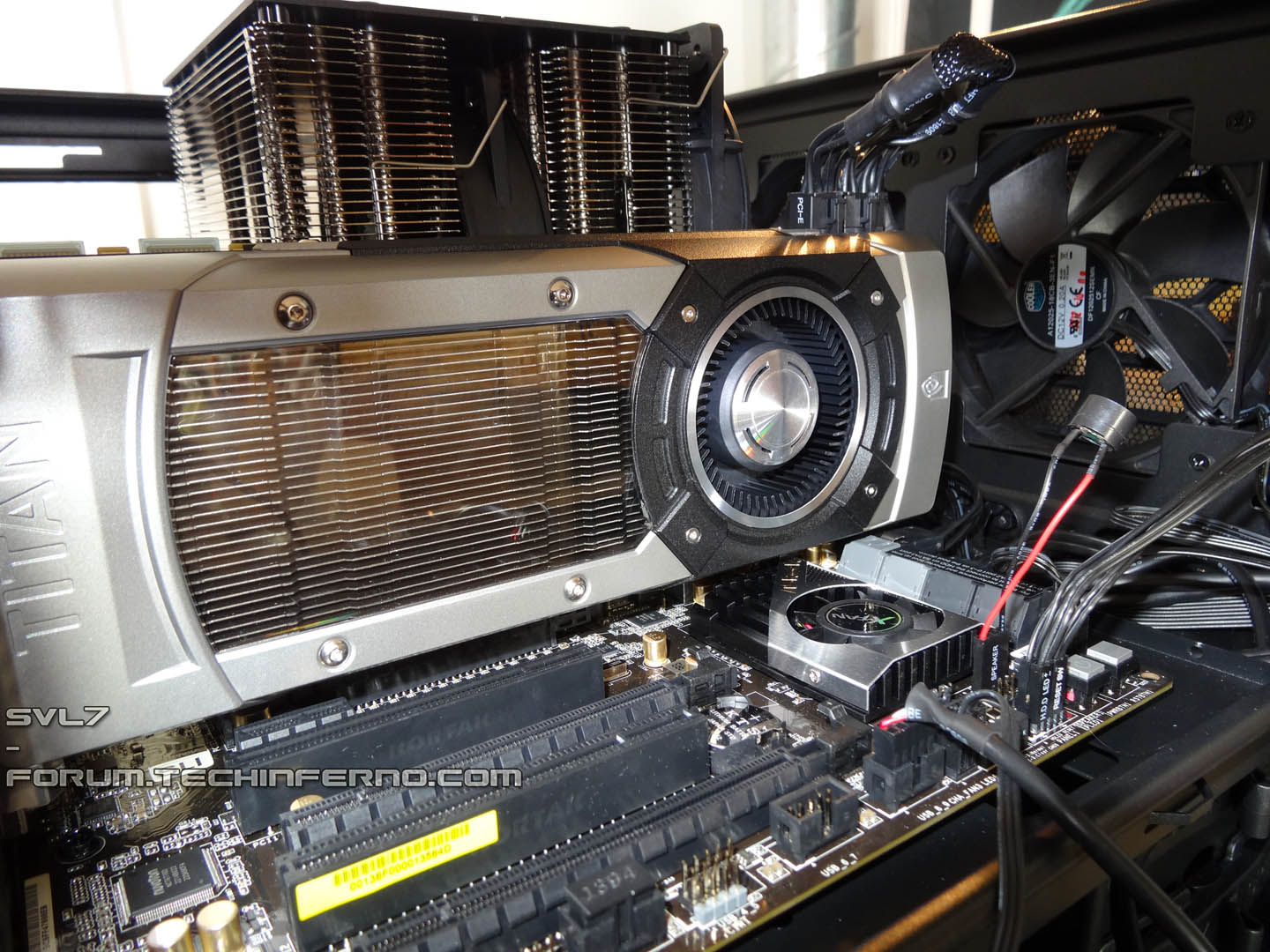

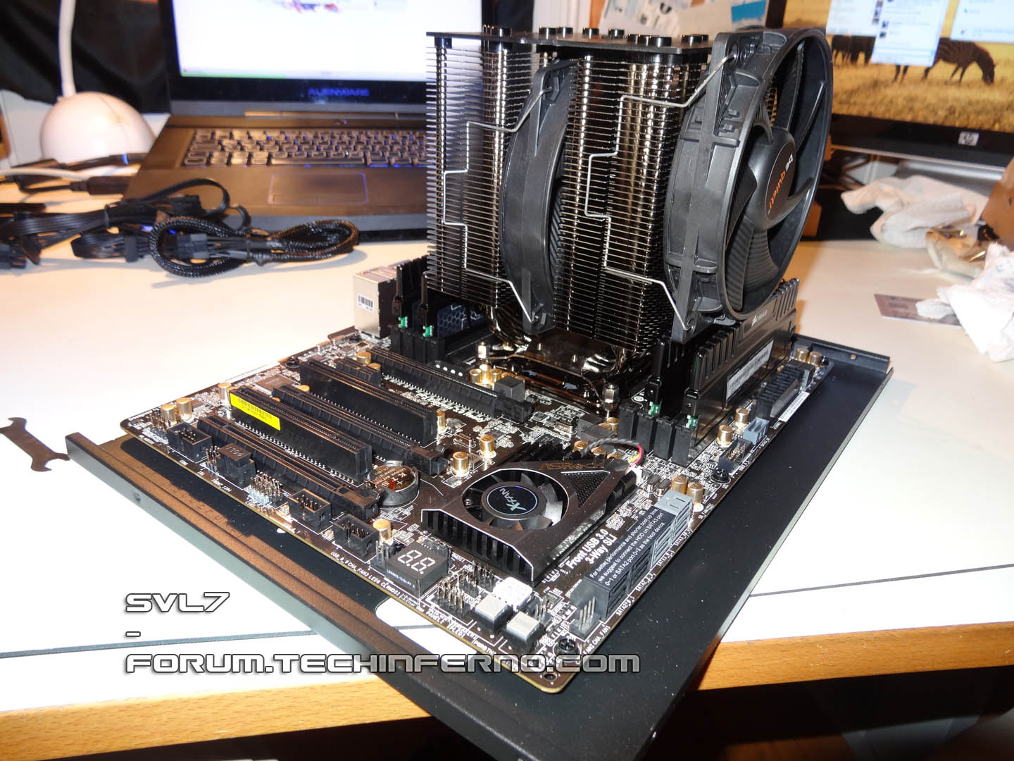

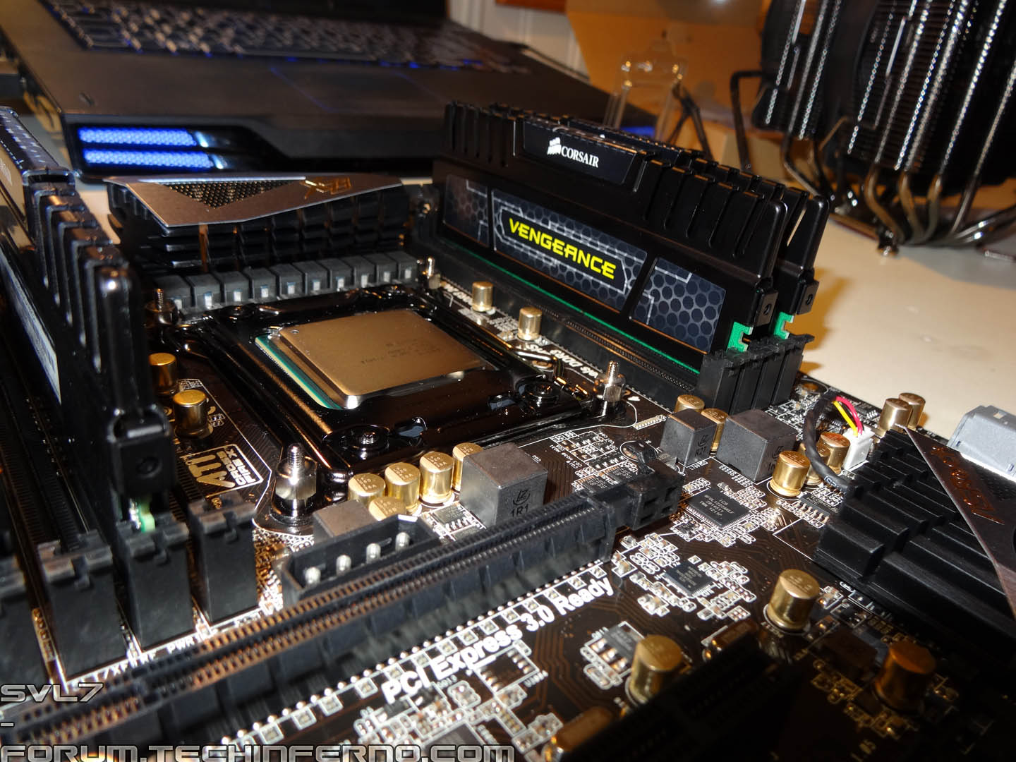

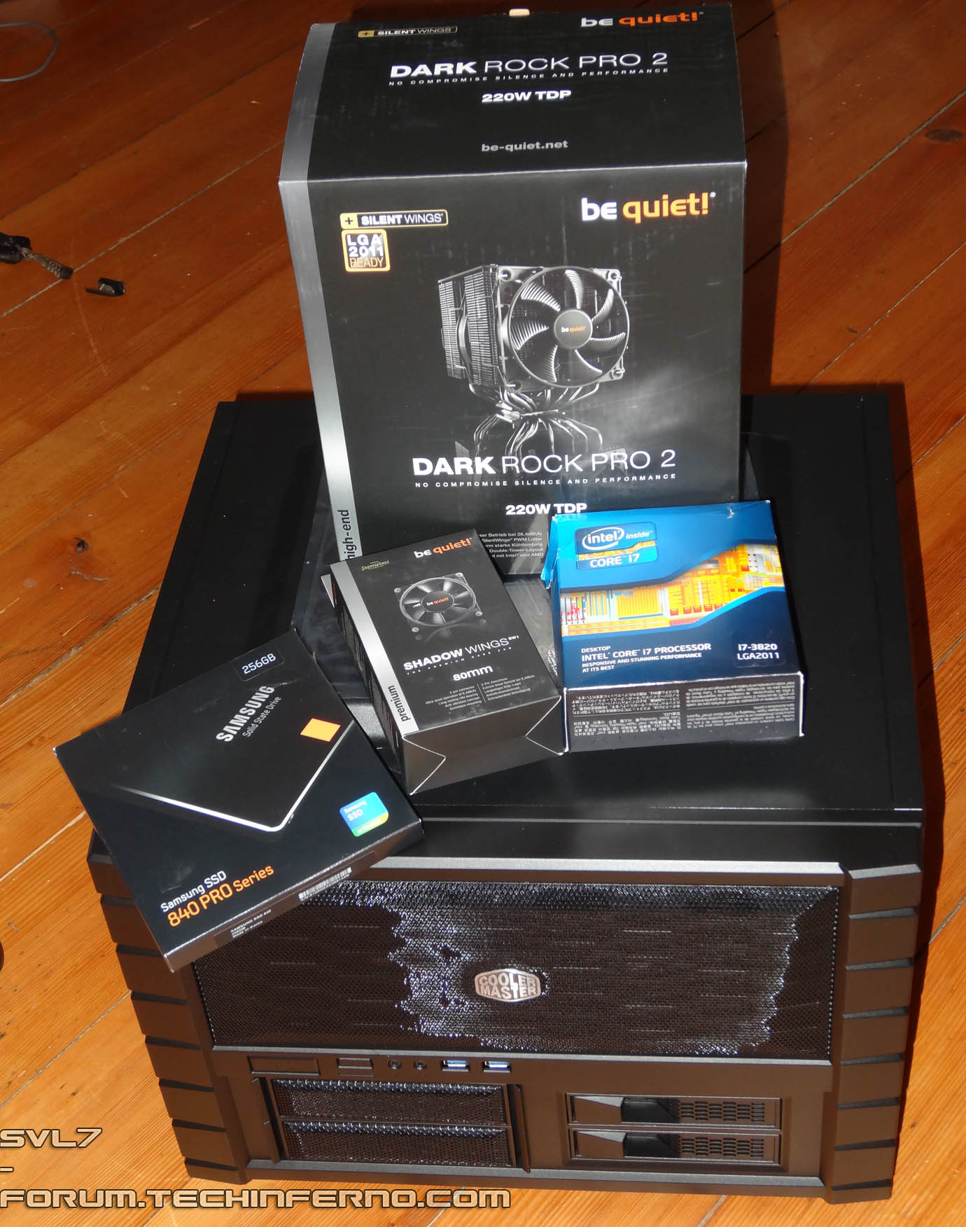

svl7 Posted February 25, 2013 Share Posted February 25, 2013 I ordered some desktop parts... gonna build a rig. Never had a custom desktop, so it should be fun Here's a pic of the parts which already arrived: Still waiting for a new monitor, PSU, motherboard, and... a certain graphics card I´ll update this once I get the rest of the things. ----------------------------------------- So... here's my first ever desktop build Was quite a tight fit with the RAM modules and the CPU heatsink... I didn't think about this, only noticed it when I put the stuff together. The heatsinks of the memory modules are too big, but as I only have four modules it happens to work just ok. Fortunately none of the slots next to the CPU needs to be occupied when only one module per channel is installed. Titan and CPU heatsink is a close fit as well, but it works. Setting up the system now, will see how this will work out... hehe. 7 Quote Link to comment Share on other sites More sharing options...
Founder Michael Posted February 25, 2013 Founder Share Posted February 25, 2013 case looks nice! GL with the build!!! Can't wait to see Titan modded and benched! Quote Link to comment Share on other sites More sharing options...
unreal25 Posted February 25, 2013 Share Posted February 25, 2013 That cooler is giant. Quote Link to comment Share on other sites More sharing options...

Khenglish Posted February 26, 2013 Share Posted February 26, 2013 I ordered some desktop parts... gonna build a rig. Never had a custom desktop, so it should be fun Here's a pic of the parts which already arrived: [ATTACH=CONFIG]6142[/ATTACH] Still waiting for a new monitor, PSU, motherboard, and... a certain graphics card I´ll update this once I get the rest of the things. We have the same exact SSD! We must be twins! Or maybe you stole mine? The 840 Pro is nuts. The windows loading animation is only half done before the desktop comes up. What are you planning on doing to the titan? Are you gonna look into the disabled shader block much? Maybe since it's the top end card it's not laser cut but just a bios thing, but people never enabled the 480's disabled block so who knows. Apparently the VRMs aren't that strong on it, so doing a mod to remove the power limit might not turn out very well. And that CPU cooler is slightly bigger than this laptop's CPU cooler. It looks like you went for low noise fans. That titan's fan will most certainly NOT be low noise when overclocked/overvolted. Interesting CPU choice. I suppose you're planning on getting IVB-E when it comes out? Oh and I hope you meansured everything first to make sure the all your stuff will fit in that case. Quote Link to comment Share on other sites More sharing options...

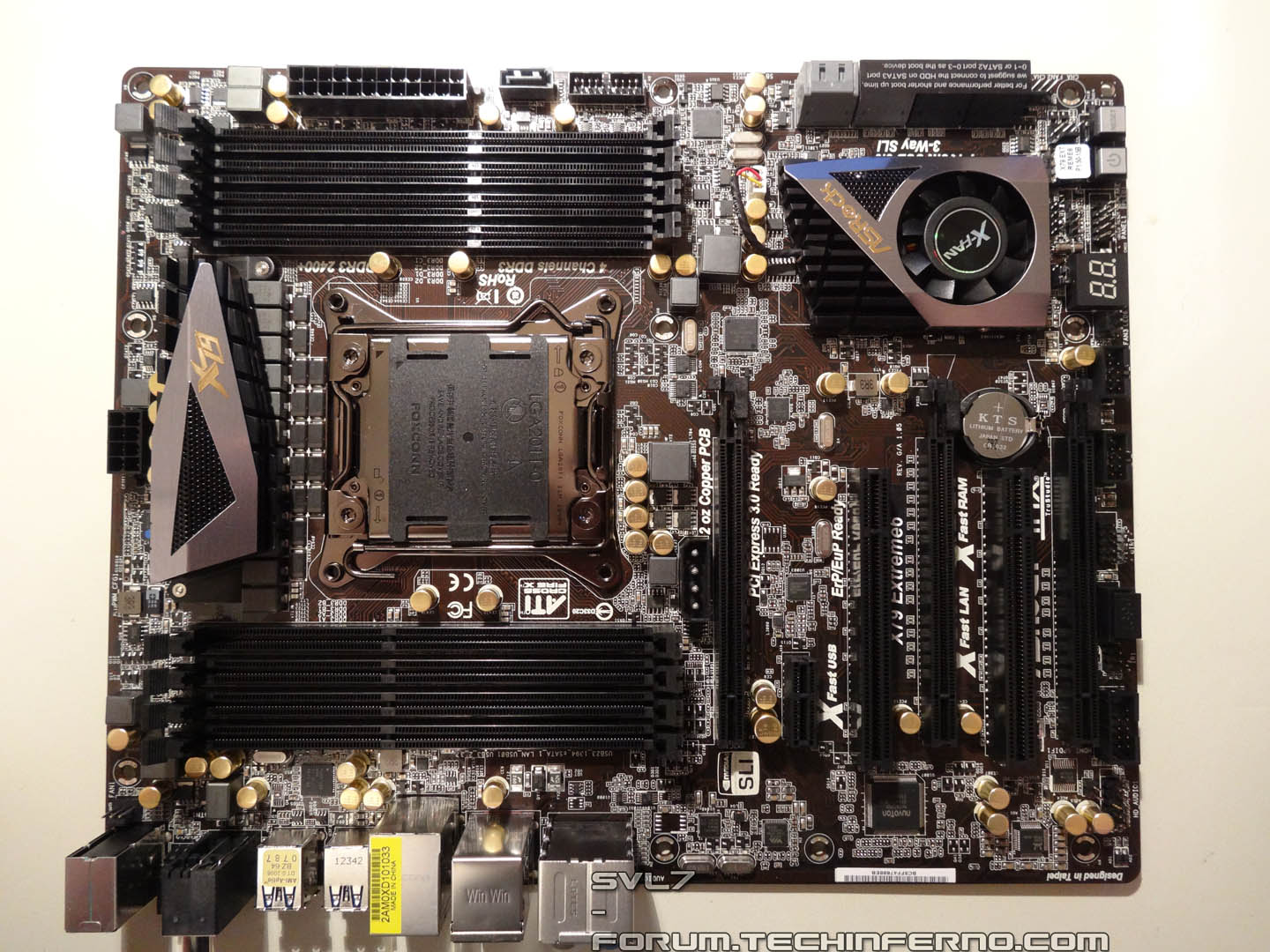

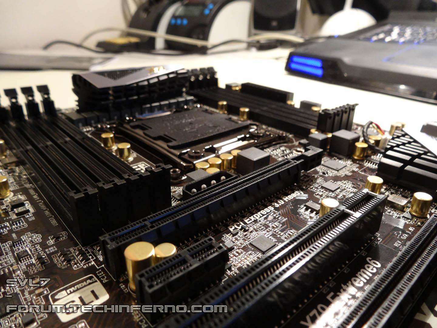

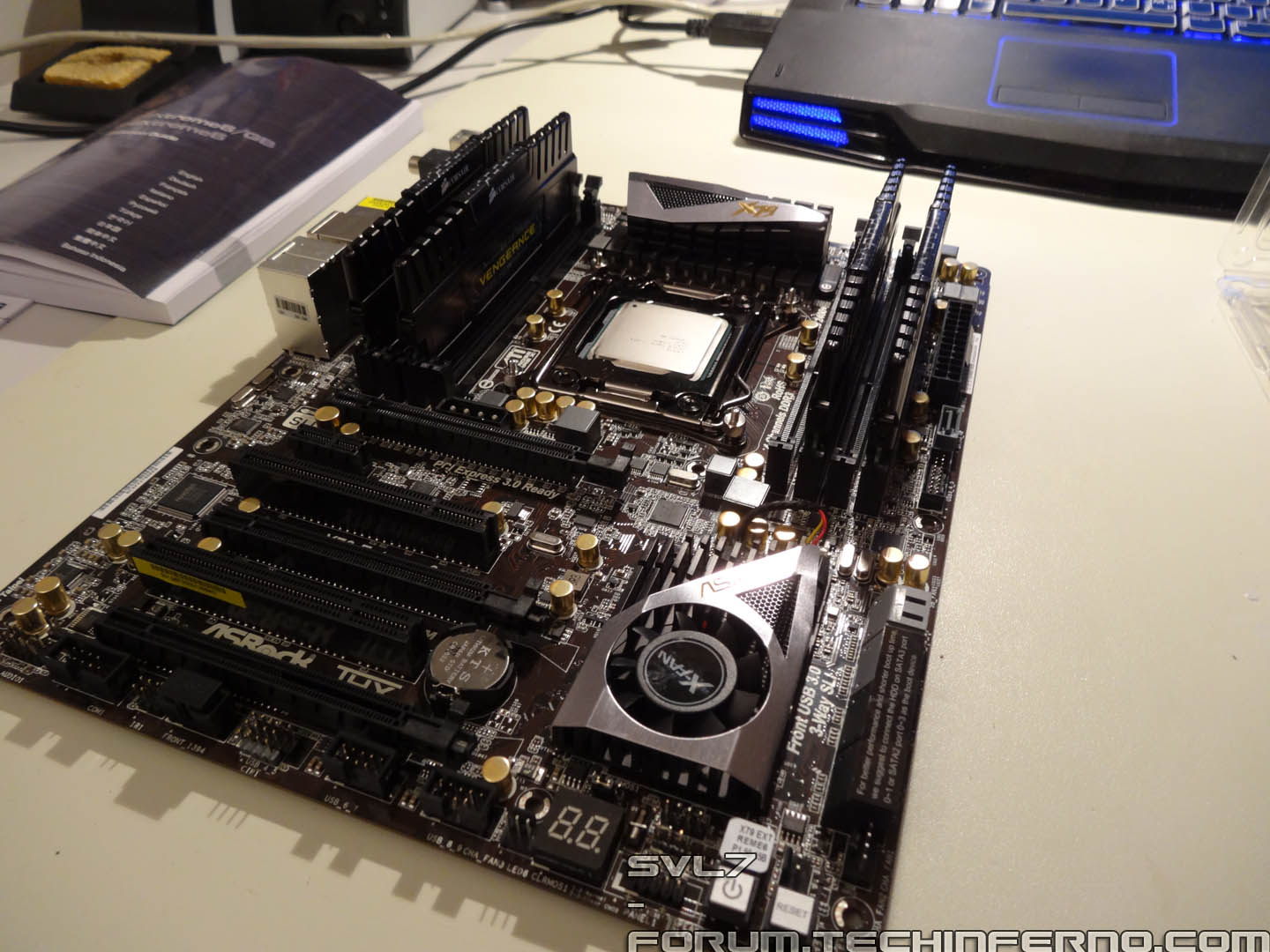

svl7 Posted February 26, 2013 Author Share Posted February 26, 2013 Mobo arrived! Now I need that GPU and the PSU... damn, the website says the PSU is in stock since I ordered it... wth. @Khenglish: Cool, looking forward to seeing that SSD in action I'm certainly going to mess with the vbios, no idea how good the voltage supply circuits are... I guess I'll find out, hahaha. Maybe I'll sell the Titan after messing with it, I guess that would be the most reasonable thing. But the again, since when am I reasonable? I just liked the look of that CPU cooler, maybe I'll go for water cooling one day, but for now that should be fine - and yes, it should fit. 3960x was just too expensive, and 3930k isn't that cheap either... and not really worth the money when air cooled. I'll see about an upgrade sometime, but for now the 3820 should be okay, it's only a bit a pity when it comes to benching, but I can't afford the very top end in all parts. IVB-E could be interesting, yes. No LN2 cooling? Oh, you know... we'll see about that once I have an unlocked CPU You're going to love desktops. ALL THAT FREE SPACE! Hahaha, yeah, that was one important reason to get a desktop, manage all the HDDs which are laying around here. Of course you don't need a Titan for that, but when it comes to hardware it's not about what you need, it's about what you have, right? 1 Quote Link to comment Share on other sites More sharing options...

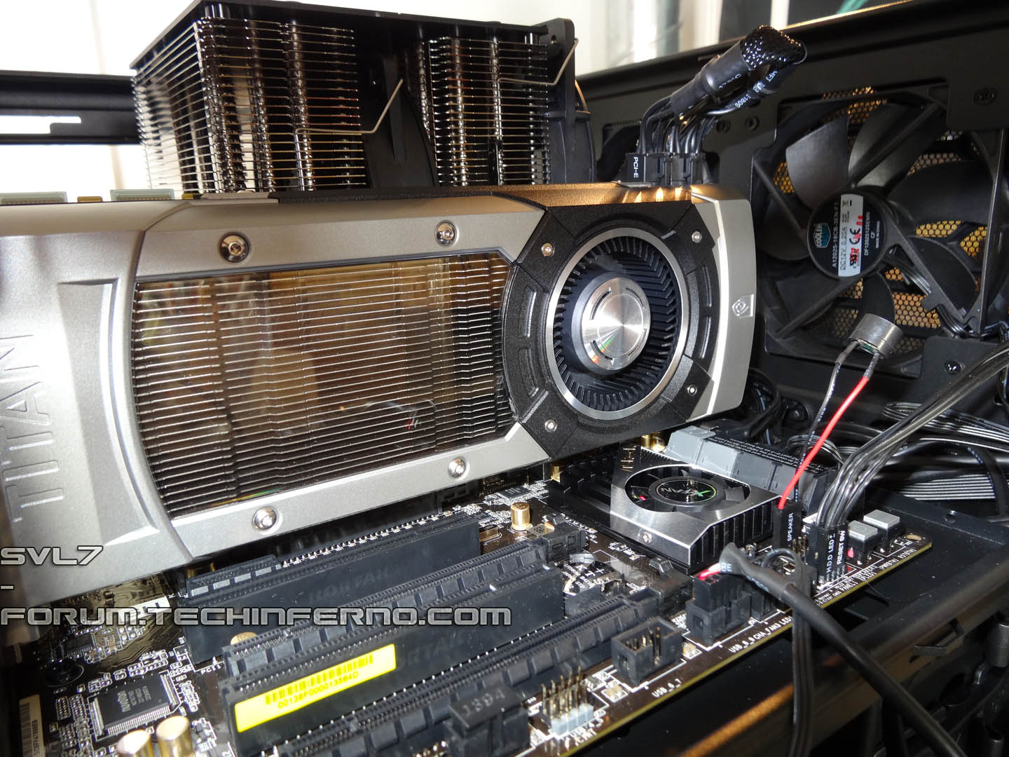

svl7 Posted March 4, 2013 Author Share Posted March 4, 2013 Some pics added to the first post, desktop is built. I hope the new monitor arrives tomorrow. Quote Link to comment Share on other sites More sharing options...

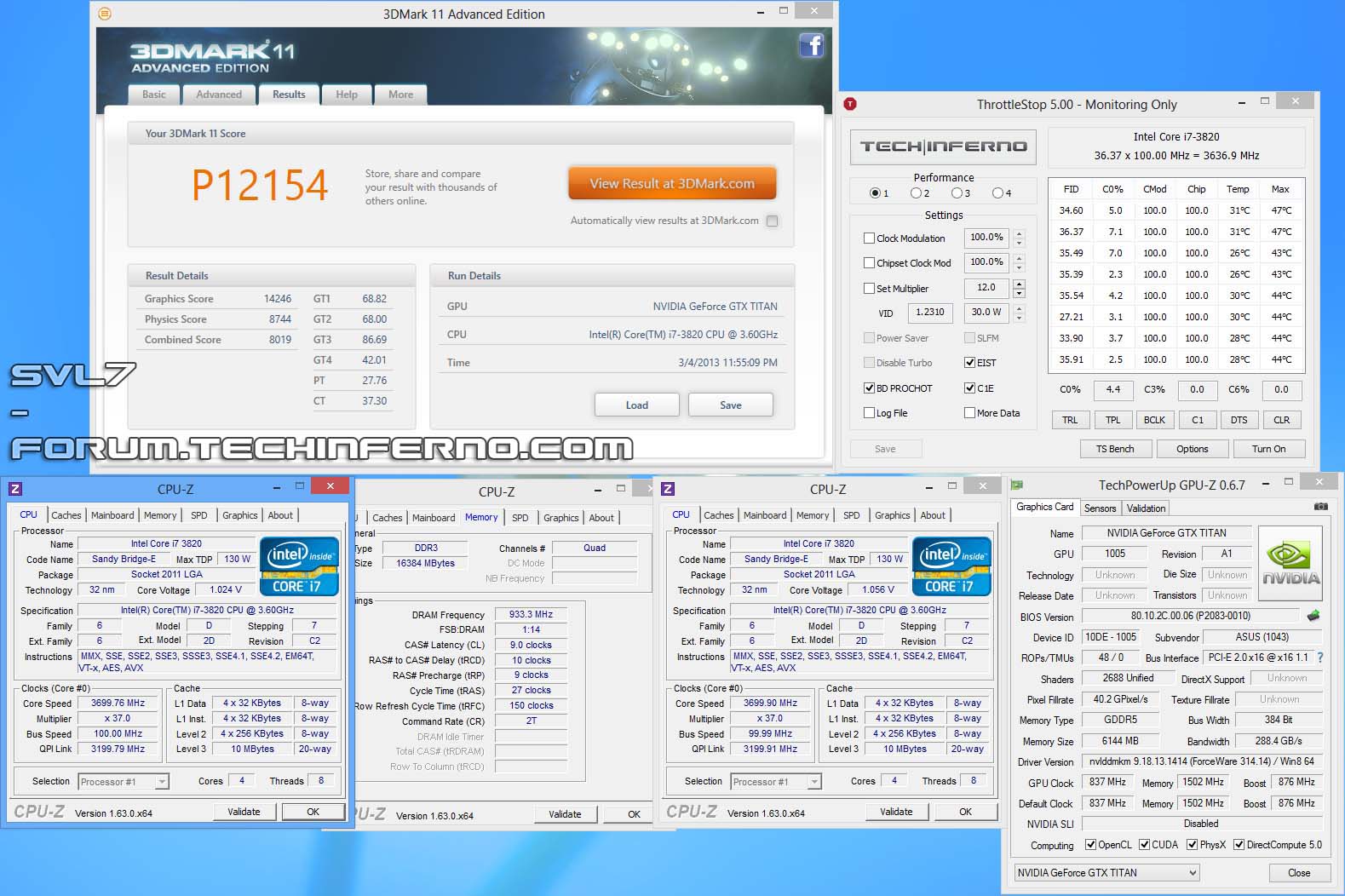

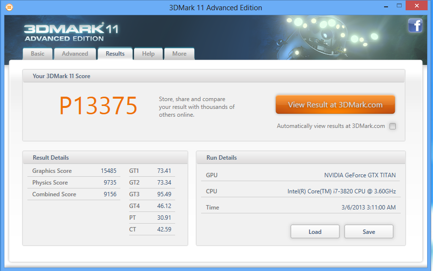

svl7 Posted March 4, 2013 Author Share Posted March 4, 2013 First 3dm11 run, complete stock. 3 Quote Link to comment Share on other sites More sharing options...
Khenglish Posted March 4, 2013 Share Posted March 4, 2013 How does seeing a max CPU temp of 47C feel after using laptops for so long?Oh and it makes only like a 5 point difference, but it looks like you were running PCI-E 2 instead of 3. Quote Link to comment Share on other sites More sharing options...
svl7 Posted March 4, 2013 Author Share Posted March 4, 2013 Yeah, haha, pretty cool... The PCIe stuff is weird, I set it to Gen3 in the bios, but it's still 2.0. Also one of the fan connectors doesn't seem to react to any setting... I guess that bios is messed up, no idea. Quote Link to comment Share on other sites More sharing options...
Founder Brian Posted March 5, 2013 Founder Share Posted March 5, 2013 Nice, it should hit 16-17k gpu with a little overclocking. All my parts ship out today so hopefully by Friday I have my desktop ready to go.Sent from my GT-N7000 Quote Link to comment Share on other sites More sharing options...
johnksss Posted March 5, 2013 Share Posted March 5, 2013 How does seeing a max CPU temp of 47C feel after using laptops for so long?Oh and it makes only like a 5 point difference, but it looks like you were running PCI-E 2 instead of 3. it's running 3.0. Yeah, haha, pretty cool... The PCIe stuff is weird, I set it to Gen3 in the bios, but it's still 2.0. Also one of the fan connectors doesn't seem to react to any setting... I guess that bios is messed up, no idea. Nice job! That stock score is worth 4 GL points on the bot. Didn't gpuz say they they were going to add it to 068? Because your looks just like Vince's. k|ngp|n`s 3DMark11 - Performance score: 20990 marks with a GeForce GTX Titan Quote Link to comment Share on other sites More sharing options...
Khenglish Posted March 5, 2013 Share Posted March 5, 2013 Yeah, haha, pretty cool... The PCIe stuff is weird, I set it to Gen3 in the bios, but it's still 2.0. Also one of the fan connectors doesn't seem to react to any setting... I guess that bios is messed up, no idea. I just remembered that Nvidia makes you install a patch to enable 3.0 for SB-E: NVIDIA Releases PCI-Express Gen 3.0 Enabling Patch for Sandy Bridge-E HEDT Platform | techPowerUp Quote Link to comment Share on other sites More sharing options...
svl7 Posted March 6, 2013 Author Share Posted March 6, 2013 Thanks! Now that you mention it I remember having read something about this... but the fix doesn't seem to make a difference, GPU-Z still reports the same.Edit: Nevermind, Nvidia Inspector shows 3.0, lol. Quote Link to comment Share on other sites More sharing options...

svl7 Posted March 6, 2013 Author Share Posted March 6, 2013 It looks like the end of gaming laptop for you. Bad news for us nb users.... lol Well, I'll see about that, hahaha, but 2560x1440 at 27 inch is addicting... Here's a first run with some OC: 2 Quote Link to comment Share on other sites More sharing options...
