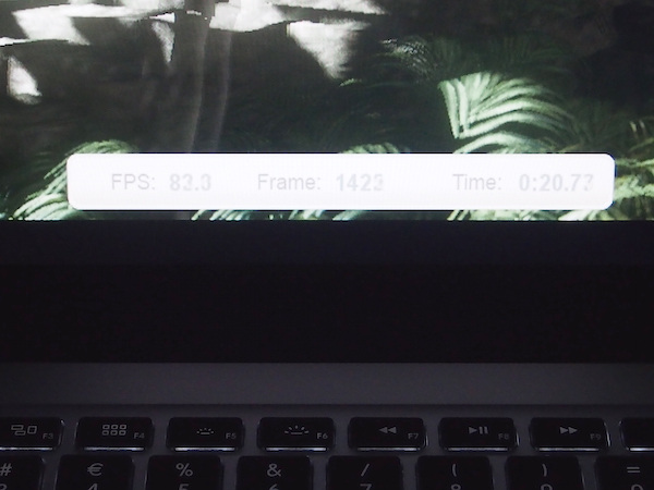

Now this is getting really interesting, I booted without monitor plugged in and got these results:
(internal retina screen)
AMD Radeon R9 280X video card benchmark result - Intel Core i7 4702HQ,Apple Inc. Mac-3CBD00234E554E41 11890 (graphics, 96.4% of external monitor performance)
AMD Radeon R9 280X video card benchmark result - Intel Core i7 4702HQ,Apple Inc. Mac-3CBD00234E554E41 11848 (graphics, 96.1% of external monitor performance)
Then via DVI:
AMD Radeon R9 280X video card benchmark result - Intel Core i7 4702HQ,Apple Inc. Mac-3CBD00234E554E41 12325 -> IS THIS NEARLY 100% OF DESKTOP PERFORMANCE???
25.7% improvement to my previous test without Virtu MVP 2.0:
How is this possible? This was not my Crossfire setup, only one R9 280X. The card was very quiet during the tests. What would it be with a R9 290X or R9 295X2, I cannot imagine… For some reason 3DMark11 randomly crashes after this driver installation. It doesn’t seem to matter whether I am using internal or external screen. But I can restart the program.

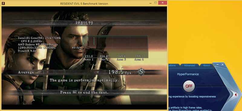

EDIT: H-HyperFormance unchecked: (internal retina, 90.2% of real external monitor performance)
Hyperperformance is supposed to predict which frames (or rendering tasks) will never be shown and take them out so the GPU can work on what is needed.

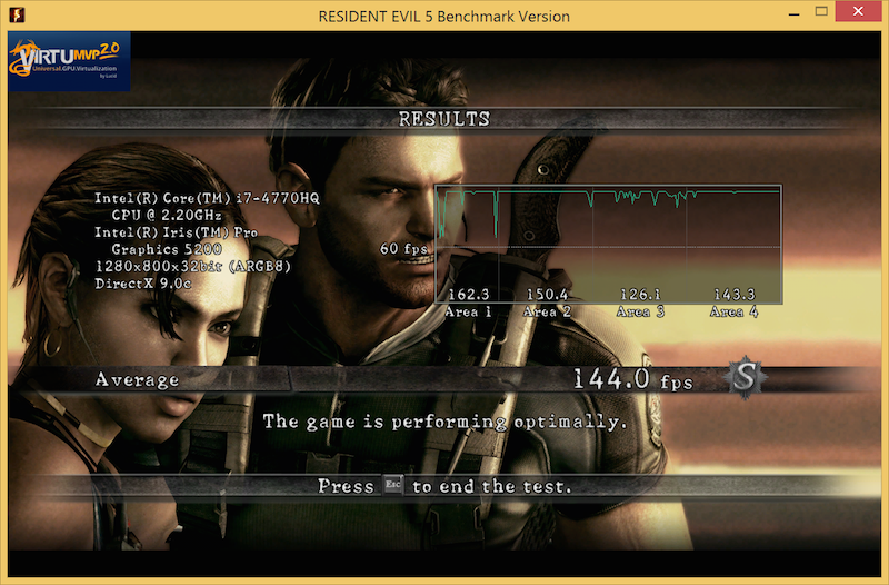

Here the Resident Evil 5 benchmark results (1280x800 windowed mode)
When we compare 3D11 graphics score (Hyperformance disabled) to @Dschijn Optimus benchmarks here, and assume that he used the native 2880x1800 resolution, Optimus technology is approximately 5% (90% vs 95%) faster. The resolution does affect. For instance, the 3D13 internal screen benchmark scores vary between (75% - 89%) depending on the resolution (2880x1800 / 1440x900). 3D13 Fire Strike test showed only 1% difference between Optimus and Virtu MVP 2.0 (75% vs 76%).
