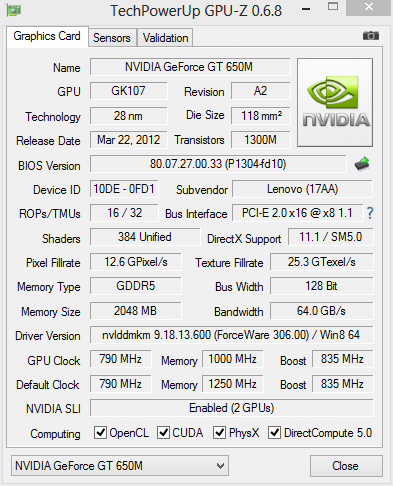

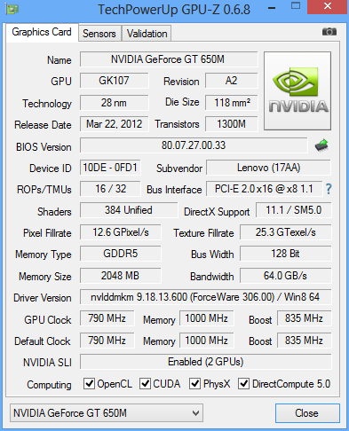

Yeah, cool, please put that card in the other system and post some GPU-Z screenshots as well. Might give me a clue.
I've got the same GPU-Z readings as RichardIsBored. This is on svl7 modded BIOS v1.05.
Internal GPU:
Ultrabay GPU:
