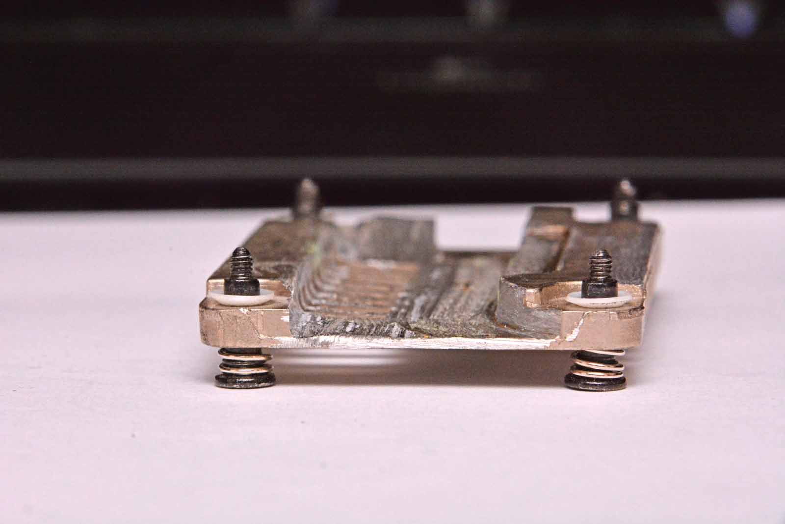

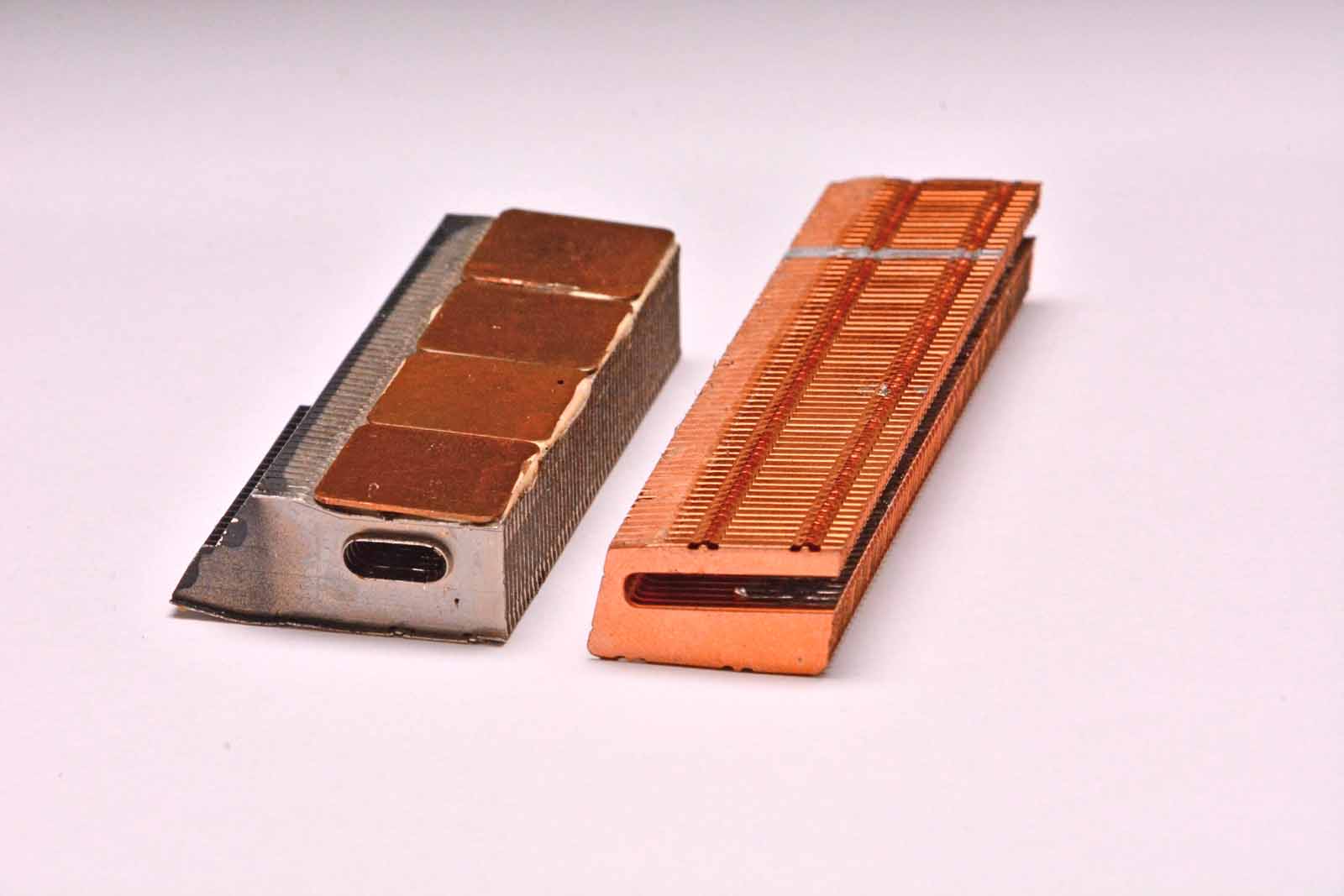

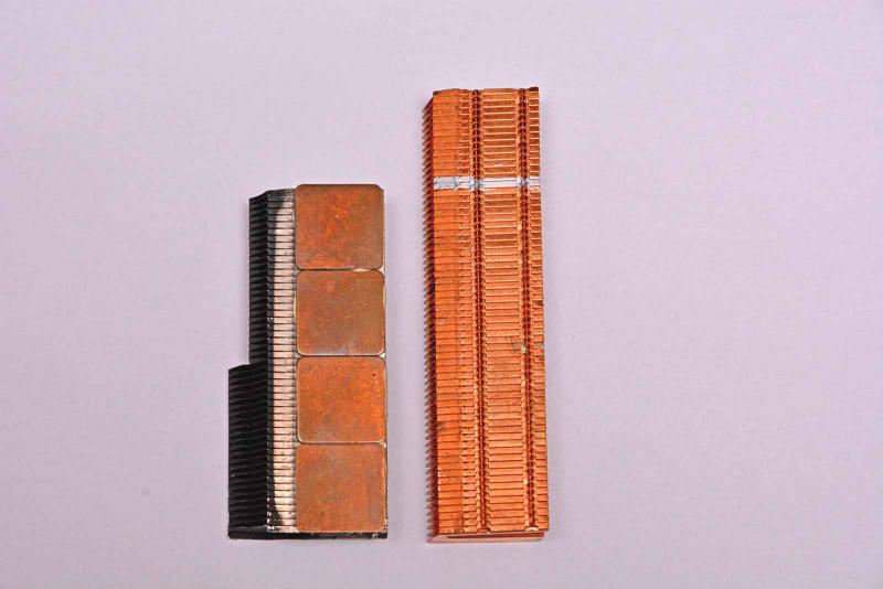

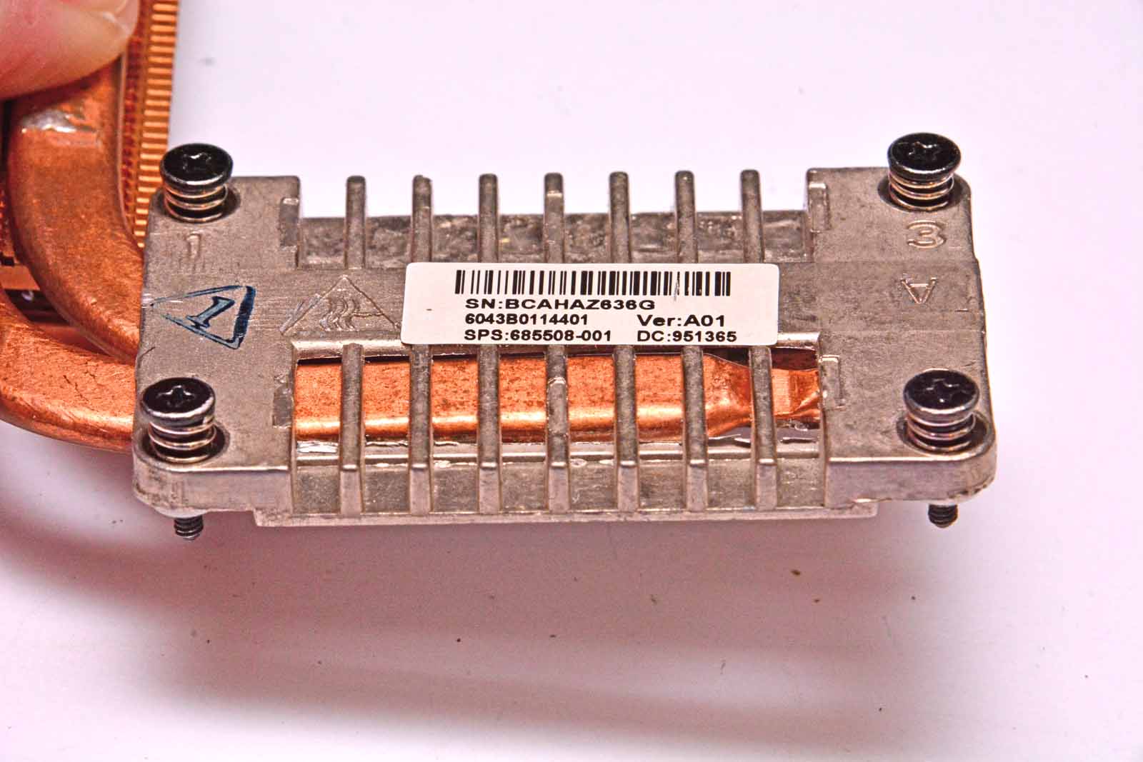

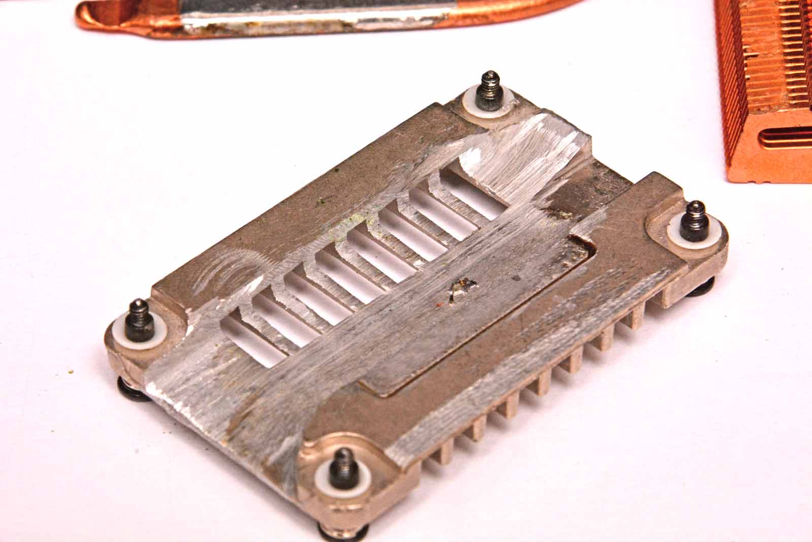

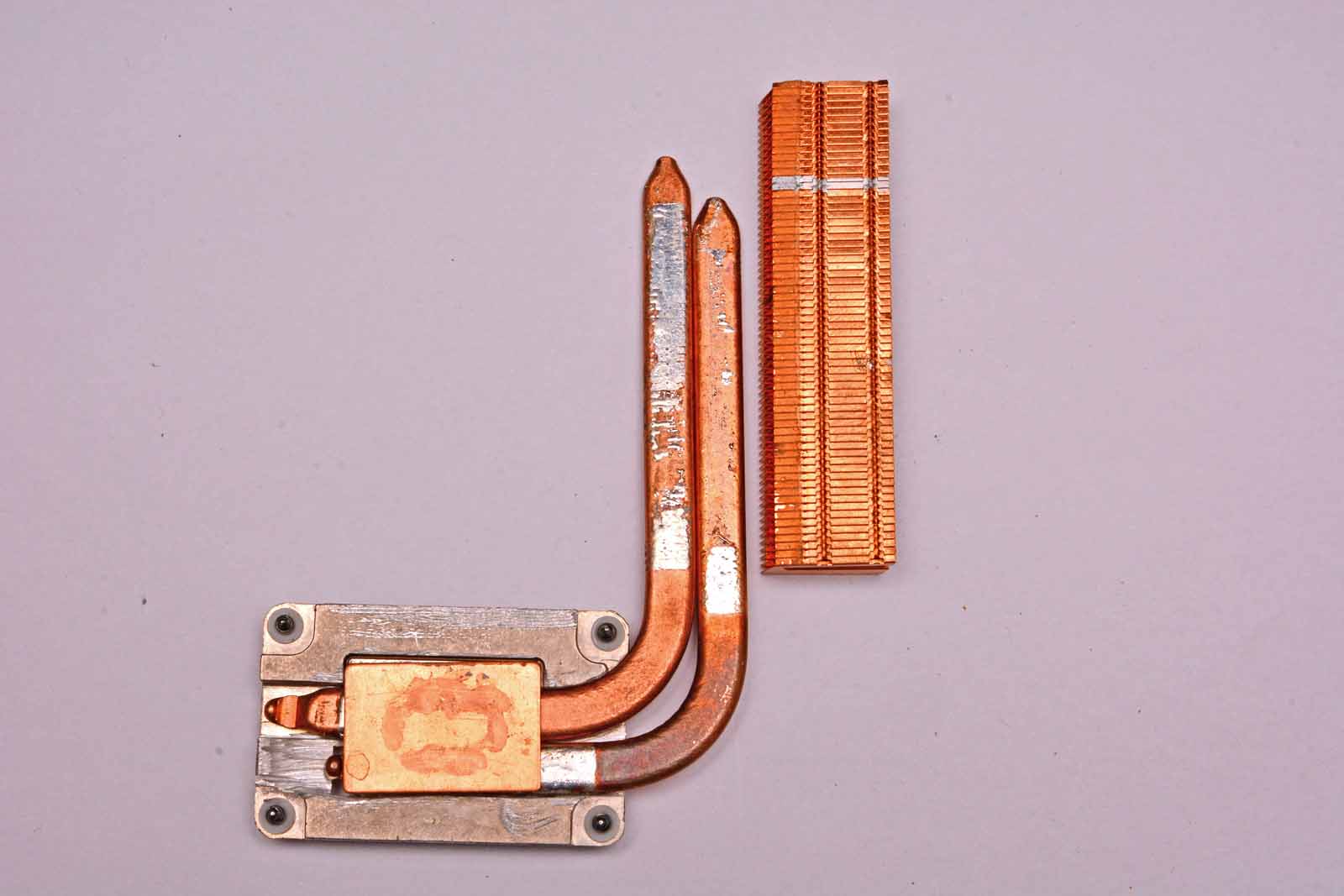

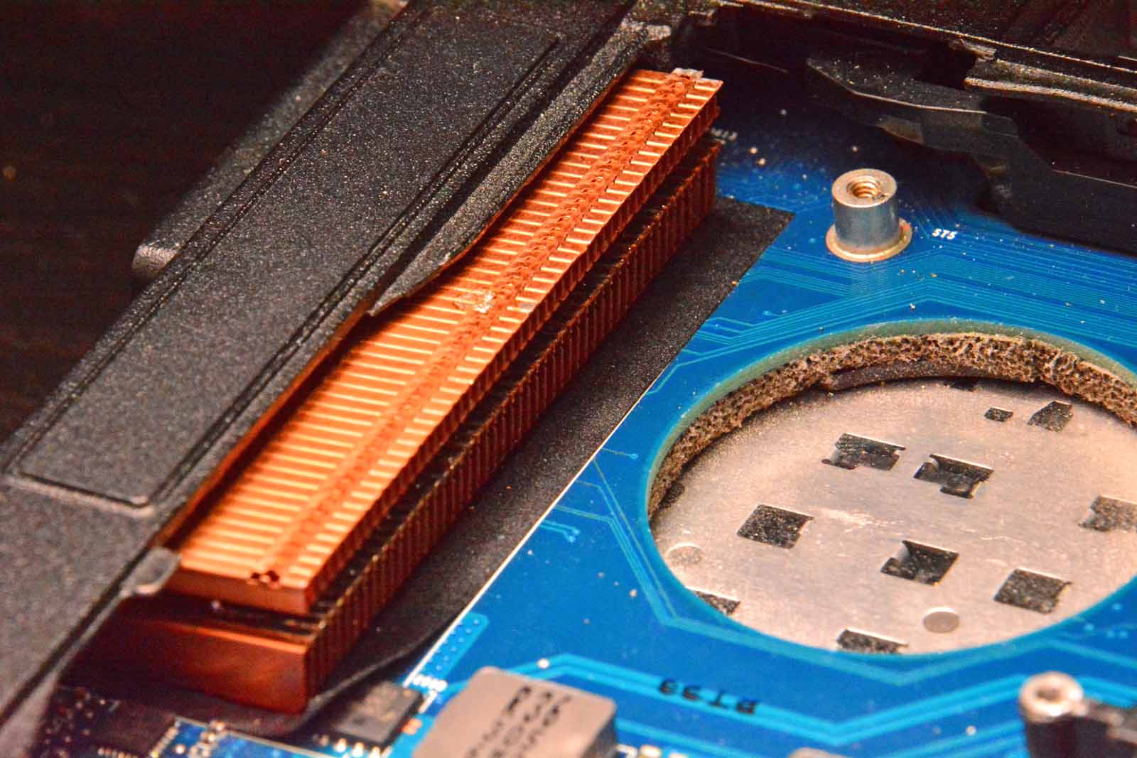

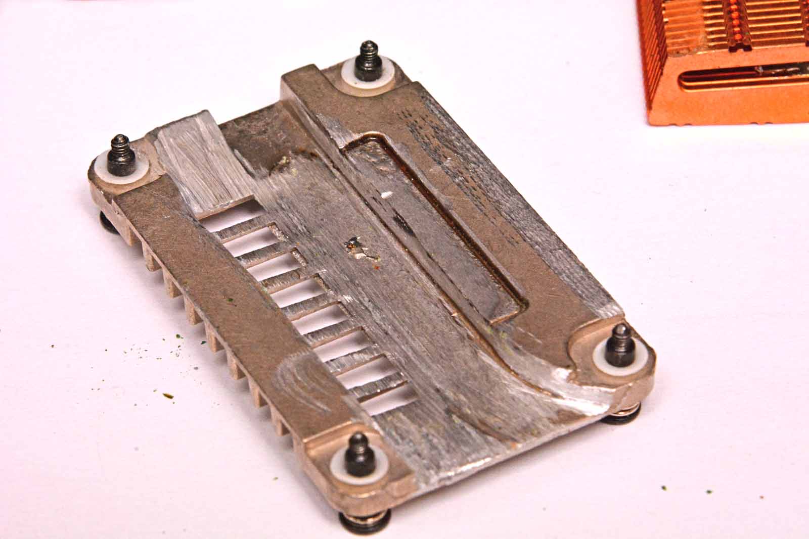

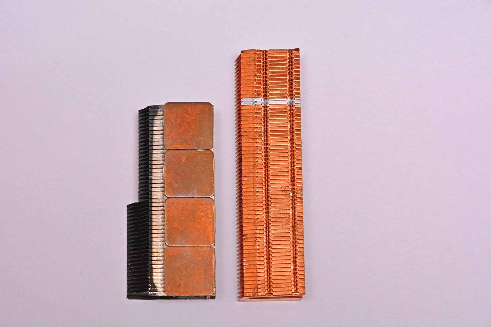

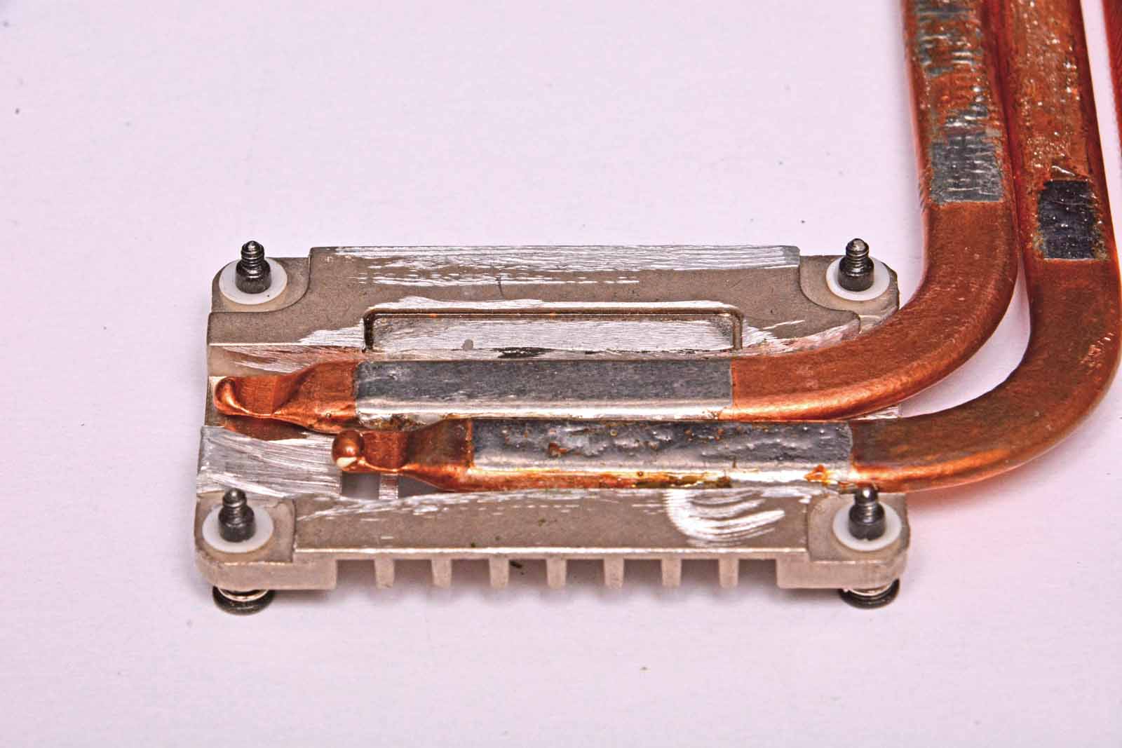

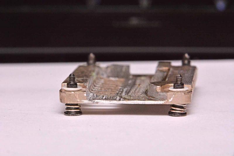

Hey everybody, I know it's been a while since my last update on the cooling solution, but Harvey hit us hard and just got everything back together so I'll toss up some updates. Well here is where I am on the second attempt of a prototype cooling solution.
Basically it's keeping, re-using and modifying the aluminum heat sink because the copper one i had before was just retaining too much heat. I found the aluminum may heat up faster, but it doesn't retain much of the heat as it's going to be getting hopefully sent through now 2 heat pipes and to the copper radiator replacing the aluminum one. I still have to order the pyrolytic graphite to help move the heat off the heat sink and over to the pipes and radiator. And lastly the silver solder to join everything together. There is plenty on the parts, but i just want to make sure then is a good bond. I'm also making a good seal from fan to radiator with extra thermal tape for no leaks.
As you can see I found a whole new cooling system from another laptop and am going to be using the radiator off it, I marked it where I will be making my cut and it worked and i test fit it and the width, height and length is just right. Only issue is I need to shape it like the stock one to avoid that dumb port on the side i'll never use by the vents. Any ideas on how to cut super thin radiator copper lol? I grinded down the heat sink plate to accommodate 2 pipes and those will slide right into the new radiator hopefully taking more heat off the cpu and to the cooling area. I still have the cut out under the stock fan and in the future might try to work in another fan over the heatsink, like a 3 or 5mm one.
Edited by shikyo
forgot 2 pics

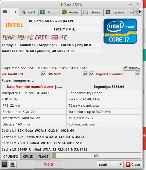

Hi guys. I want to ask for your help. I want to buy a second-hand 2570p, but all I see in the surplus shops are those equipped with 3320m processors. Unfortunately, these shops won't allow for me to open the case to see it the cpu inside is removable or not. I booted Manjaro off a USB (as the laptops doesn't have an OS installed) and installed an application i-Nex (similar to CPU-Z).
The app i-Nex reported the cpu inside to be of socket BGA1023.
1) From what I learned so far, BGA processors are soldered on the motherboard. Does that mean the 2570ps I saw contained a soldered 3320m processors, making my plans to upgrade to 3612qm impossible?
2) Plus, do HP 2570ps with soldered cpus exist? Those I saw were 2nd-hand 2570ps from Japan.
3) How would I chose a 2570p that has a no soldered CPU if:
a) I'm not allowed to open the case (seller has those warranty stickers that will get broken if the case is opened), and
B) No OS installed on the laptop, so no CPU-z?
c) Store personnel are totally dumb about laptop internals.
Please advise me guys. I need to purchase one and upgrade the dual core to a quadcore.
Edited by Onoakino
Typo.

1) You cannot upgrade a BGA processor unless you resolder it. Impossible for all practical purposes.
2) I don't believe that BGA 2570ps even exist. Anyone please correct me if I am wrong.
3) You can run something like Mini-Windows-XP from a USB, I use the one in Hirens Boot CD. Still not sure if CPU-Z will detect the socket type correctly.
I would generally advise you to google the exact model number.
Otherwise I am selling my 2570p and would gladly sell you the barebones, since I will be building a Toshiba C870 rig with the main components. But I don't know if you can even contact me about that, I think it is forbidden talking about buying/selling stuff here :D Probably you can look at the one and only "Custom 2570p" on Ebay.de and contact me there. Hope that is not that irregular thing to do.
Thanks for replying @batyanko
If I can't find a socketed 2570p here in the Philippines, I think I'd consider the recommendation of choosing  to go Dell e6430. Not for anything, but ordering outside the country would inevitably raise the product cost, and I'm cash-strapped at the moment.
On your answer to number 2. I swear my eyes were not deceiving me  when I ran i-Nex (a Linux counterpart of CPU-Z) on all three 2570ps i was testing.
All three laptops had 3320M installed. All of the three showed the cpu socket type as BGA1023.
It's important to note that on Intel's product specifications page, the 3320M was listed to support two sockets -- FCBGA1023 and FCPGA988. i5 3320M Specs
I'm starting to think that the laptops are custom-made as the stickers left on the body of the laptops suggested it was intended for office use. Could it be that the company ordered a bga1023 configuration?
To those of you here who have a socketed motherboard, does your CPU-Z reflect you have a PGA988 socket procie?
Thanks!
I just tried both CPU-Z on a properly installed Windows 8.1, and I-nex on a live Linux Mint 18.1.
- CPU-Z reports a rPGA988B CPU.
- I-Nex reports BGA1224:
Since I have personally installed that 3720QM, I can sure tell there were more than enough pins on it :)
So I-nex seems to detect the wrong socket on this CPU, and by all chances the 2570ps have normal pin-sockets for replacable CPUs.
Edited by batyanko

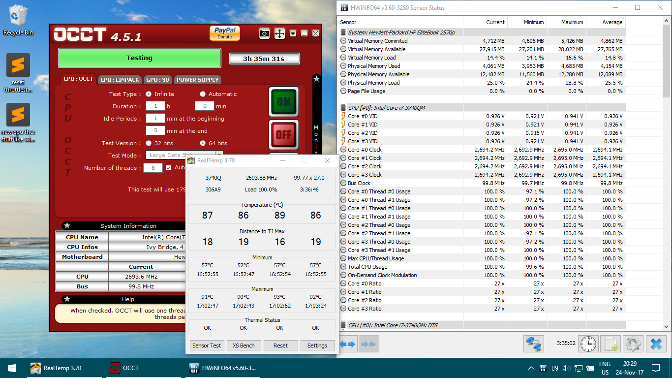

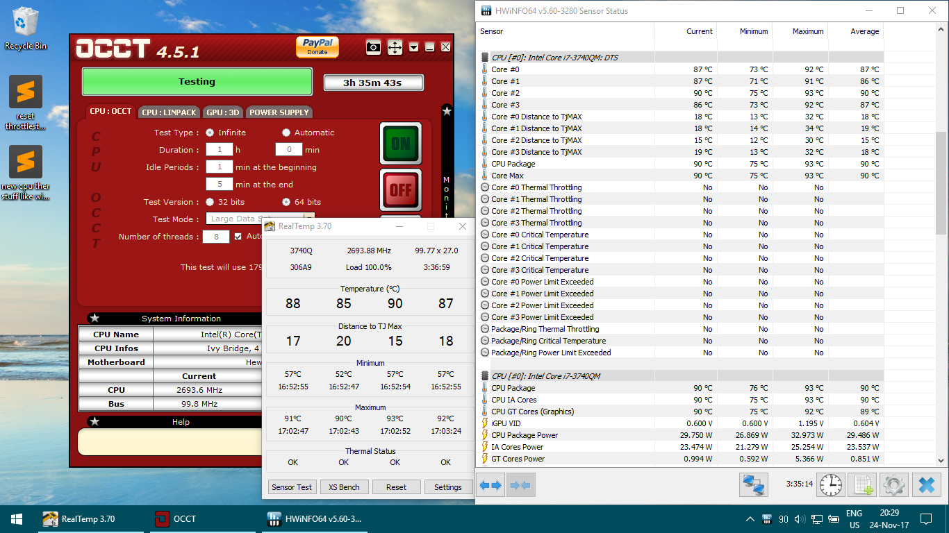

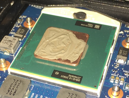

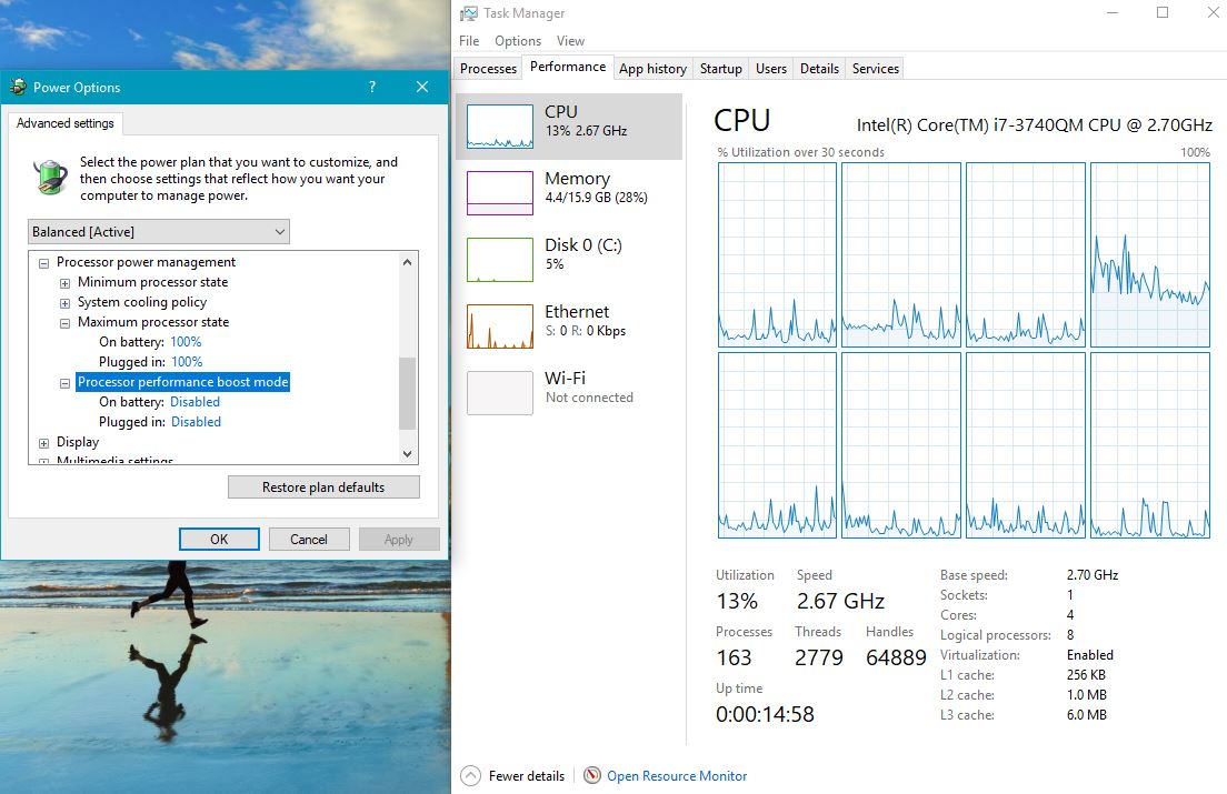

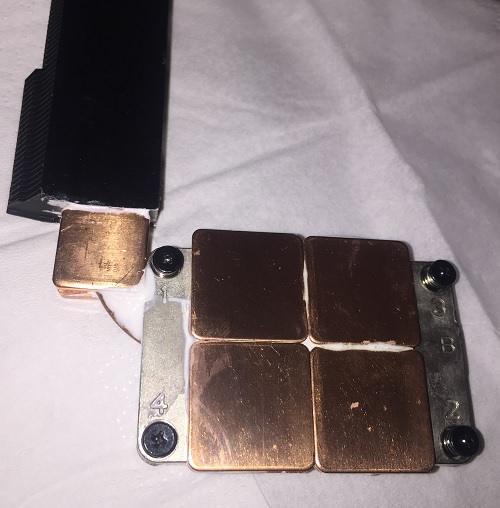

I want to share my current success with CPU upgrade and heatsink mods. Might be some help to others.
Things in this post:
-3740QM experience
-Fan profile and HPFanControl experience(with dual core i7-3520m)
-heatsink mods
-3740QM stress test
First off the heatsink mods.
On top of the heatsink I glued 8 of the 20x20x1mm copper shims. In a 4x2 grid. I couldnt find any 20x20x2mm copper shims on Ebay at the time, if I did then I uused them and put them in a 4x1 grid instead.
I also glued 2 of the 15x15x2mm copper shims on each side of the heatsink-pipe.
I used Arctic Alumina to glue them.
In between the CPU and heatsink I placed a 20x20x1mm copper shim.
I used Collaboratory Liquid Ultra between the CPU and copper shim, and between the copper shim and heatsink I used Arctic Silver.
I set a custom fan profile using HPFanControl,
to remove the annoying constant fan ramp up and ramp down, which is like someone keeps turning a vacuum on and off all the time,
Now this annoying RPM jiggle was when I had my Dual Core 3520m... I haven't had enough time to test the standard BIOS fan profile with the 3740QM, during normal laptop usage yet.
The standard BIOS fan profile was making me insane when I used my 3520m, so this was really needed.

Received the 3740QM today and installed it with the cooling mods, then set the maximum power limit to 99%.
I also ran the winsat tool again, just in case.
I ran an OCCT stress test to see if the laptop thermal throttles, TDP throttles, or just plainly crashes when the CPU is pushed to the max over a longer time.
I disabled my custom fan profile(HPFanControl) for this test, as I have not yet tested the HPFanControl with OCCT stress test, so I did not want my results to be broken by the use of a possibly bugged homemade fan profile.
I ran the test for 3.5h, using RealTemp to measure max CPU core temperatures(it has a fast polling rate), and HWInfo to verify there are no "Windows Hardware Error" counts, the max power usage, if any throttling occurs, and if the CPU frequency is stable at 2.7GHz(99% maximum limit in control center)
Results: Doesn't seem to be any throttling at all, and max CPU temperature was 93 degrees at an early point in the test, which tells that the maximum CPU temperature was not climbing with time. CPU frequency seemed pretty stable at 2.7GHz the whole test. The max CPU Package Power was 32.973 W(note the iGPU was not stress tested at all). Max CPU voltage was 0.941 V.
5a1883aaab096_2570p3740QM99LimitOCCTStresstesttemperaturepower(1).thumb.png.31857c79e0b35644bf642c3ed0f13f46.png
5a1883b0d20ef_2570p3740QM99LimitOCCTStresstesttemperaturepower(2).thumb.png.89447975f8846ef545f683cbe7884c51.png
Other notes:
I tried using Noctua NT-H1 but all of the paste would get pushed out of the sides of the CPU die, leaving the actual space between the die and heatsink without any paste...Arctic silver 5 worked better.
I've broken the heatsink of my macbook pro once by using Liquid metal on it. The liquid metal literally started to boil the heatsink, like one of those "science exploding foam" experiments, and split it in half, all while i was standing stumped and frozen by the experience. So I can't recommend using liquid metal directly on the heatsink, as a little particle of liquid metal that somehow gets leaked to other non-copper part of the heatsink starts to melt the whole metal block.
It should(hopefully) be fine if you use it between a copper shim and the CPU die, like I did here, as liquid metal and copper seems to work fine except a little color change on the copper with time. If the copper somehow gets unusable then just replace the copper shim. Better and cheaper than having to replace the whole heatsink.
I haven't tried throttlestop yet as I have not figured out how I should use it.
I haven't tried running a stress test with 100% max CPU limit yet, im pretty sure it will thermal throttle when running stress tests, but stress tests does not directly tell the story to most personal use cases. I'm looking for the temperature spikes during short bursts of high CPU usage, which should happen in most cases for me, like when browsing etc, and im pretty sure the CPU won't thermal throttle on those times. However I do watch a lot of YouTube in higher quality(1440p and 4K), and on an external monitor, so the CPU will be taxed over a longer time in that use case. What is most important for me is if my custom fan profile will silence the annoying fan ramping up/down.
Bottom line if it runs quiet then I will keep it at 100%, but if the fan needs to ramp up then I will run it at 99%.
I got a pair of Bose QC25 Active Noise Cancelling headphones to replace my old ANC headphones which I use almost all day, which silences any fan noise, even at max RPM, so I might allow the standard BIOS fan profile when I'm using the cans, as the profile is more aggressive. When I take my heaphones off while doing some CPU taxing activity I'll probably have to turn the custom fan profile on.
Conclusion: My laptop didn't burn down so im glad, also now I can watch 1440p60FPS high bitrate YouTube videos and Twitch 1080p60FPS streams without dropping multiple frames a second.(Couldn't do it with my dual core 3520m)
If theres any other tests anyone want me to do please give me a suggestions
Good to hear that you got that 3740QM working. I would usually think that any QM would work on the 2570p, as I have a 3720QM myself, but last week I tried a 3630QM and it didn't POST. Still wondering if it was compatibility issue or just a broken CPU...
About that heatsink mod, it looks like a nice extra bit of mass to slow down heating, allowing you to use longer bursts of high performance. Are you thinking about adding anything else to it? The way it is, the total surface of the heatsink is pretty much the same as the stock heatsink, though copper might provide a slightly better heat dissipation. For what I understand, the layman formula for heat dissipation effectiveness looks something like this:
heatsink area * air circulation
(adjusted with some coeffitients / weights that I neither completely understand nor can really express mathematically :))
So, to really get more heat dissipation performance, you would either want to add a fan blowing at the heatsink, or add more heatsink surface. For example I like what @shikyo did with that extra fan without having to modify the bottom cover too much:
Now I'm writing all this because I really like the nice flat copper interface that you achieved there - it looks like the perfect base for adding more cooling. Specifically, I think it might be a nice idea to add some large system of aluminium fins, which can be bent conveniently to fit the available space under the hood. I have been considering something like that myself but haven't gotten around to do it.

I found a better way to disable Turbo boost. This is by far the easiest way to go if you're upgrading to a quad core.
IMO its easy to do, set up and forget, instead of having to use a 3rd party program.
I don't think its been talked about before here, but yeah here it is.
You keep the "Maximum processor state" to its standard setting of 100%
but then you install a registry tweak which will enable a new setting in the Advanced Power Options, called "Processor performance boost mode".
You set that to "Disabled" and it will completely disable Turbo Boost.
Results:
