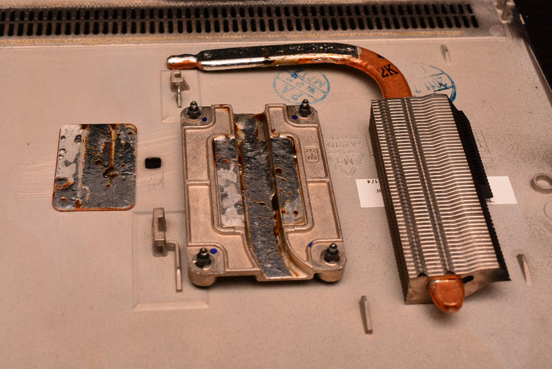

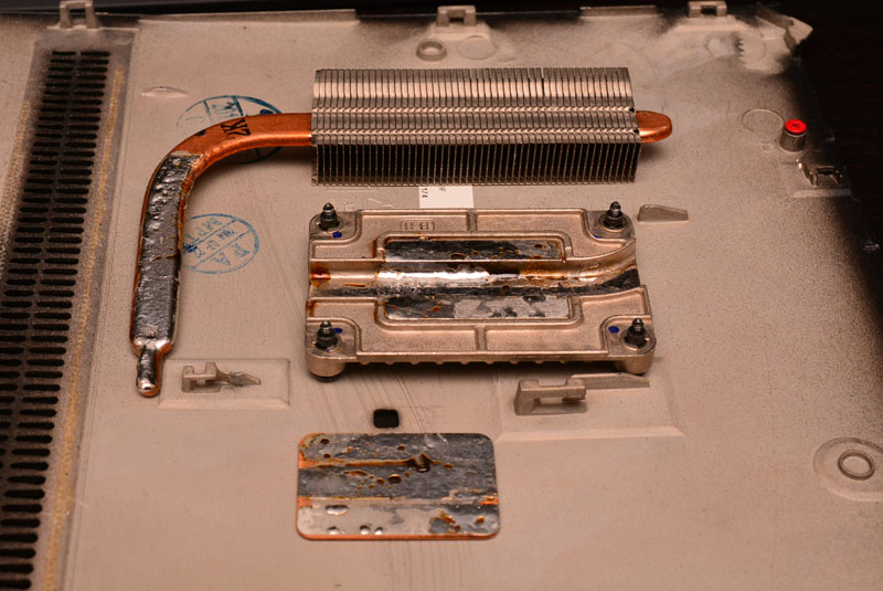

update on the stock heatsink:
400 degrees for a few minutes, with the parts elevated made them basically super easy to fall off. I lost no silver solder in the process so i'll reuse it when welding back with reverse process. the part with all the fins will slide out as well and with a little dremel action you could potentially slide in a bigger copper pipe and reapply silver solder and heat back up and it will stick.

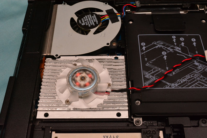

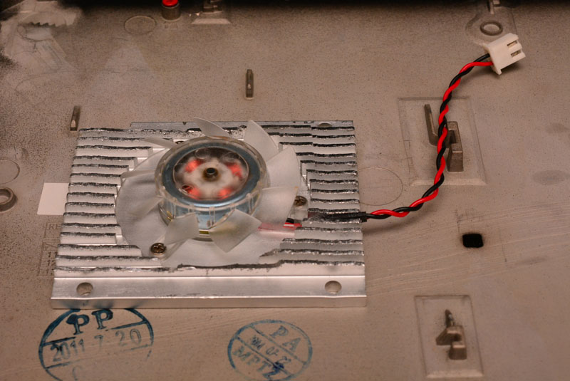

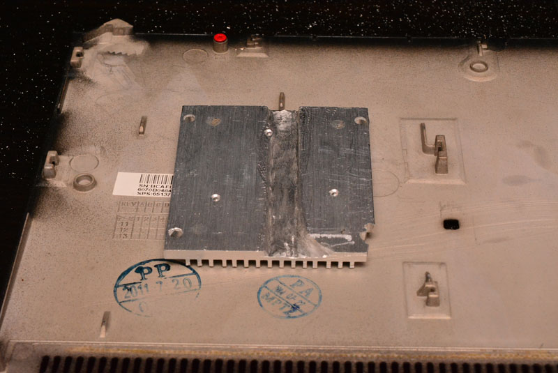

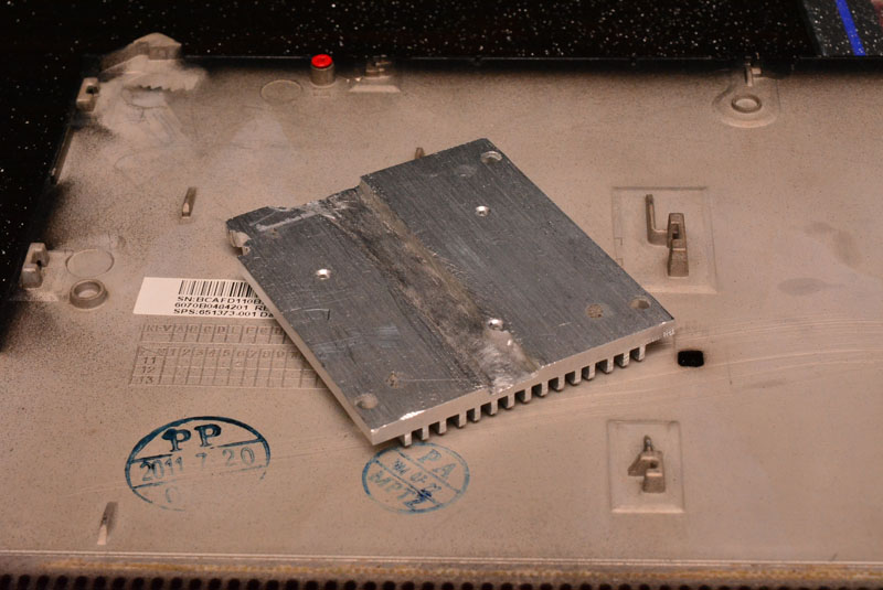

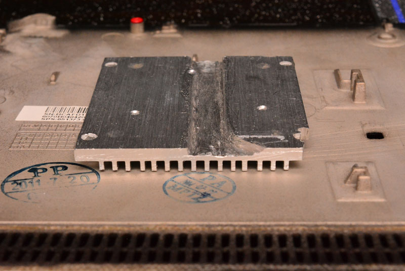

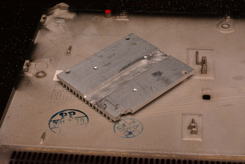

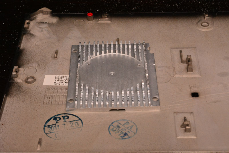

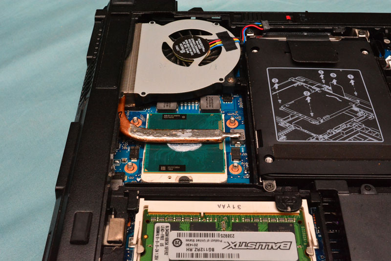

update on a prototype heatsink version 1:

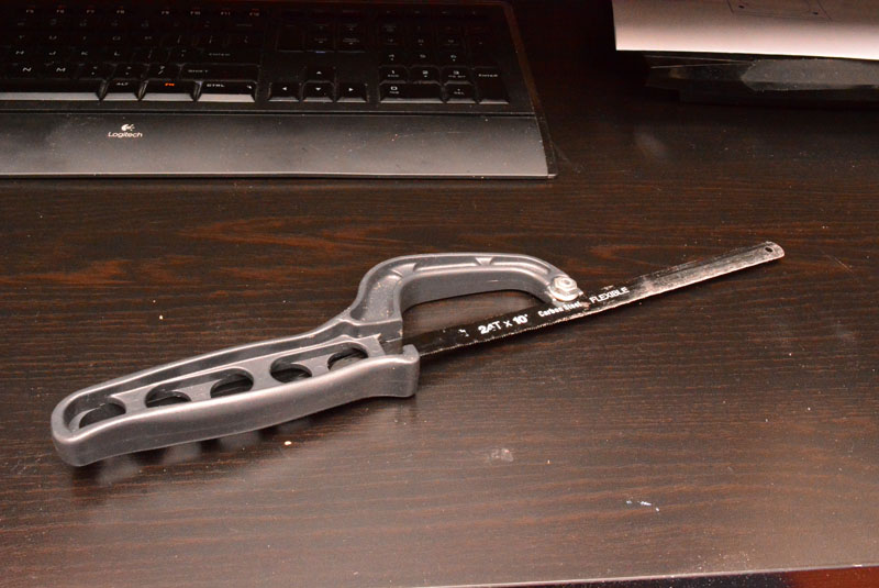

I have no access to any real tools of any kind which makes all this very difficult.

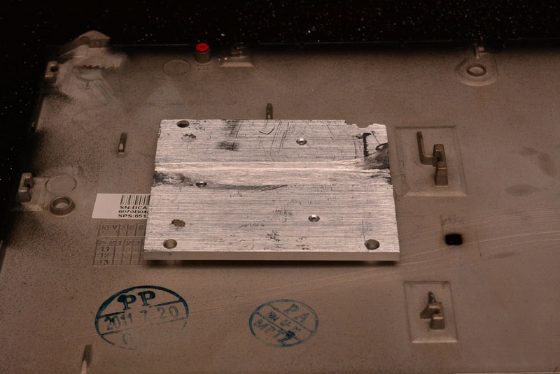

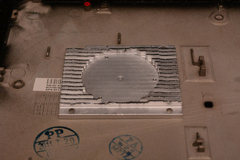

I had to hold this by hand and saw down the fins which takes an eternity and is not very straight. You can see the saw below, small and flimsy. A band saw would be quick and straight.
So I took the saw to the bottom of the heatsink to make way for the copper pipe and used the dremel to flatten it out. Very long process as it gets hot quick.
All this was done on aluminum for the first run but i do have a nice copper one that will be the final design. I went this route because the fan attaches on the topside on this one.

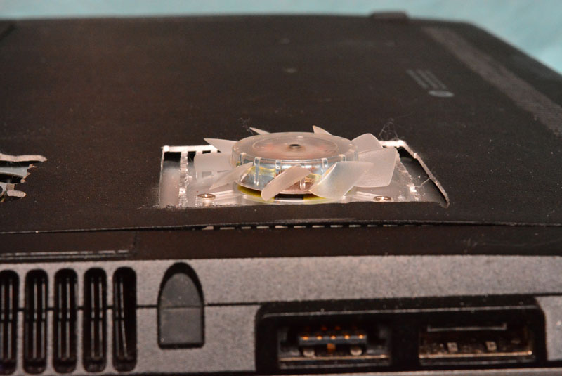

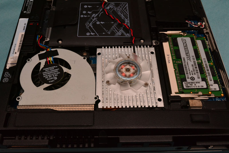

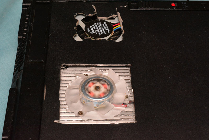

This is with the fan attached and a few test fits. At first glance it fits well and the lid goes on easy cause the cutout is wide enough. It would then need some screen to cover the whole, no problem.
Then if you check the last picture, you will see what happened. This particular "Coolermaster" mini fan is too tall, the MSI one won't be here for another couple weeks, issues from china sending the wrong one.
Unless I add really tall rubber legs and build a cage around the fan, I think it sticks out too far clearly.
So I have 3 more versions to try, I'll keep you posted.

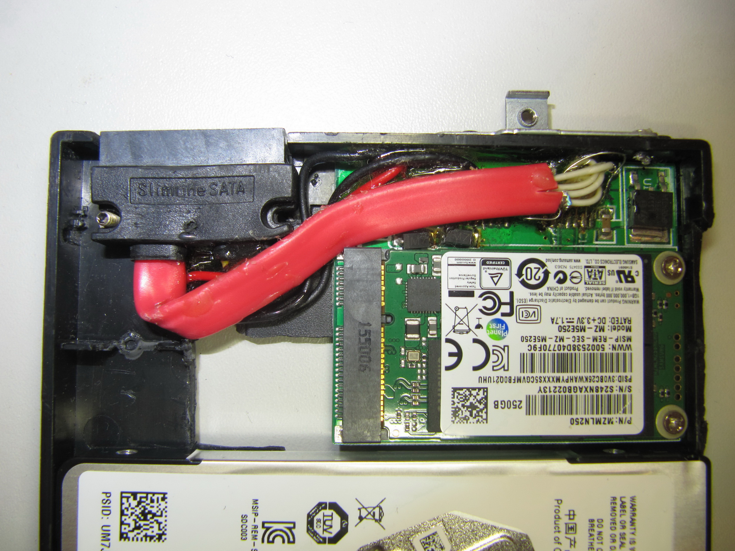

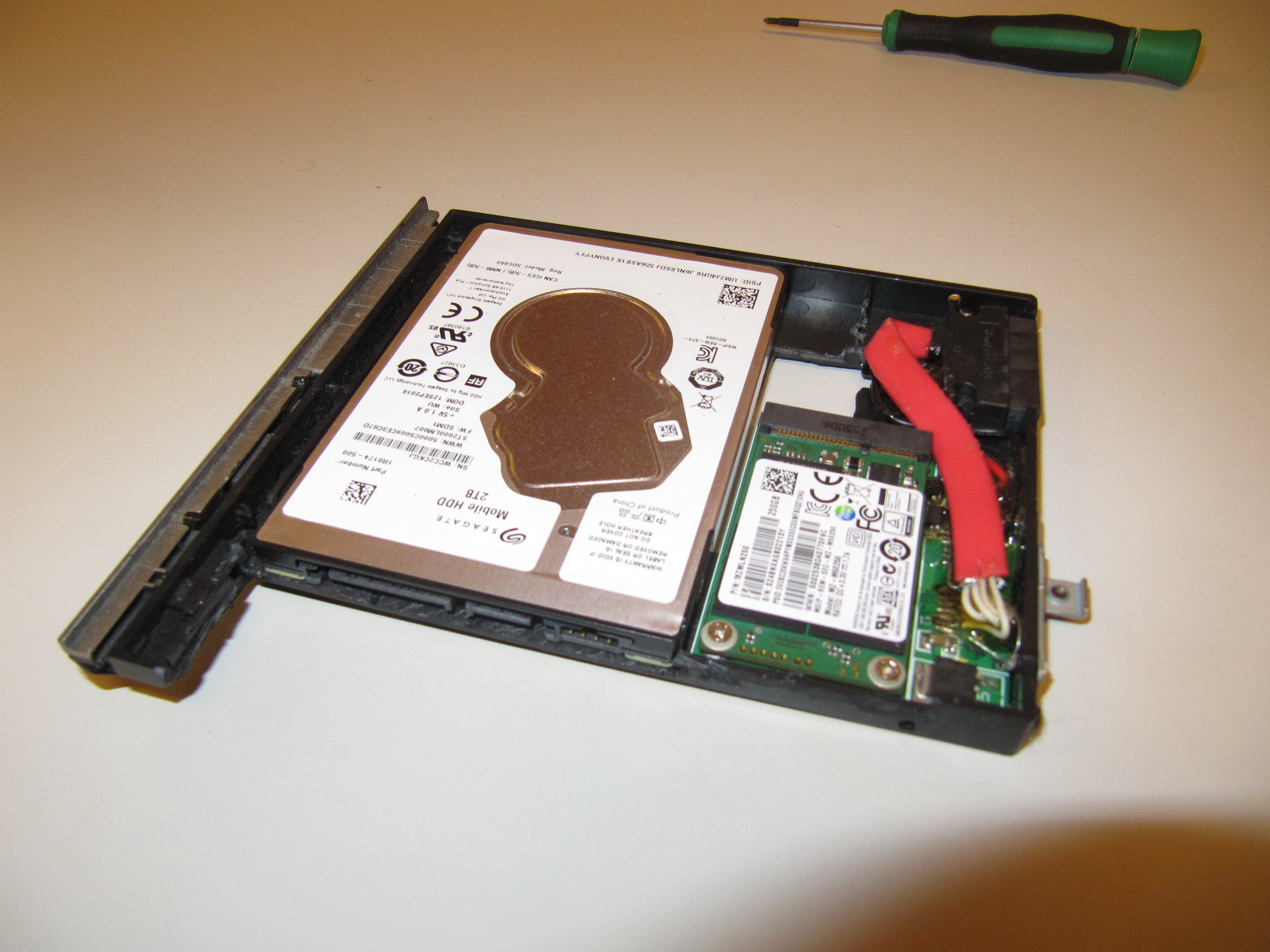

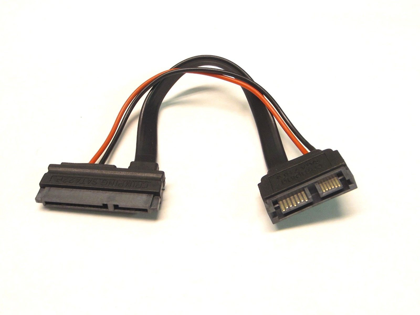

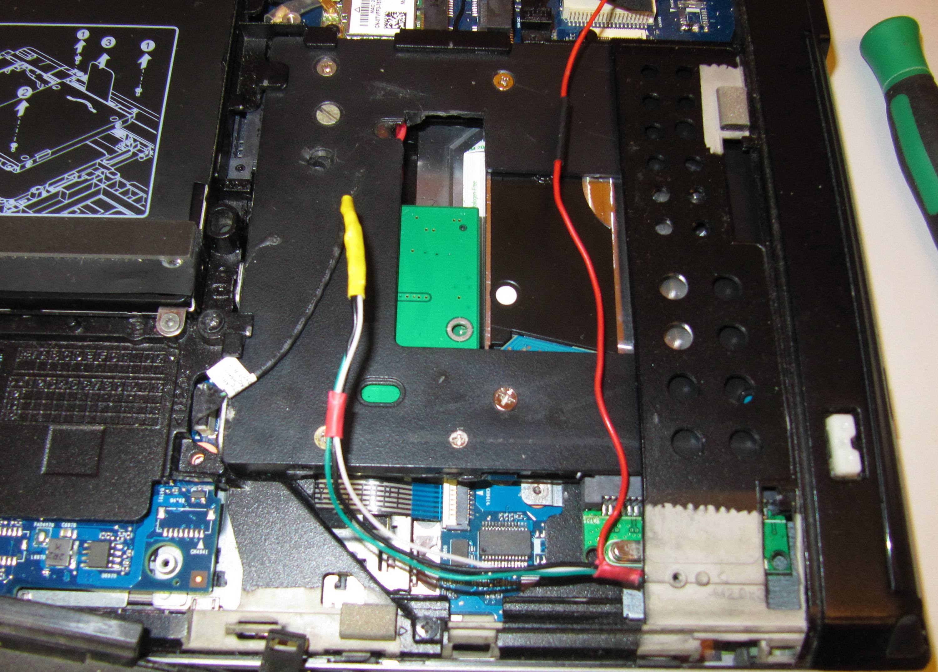

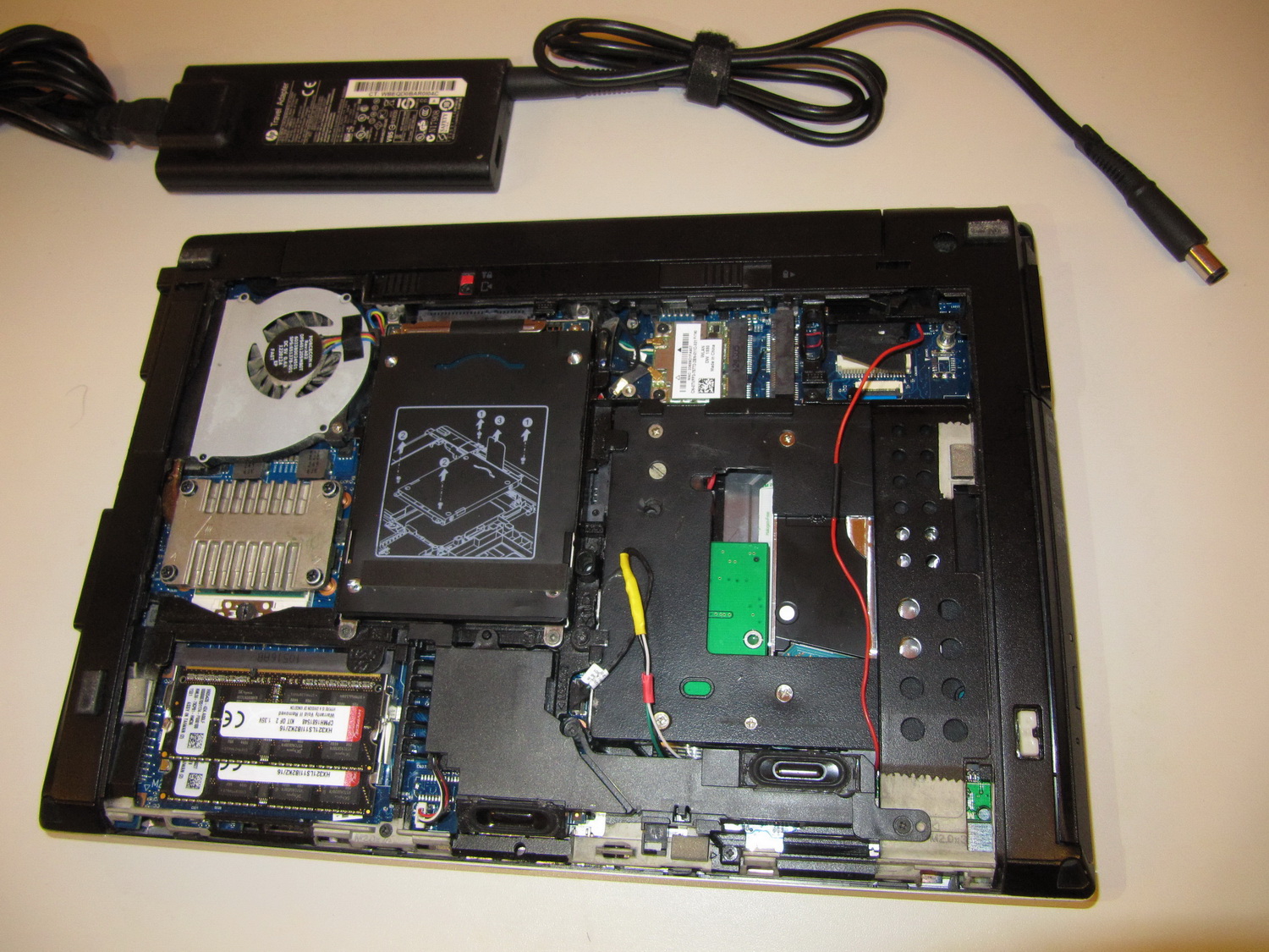

Hello  guys. I decided to explain my mod about how to install two HDD and one SSD  into our laptop. You can also use two SSD to make RAID-0 and one HDD as file's archive. You need several things to do this mod.

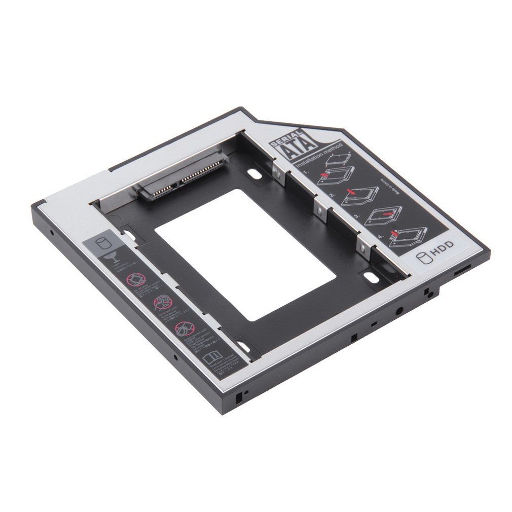

1. Caddy box made from plastic.

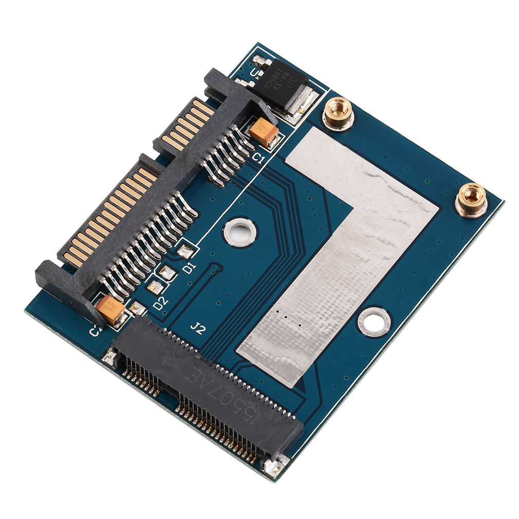

2. Sata to mSata adaptor.
3. Slimline 13 pin SATA Male to 22 Pin SATA Female Cable Adapter.

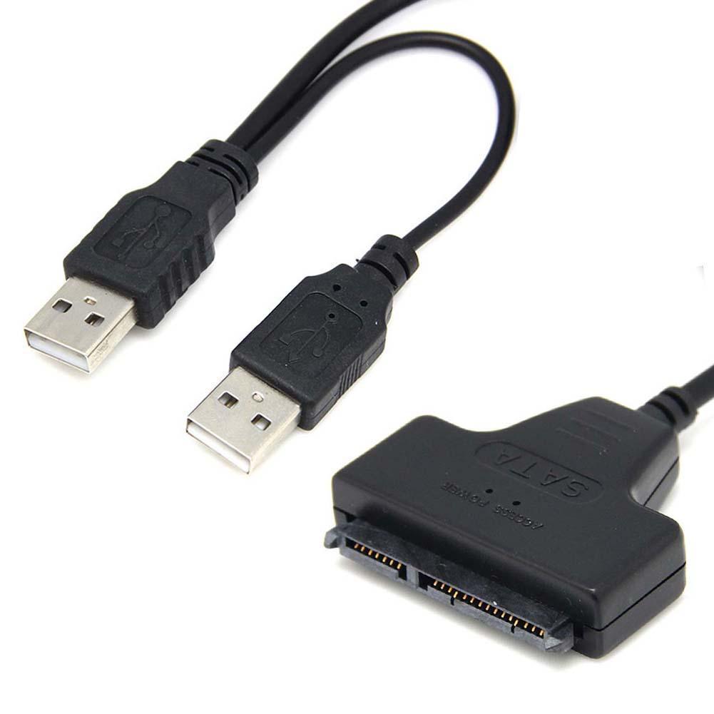

4. USB 2.0 to SATA 7+15 Pin 22Pin adapter cable for 2.5 HDD.

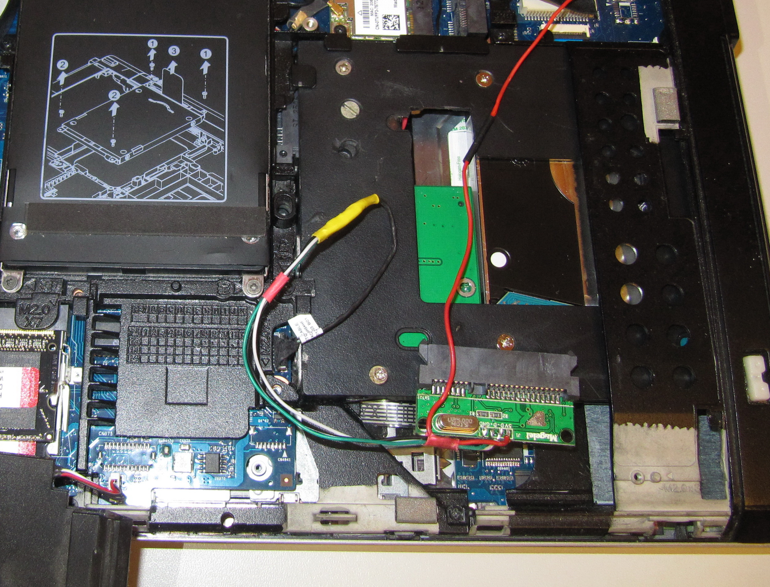

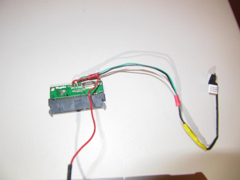

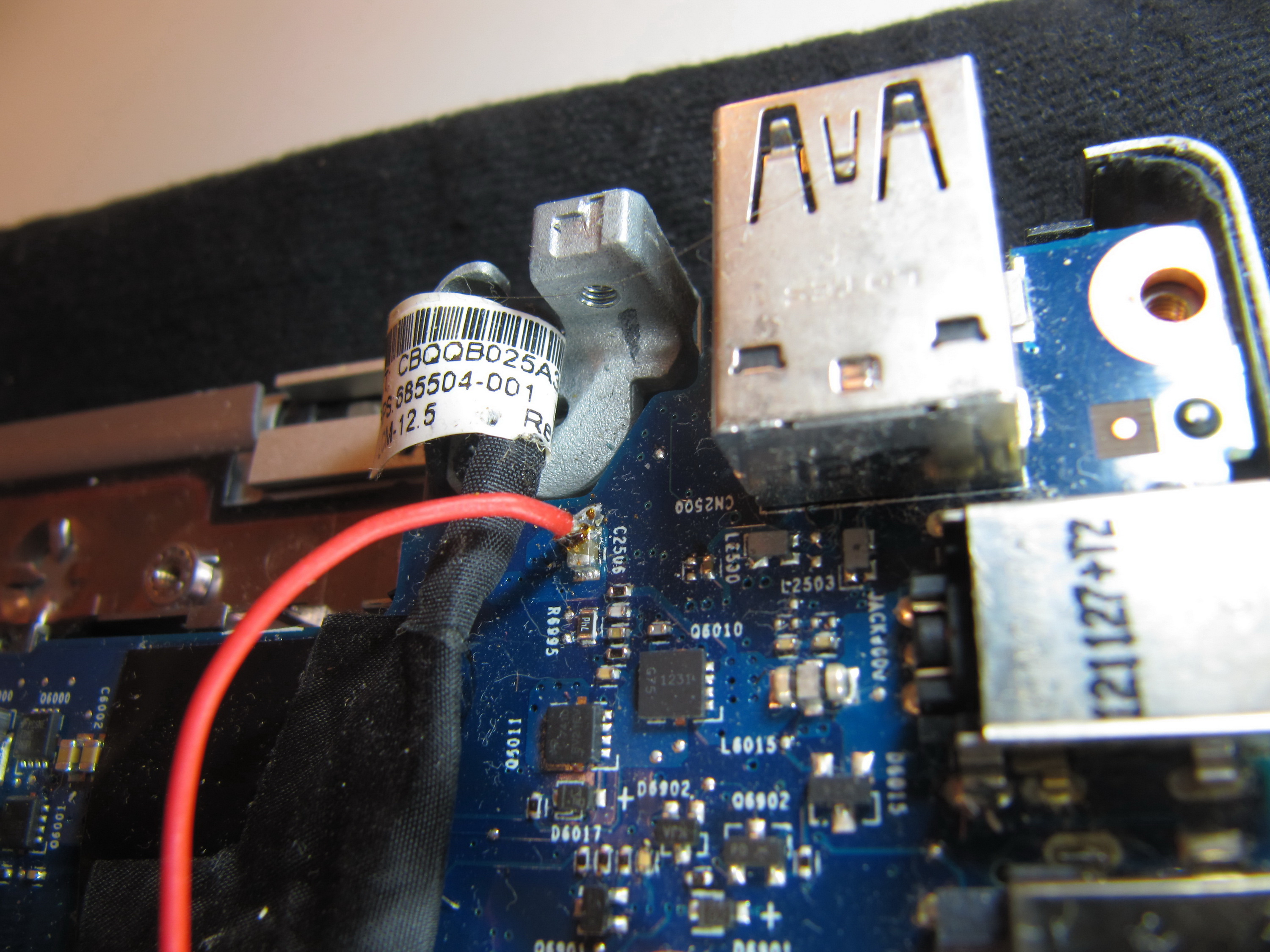

But must notice that I use the Bluetooth USB port to connect a HDD to motherboard. My previous mod is wiring the WLAN USB pins to the docking connector to enable WLAN Bluetooth and I no need a stock bluetooth.

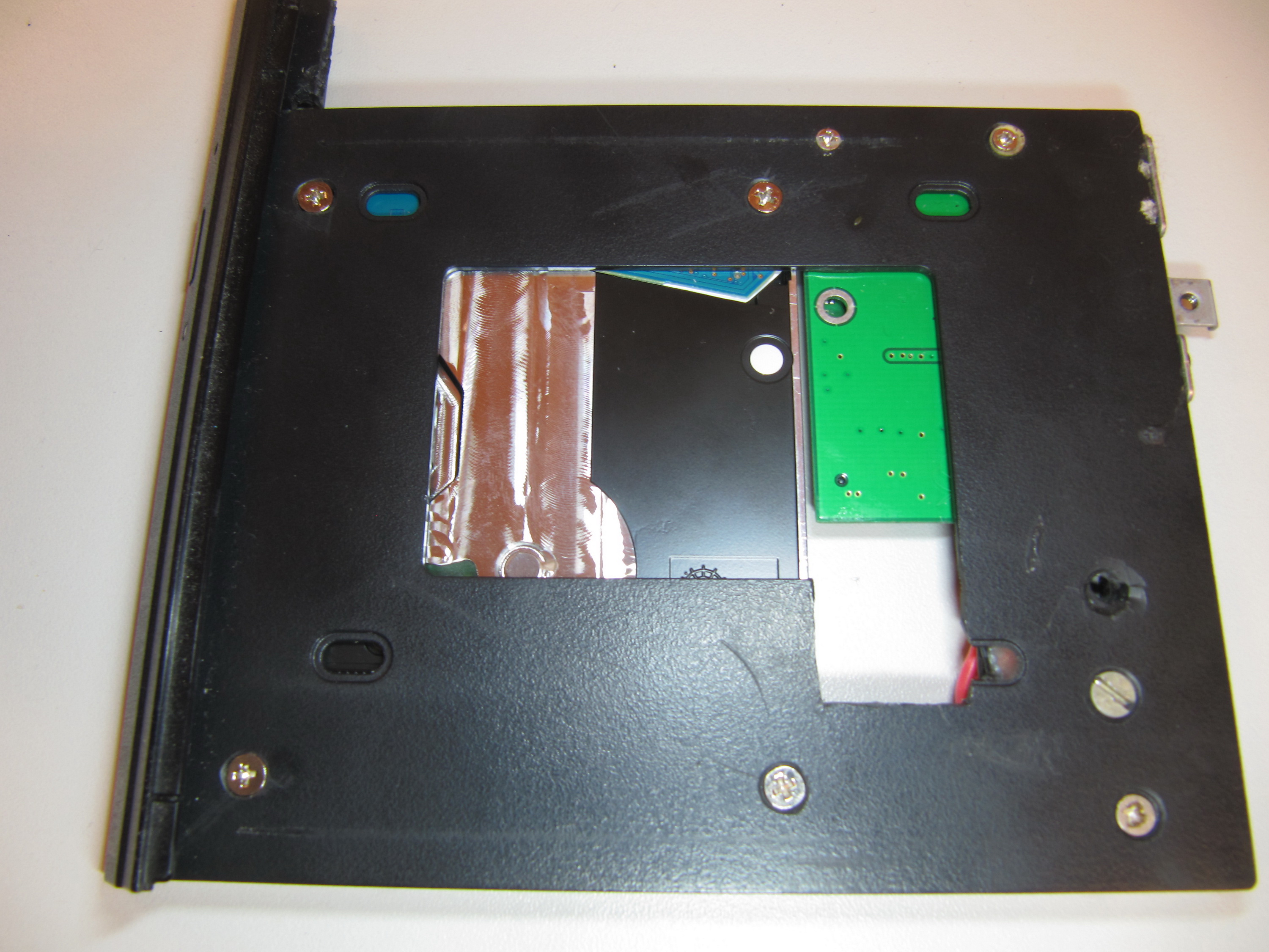

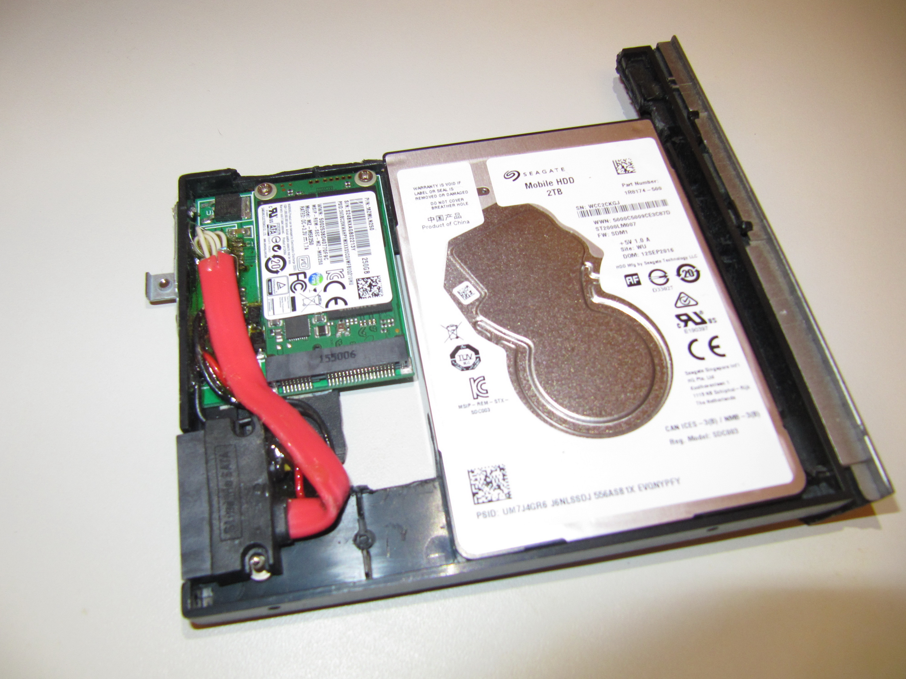

Take the caddy box and move off everything from plastic. Cut the plastic box like on the photo and cut off all of webbings inside of the box.
Before a wanted to use the Slimline 13 pin SATA Male to 22 Pin SATA Female Cable Adapter wholly, but it was impossibly to install into caddy box. The place is not enough. I just cut the cable and soldered it to mSata adaptor.

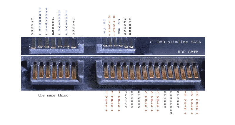

I soldered off the connector 22 Pin SATA from mSata adaptor too.  I used a schematic below:
You need use countersunk screws to fasten HDD, mSata adaptor and Slimline connector.
I cut off cable from bluetooth module and soldered cable with USB to Sata adaptor.
But bluetooth module has 3.3 V only and I took 5 V from motherboard.
The bluetooth cable has the same color of wires like a USB to Sata adaptor.
A first time I used the HDD Samsung 9.5 mm thickness but it was very difficult to set into laptop and I was afraid to broke something. I bought HDD 2 Tb Seagate Mobile ST2000LM007 7 mm thickness.

invait53 this looks really interesting, so you connect SSD to Slimline-SATA and HDD to Bluetooth port, right? To be honest, I really don't get it how you connect SATA to that bluetooth thingie :))
Btw. it was good to know that you can get +5V from the Mobo in this way, I could use that for my extra cooler instead of occupying USB ports. How did you know that there is +5V at that exact spot?
