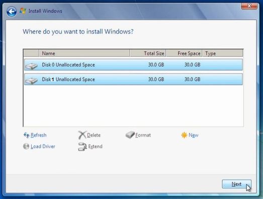

  5. Inside installation make sure to delete all partitions so that you end up with two unallocated disks (disk 0 and disk 1)
  6. Install Windows 7 one of the unallocated drives, for me disk 1 worked whilst disk 0 didn't (can’t explain why, but I guess it has to do with the RAID setting from BIOS).

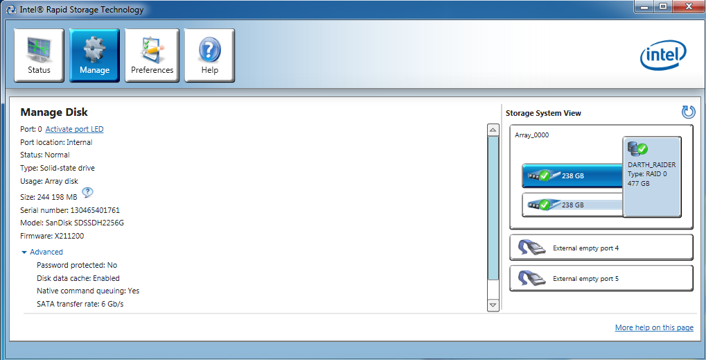

  9. Now it's time to create our RAID-array. Install RTS (Intel’s Rapid Storage Technology) from HP or Intel website. I took my RTS from HP's 2570P drivers archive.
  10. Under “Create” tab: You can create the RAID-array, choose RAID 0.
  11. Setting Stripe size? This is something I forgot to do and had to settle with default 32KB. I’m happy with it so I don’t really care. In other words, I have no clue what's preferred.
  12. Press next and wait some 30 minutes or so in order to migrate data from (in my case) disk 1 to disk 0.
  13. You’re done! Now it should look something like my "Darth_Raider" =)

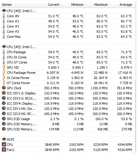

would You do 3dmar11, performance preset and attach HWinfo photo taken after test? Im interested in temps, CPU Fan and clock frequencies :)
Typically I see 48-50C throughout the day, with 15+ Firefox tabs, Foxit PDF viewer, a few MS Word docs open, and some other programs. If I use shoveaffinity then I can get the temps a few degrees lower, between 40-44C, depending on ambient temps.

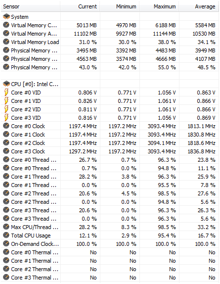

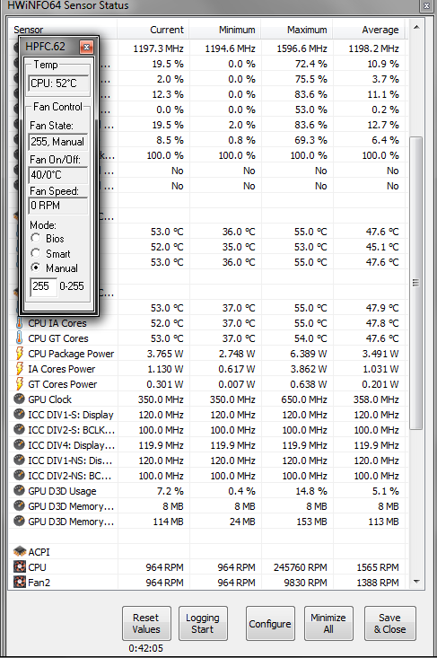

Here's the screenshots you requested:
Let me know if you need anything else!

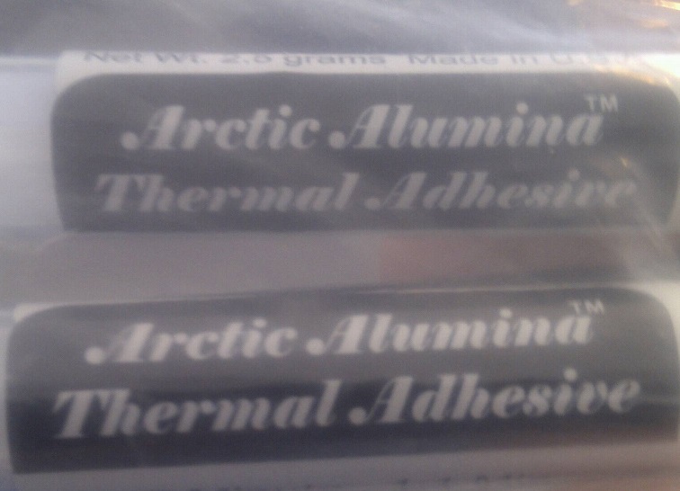

I have ony one issue, I cant find adhesive compound in Poland :(
@bjorm, what about this?
In Poland people smarter than me, said that they aren;t the same --> ARCTIC SILVER ALUMINA KLEJ TERMOPRZEWODZACY (5g) (3507452909) - Allegro.pl - Wi
but they sounds like the same...
EDIT: UP
ok, they are the same.

Hmm that's weird I've no problem running 3DMark11/10.Vant/06 with my 3820QM, using 65W adapter. I use eGPU for graphics but there is still a lot of tests for CPU only, and only crashes I've ever had was due to a weak eGPU power supply.

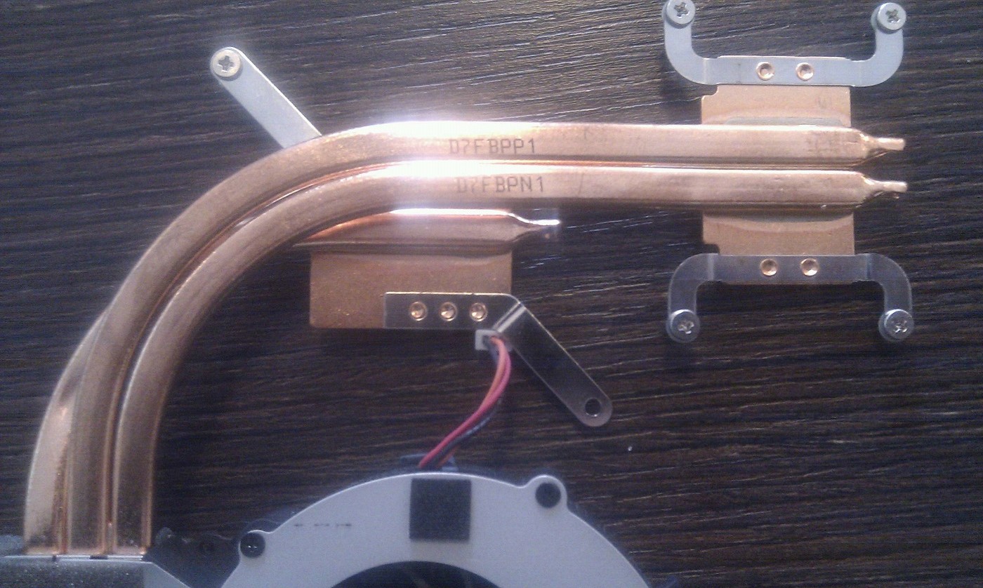

Yes, focus on the heatpipe and you gain the best results. I was gonna wrap it with a sheet of pyrolytic graphite but it's super expensive, so probably just copper instead. Also, if you sand/cut a section on the top of the heatsink to expose a portion of the pipe directly above the CPU, you may then slap a thick 3-4mm sheet of copper on it and further slash the temps. That's my next step after IPS project.

...Also, if you sand/cut a section on the top of the heatsink to expose a portion of the pipe directly above the CPU, you may then slap a thick 3-4mm sheet of copper on it and further slash the temps...
That is exactly my plan, but instead of just copper I'm gonna add a heatpipe instead.

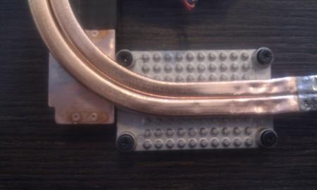

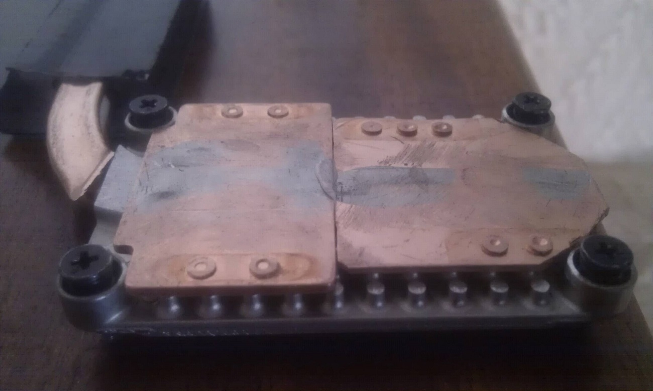

Do You mean to cut this part and put bigger and longer one?
Im going to dismantle this parts and glue them to the top (where jacobsson put pennys) and second plate will go area where heatpipe is bent.
Do You think that's proper way?

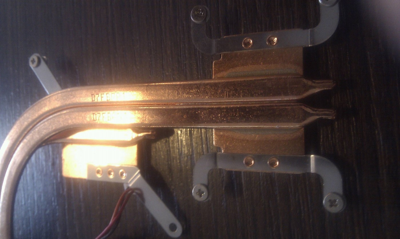

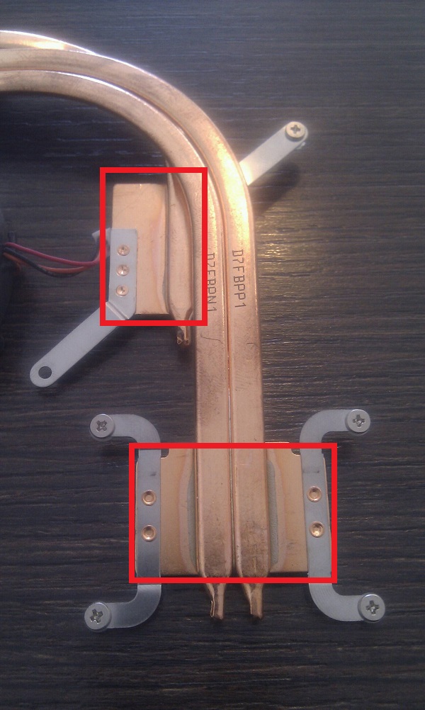

Ok, I need to choose one option. Which one is better in your opinion?
1) two plates covering almost whole area above CPU + added hetpipe on bending area.
2) two, oryginaly glued heatpipes on the middle of CPU plate + one plate on heatpipe bending area (Im aware that in this dimension on photo there is no option to fit it).

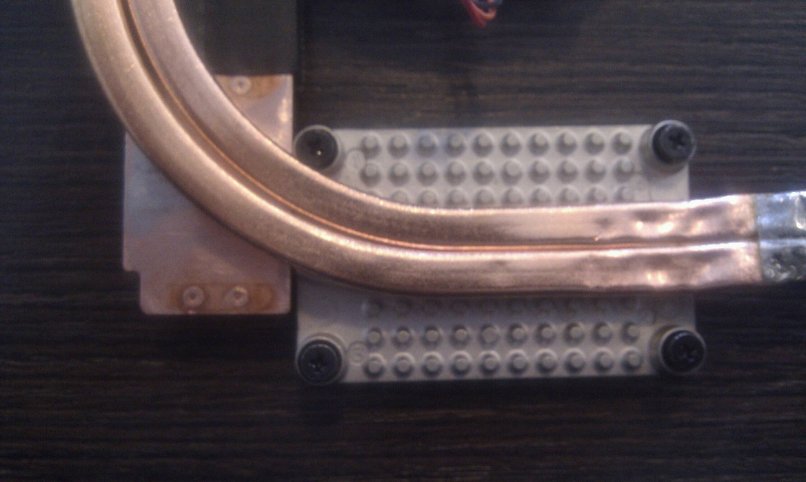

That would be even better but more work and easy to ruin the heatsink, I already destroyed a couple and about to order one more, lol
[ATTACH=CONFIG]8844[/ATTACH]

IMHO, it would be perfect if we could remove the original pipe and replace it with a 8-10mm one but the radiator part can't be easily modded. Now, the problem with putting a second pipe is that you can't efficiently dissipate heat from it. If you glue it to the radiator, like I did initially, it would create a bottleneck there since the radiator is too small for that. So it's either directing the second pipe somewhere else and gluing a lot of copper at its end (would probably work but still requires a lot of work), or expose as much of the original pipe as possible and gluing copper on it, similar to the copper coin mod but with more copper and coverage. There may also be a way of installing a more powerful fan or even an extra (smaller) fan.

I'd choose option 2. But would sand the top of the HS first so that there's no extra layer between the original and added pipes. Don't sand all of it, just maybe half. Also measure everything first, you might need to sand the top of the radiator too and disassemble the machine when mounting the new heatsink.

nice! but there is something strange. few days ago I noticed strange sound from fan. With constant fan lowfrequencies noise there is something else, like some electric squek. I didn't hear it after first diode soldering. After soldering second diode there is still this strange sound. I started to checkin source of it, by listening to fan with bottom cover and without it. When there was no cover, sound dissapeared. So I concluded that fan moves some his vibrations to cover, because of diode between fan and cover plate. I tried today to solder additional wire to fit two diodes behind the fan, to avoid stick between fan and plate. Even after fitting a diodes between fan and SSD case, strange sound appears after bottom case is in its place. Its extremely weird. I cant find where is the reason of it. I was wondering if it is strange caused by currents but its impossible cause this sounds appears only when plate is closed. I don't have idea to overcome it.
Its minor problem cause it's regnosible only when there is no ambient sounds, so only at night.
After diodes mode I glued my heatsink. I decided to use option 1 and final is like this:
Im not sure if there is any bigger improvement but I got maximum 69C in 3dm11. Without modded heatsink there was 75C. Maybe thermal paste is not ready(?), I used Zalman STG-2. But maybe 6C is not bad, is it? :)
For now, I've been usng laptop for 40minutes with completely turned off fan and I have something like this.

Here are results.
[ATTACH=CONFIG]8855[/ATTACH]
I soldered second diode and I got:
255 = 0
200 = 2363
128 = 2363
120 = 2363
110 = 2386
100 = 2457
90 = 2761
85 = 2891
80 = 3110
75 = 3276
70 = 3510
65 = 3723
60 = 4096
55 = 4551
50 = 5015
45 = 5228
40 = 5228
25 = 5228
0 = 5228
[ATTACH=CONFIG]8854[/ATTACH]
[ATTACH=CONFIG]8856[/ATTACH]
Another case, during writing this post, I got almost full battery, and suddenly I was given message there is only 7% left, when I plugged laptop to adapter, I saw 69% left. Could it be caused by fan modes?
Wow, good job! So you cut out part of the radiator to mount the second pipe so it's sitting flush? Nice! But do you think it's safe to cut the pipe itself? Wouldn't it reduce its efficiency?
As for the battery status report, dunno, maybe that's your fan modding but I fail to see how it's related.
I've seen 5C when going from a thermal pad to Arctic Silver, so you may be in that boat. You could see reduced temps in the future, I know that arctic silver needs up to 200 hours to fully set. I tried looking for instructions at Zalman's site for your paste but I couldn't find anything useful. For the battery issue, I had that about 2 weeks ago. Fixed it with a system restart and haven't had issues since.

Wow, good job! So you cut out part of the radiator to mount the second pipe so it's sitting flash? Nice! But do you think it's safe to cut the pipe itself? Wouldn't it reduce it's efficiency?
No no, I just put a second, short heatpipe on the top of original one (I didn't decide to put another one on the bottom), so there is original one and new one doesn't enter the radiator.
