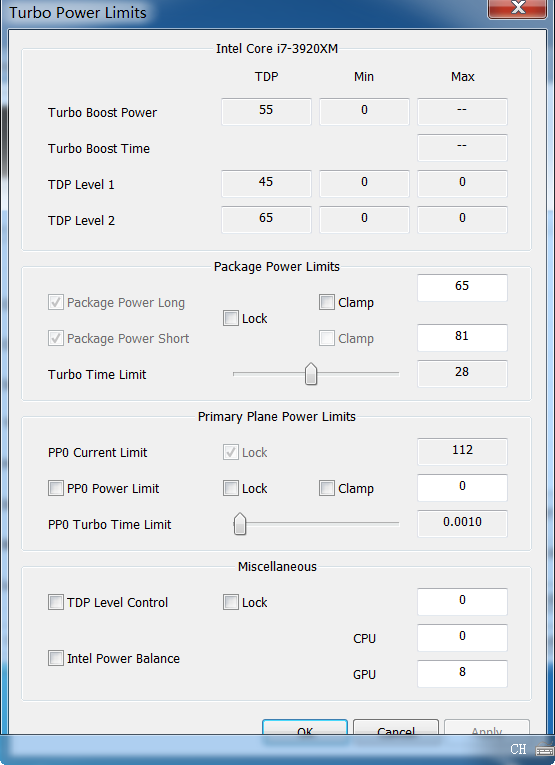

These days I found CPU webstores to replace 3610qm and took reference of Tech Inferno Fan's CPU Benchmark. 3740qm, 3820qm and 3840qm benchmark were already existed, so I decided to try the 3920xm. 3920xm frequency is closed to 3840qm, but 3920xm TDP is up to 55w, and 3920xm es is 100rmb($16) more expensive than 3840qm es in our country. I spent 3610qm + 600rmb($96) to exchange 3920xm es, but now i think i made a wrong decision. I will share the throttlestop test between 3610qm and 3920xm. i7-3610QM SR0MV i7-3920XM QC22 ES [ATTACH]11317[/ATTACH]

@pandaleo, nice investigative work that I've added to the i7-quad TDP results. It's a shame that your i7-3610QM to i7-3920XM ES only netted you an extra 100Mhz.
Which begs the question: why isn't your 55W i7-3920XM (ES) is also being limited to the same 45W that i7-36xxQM, i7-37xxQM and i7-38xxQM cpus see rather than 55W. Can you take a screenshot of the Throttlestop TPL screen like shown below? Is it because it's an ES CPU and also runs at 45W? FYI: While I could adjust those settings in Throttlestop they had no effect with my i7-3740QM - I've always been TDP limited to < 45W.
Also, what is your system spec and list of mods? I'd like to add you to the table on the first post. Consider adding those details to your sig.
