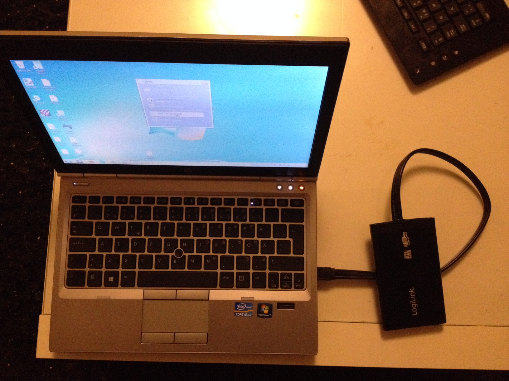

Introduction
- Just convenient!
Ever since I installed my SSD raid my original HDD has just been laying around collecting dust.
I like the thought of being able too boot a secondary OS from the hard drive w/o messing with my raid config,
Personally there are a couple of applications that immediately comes to mind:
  • Secondary boot option: For a while I really wanted to test out Win8.1, maybe and even OSX,
  • Pretty fast file transfers: Look at the results
  • The notoriously large steam folder?
Now I need to find a mSATAp to USB3.0 adapter that actually works!
Instructions
What do I need?
Installation

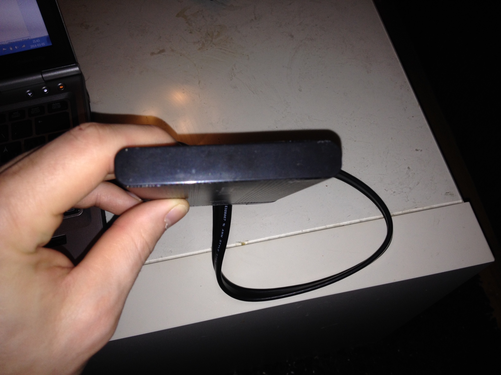

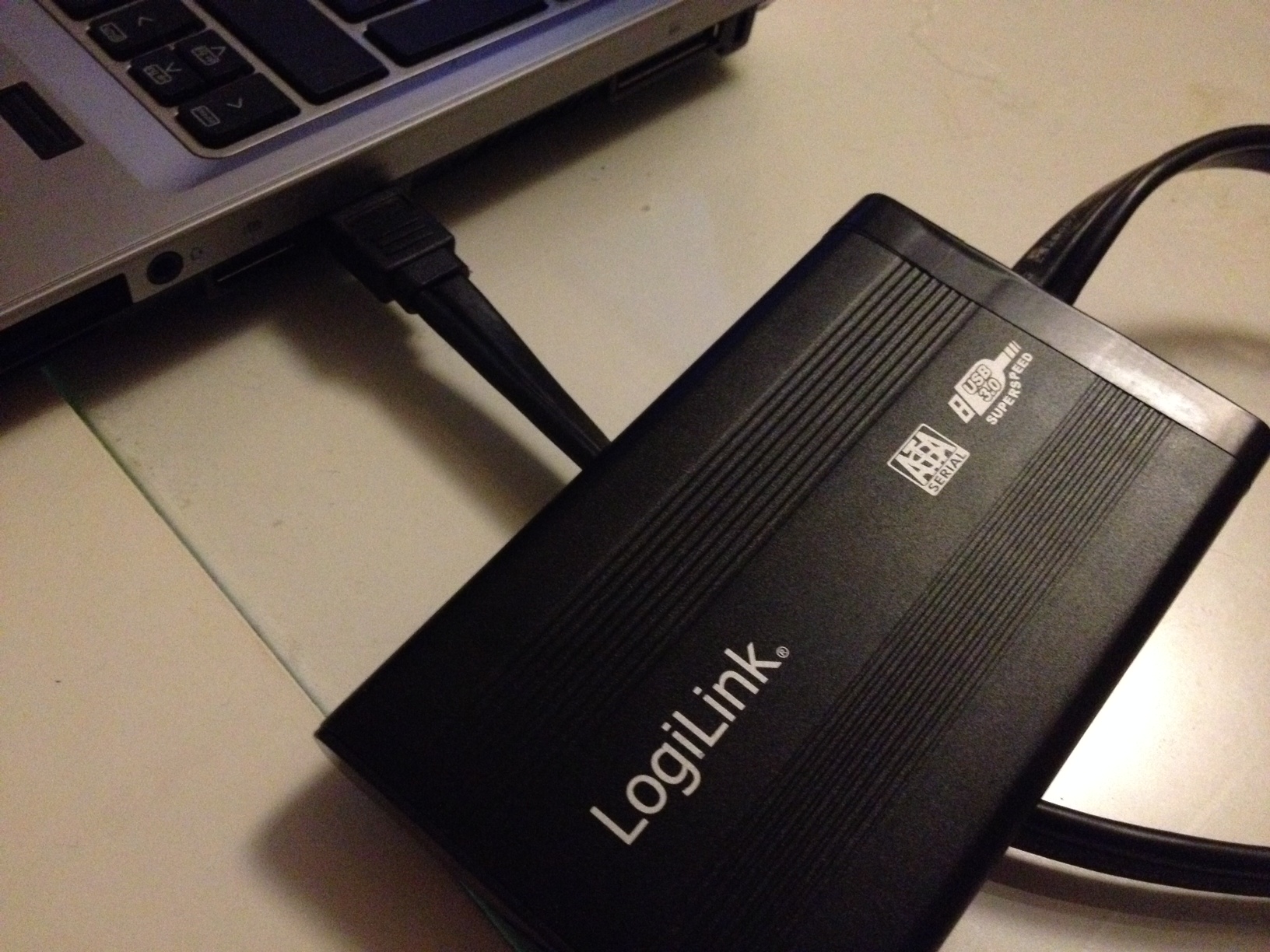

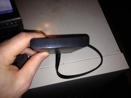

  1. Remove the USB-interface completely from the enclosure (leaving an open end)
  2. Connect the eSATA cable to HDD

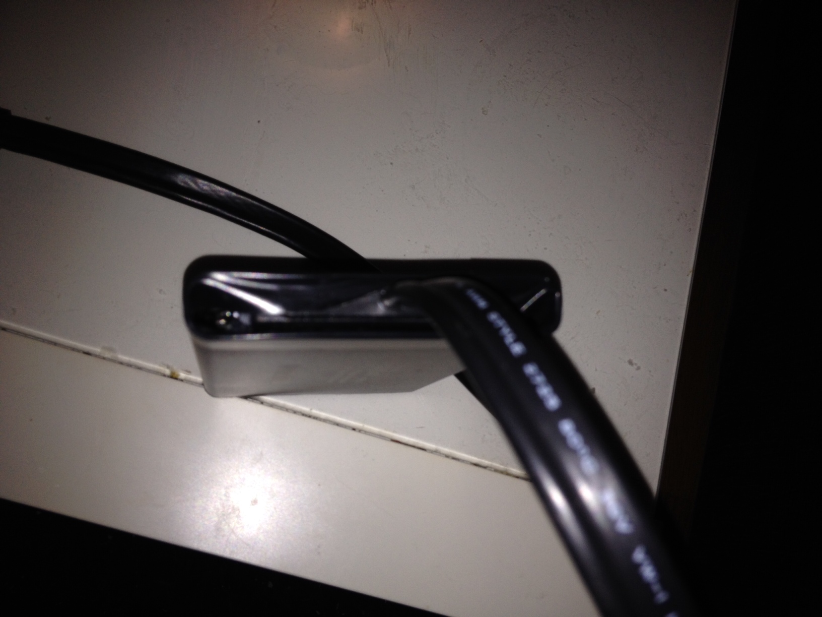

  3. Wrap each short end of the HDD with a cut out stripe of bubble wrap and secure it tight with electrical tape
  4. Now the HDD should fit real snugly into the enclosure (should be a little struggle)
  5. Thats it!
  6. IDEA: By carving hole for the eSATA cable in the unused USB face plate you can make this even nicer!
Results
The enclosure:

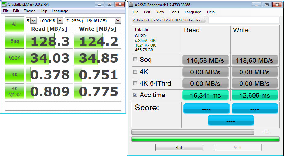

eSATA benchmark: AS SSD & CrystalDiskMark
USB 3.0 benchmark: AS SSD & CrystalDiskMark
in progress

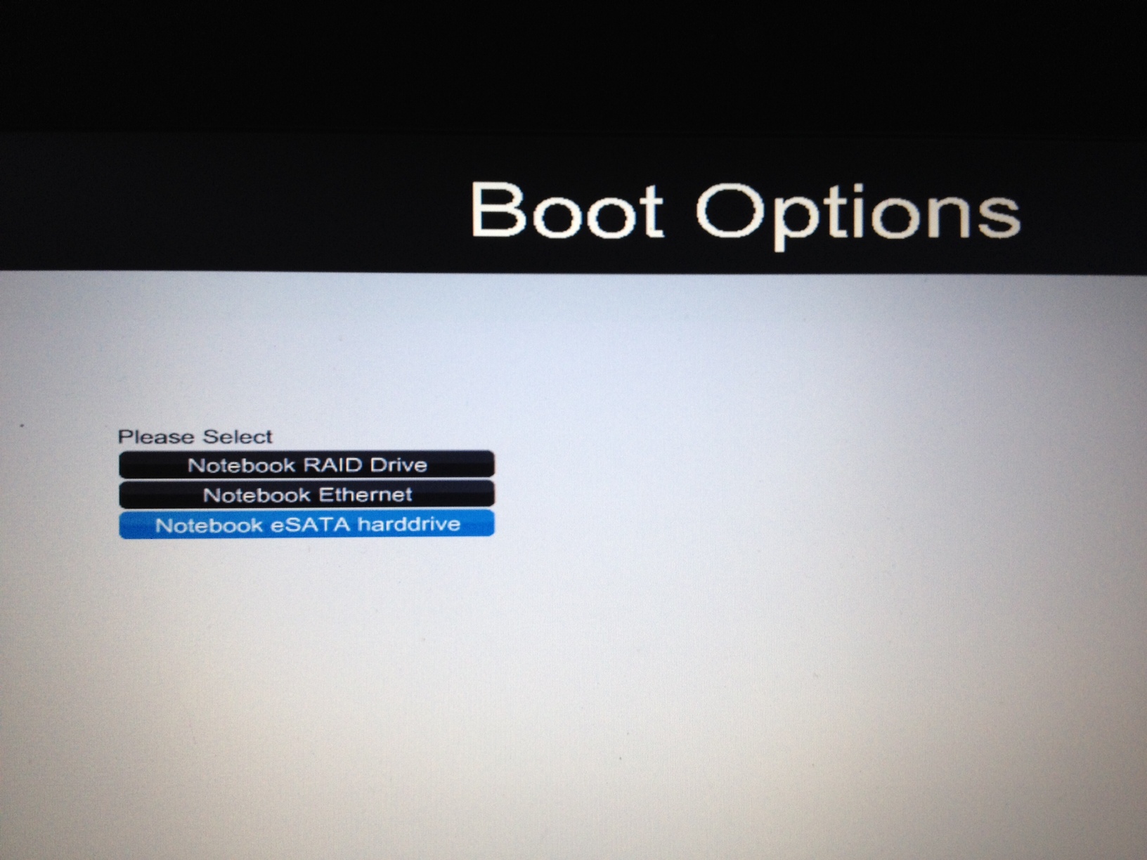

Interrupted boot: You can see that our system is capable of eSATA boot
eSATA OS boot:
in progress
