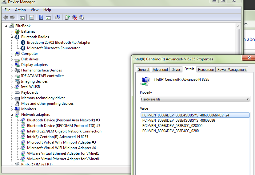

I dug out my ES 6235 and did some tests. The laptop booted into Windows without issue, it just had to install the 6235 specific drivers. The BIOS doesn't give any hassle or show any nag screens like if you had a non-whitelisted device. Here's some screenshots:
I'm not sure why this one works vs a regular 6235, as the vendor and HW IDs are the same as a regular 6235 (at least what I could find on the internet) and are not on the whitelist. Maybe an upgrade path for people who want new wifi cards. There's Intel 7260 cards on ebay for 17.80 US, maybe worth a gamble for someone. Worst case, throw it in your desktop with an adapter.
[ATTACH=CONFIG]9170[/ATTACH][ATTACH=CONFIG]9171[/ATTACH]

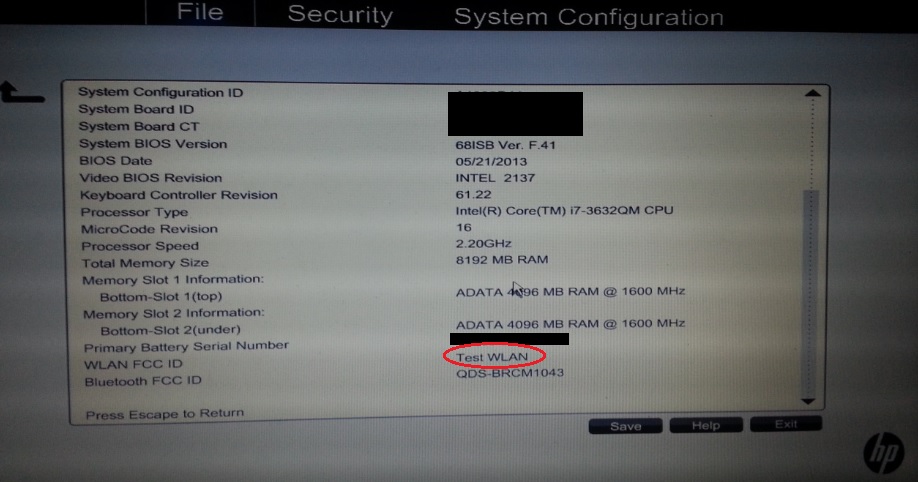

Worst case, please keep the WLAN disabled whitelist in future BIOS updates. I just tried an Intel 1000 and Atheros AR5B91 I had laying around. Both showed in the BIOS as TEST WLAN and showed in Windows. Safe to say that the whitelisting is broken or disabled.
wifi whitelist bug: BIOS programmer error or generous easter egg?
Thanks for posting this which inspired me to test a Intel 5100AGN I had laying around from a 2530P. Managed to trial install the full-sized card into the half-sized 2570P wifi slot by having it lean on an angle. I too got it detected and working without any bios nags. I too see a Test WLAN bios info item instead of a FCC ID as shown in the spoiler:
