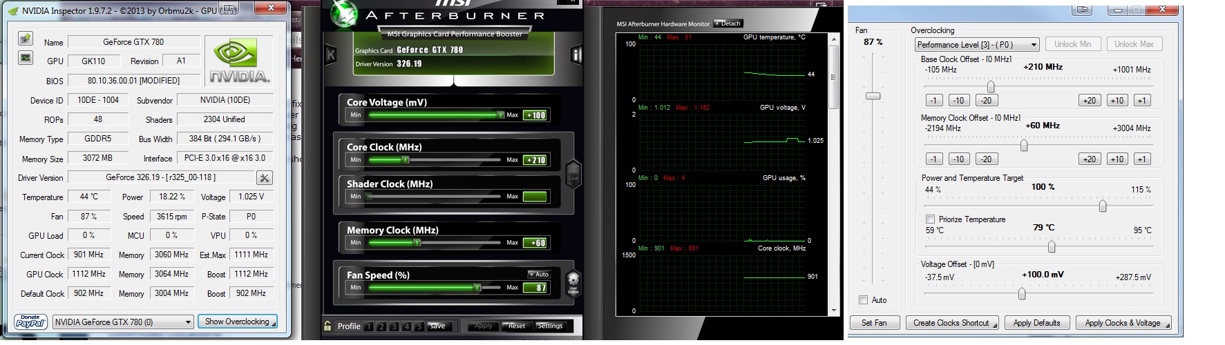

Gurkburk Posted July 29, 2013 Share Posted July 29, 2013 Well... can't help you if you give zero information. What kind of system do you use? Card? Vbios? Etc....Sorry, was tired when i wrote it.According to GPU-Z my Vbios is 80.10.36.00.01. And my G-Card is a GTX 780.Tell me if these stats are right in Afterburner: I've got 205+ and my coreclock goes to 1097, does that seem right? And my Core volt at +75 and goes to 1.162.But it seems like turbo is still on? as it bounces up from 900Mhz to 1097Mhz, but it seems like it's more Active than before? Or is that just how it should be after Flashing it ? Quote Link to comment Share on other sites More sharing options...
svl7 Posted July 29, 2013 Author Share Posted July 29, 2013 Which vbios did you flash? Are you sure you actually flashed it? Please post a screenshot of nvidia inspector showing the OC stuff. Quote Link to comment Share on other sites More sharing options...
Gurkburk Posted July 29, 2013 Share Posted July 29, 2013 Which vbios did you flash? Are you sure you actually flashed it? Please post a screenshot of nvidia inspector showing the OC stuff. Here you go. Quote Link to comment Share on other sites More sharing options...
svl7 Posted July 29, 2013 Author Share Posted July 29, 2013 Boost should be gone. Unless they changed something in the drivers...The vbios is definitely flashed. One thing you could try is a CMOS reset, but I doubt it will change anything since the flashed vbios shows up in the OS.I only have a Titan for testing, and there it's definitely gone, at least with 314.22... maybe another 780 user can give some insights. Quote Link to comment Share on other sites More sharing options...
