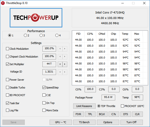

EDk-TheONE Posted March 5, 2016 Share Posted March 5, 2016 another interesting record: 4.4 GHz on 4710HQ @ 1.3 Volt 96 Watt TDP!Jump from 50 to 98 after 1 Second! WTF!http://valid.x86.fr/n7faqc Quote Link to comment Share on other sites More sharing options...
Arise Posted March 5, 2016 Share Posted March 5, 2016 Not that bad but it is supposed to do at least 4.5GHz with a little bit of cooling help according to Dufus. Did you tried to repaste it already? The voltage you set was with the offset or fixed? Quote Link to comment Share on other sites More sharing options...
EDk-TheONE Posted March 5, 2016 Share Posted March 5, 2016 my notebook repast with liquid ultra. i am planning to modify EC to run fans @ max speed. did you about know fans wire: balck,red,brown,yellow. it seems for max fan some pin/wire must be disconnected or shorted. adaptive voltage 1.3008 volt without offset. Quote Link to comment Share on other sites More sharing options...
