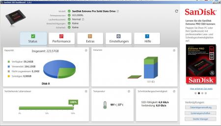

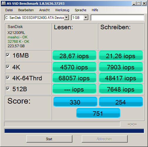

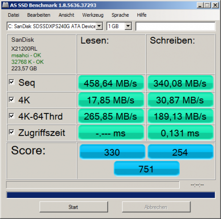

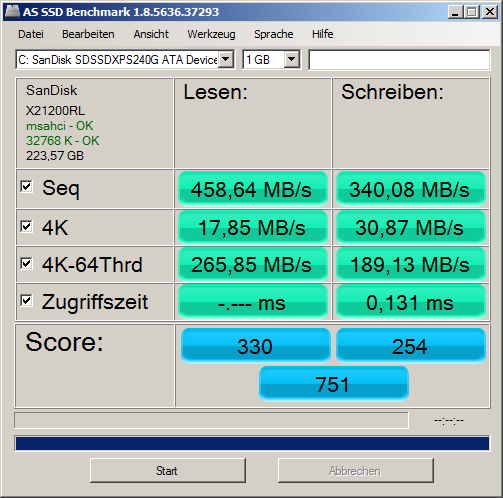

Well for SSD's i don't really know but transferspeeds are not that important..... they are usually fast enought its more about iops :-P Doesn't look too bad for a used and filled ssd to the rim, if you leave some more space it runs on cocaine ( nCache runs flash cells as slc does some funny caching ) I can see on my own screen shot that i had 40Gb+ free thats no more, dang i need to delete some games. The last time i checked your ssd type BX100 was Bargain/economy class and with these numbers i would be more statisfied, it destroys any hdd thats more than enought..... For my experienece i have to say that my Samsung 840 Pro 256GB feels fast at work (Z77 corei5, Sata 6 on an Asrock board), but the sandisk is faster but not if you fill it hard to the rim. I am sure theres a tool for your BX100 to maintain firmware and health that should tell the right link speed read from the ssd itself. @Tech Inferno Fan When i ran the bench, "sandisk ssd dashboard" complained not to run benchmarks with windows drive caching turned on and that it doesn't like the current benchmark software and will turn off some of its boost features :-P -

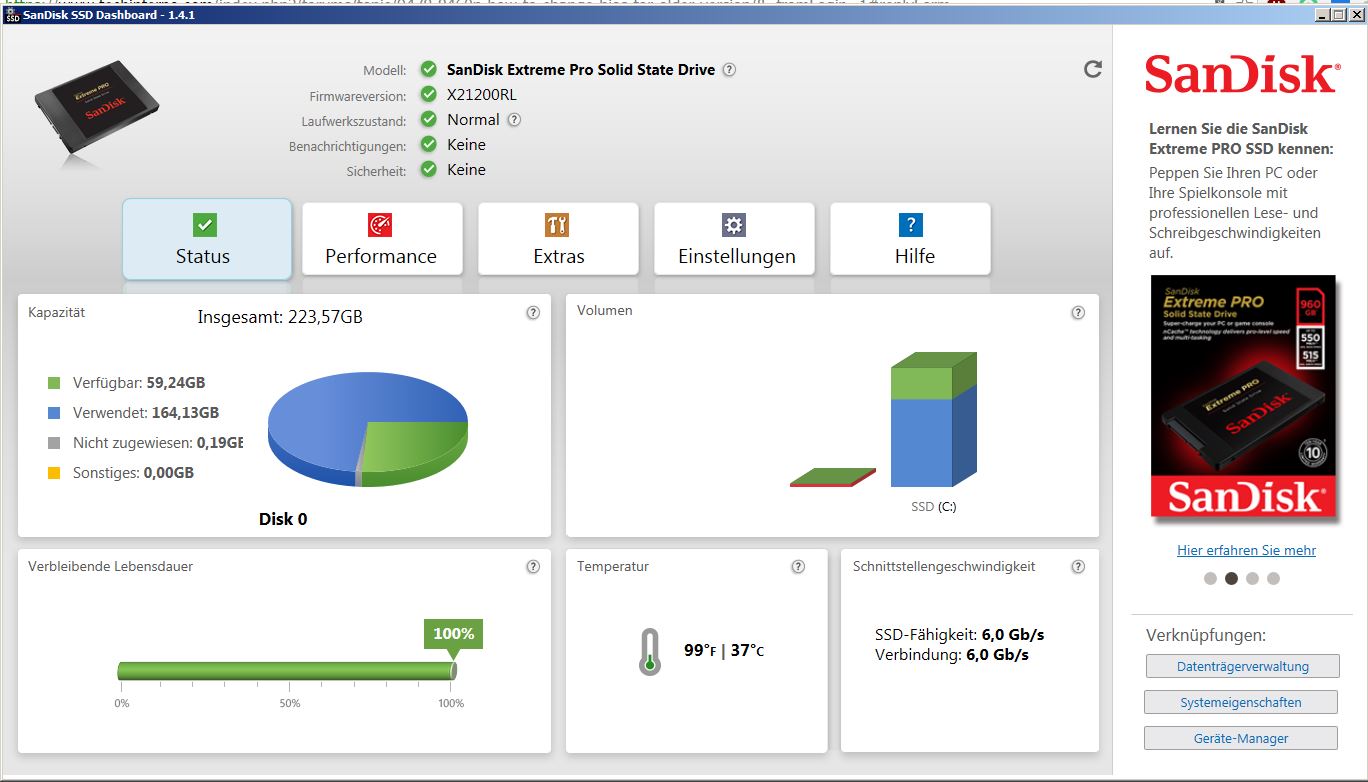

Can i bios dump from my 8460p and share with some software? 68SCF is indeed 8460p Bios at least for mine, and i can confirm that a Sandisk Extreme Pro 240GB Model does run with sata 6 according to its own tool. @TBlazer: Maybe you can find the hp spXXX.exe and extract something that is flashable? ftp://ftp.hp.com/pub/softpaq/sp62501-63000/sp62738.html says it is F42 inside sp62738.exe Ok downloaded it its too big for this forum aww shwt well here you go: Checksum md5:FDB66D9C3EBAA899D0A67C9496B57C24 http://hopiberg.bplaced.net/68SCF8.F08.zip @Tech Inferno Fan: Add it to your personal collection of bioses :-P -
