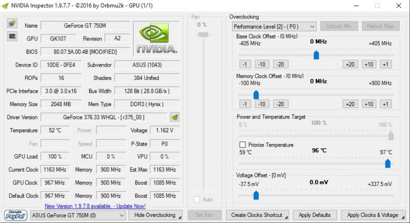

Hello.
Any chance somebody could modify my vbios? Laptop N550JV, gt 750m, work in UEFI mode.
I need unlock limit +135MHz, unlock voltage.
Thanks in advance!
vbios.rom
  • Bios Modder

Hi!
This is for you.
vbios.rom
Edited by Klem
5 hours ago, Klem said:
Hi!
This is for you.
vbios.rom

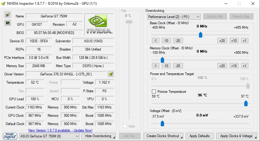

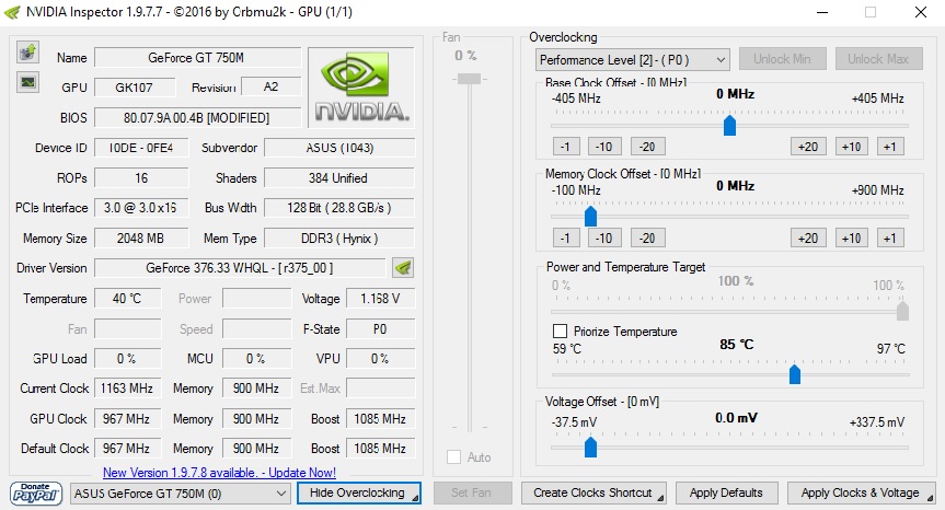

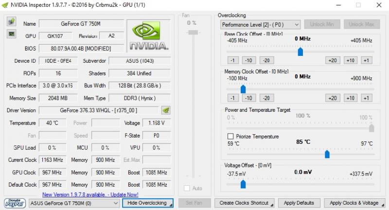

Hello, Klem!
Thanks you.
You'r mod works. Limit +135MHz is disabled, but voltage don't increase. Then I start stress test, voltage increased for 1.680v then drop in standart value voltage 1.620v. I increase voltage in nvidia inspector, but nothing changed. And You changed Memory clock 1000MHz in vbios, this clock don't apply.
  • Bios Modder
As you can see on the screenshot, the voltage slider unlocked. For any voltage changes you should just move voltage slider to the right side more then +100mV.
But i think that 1163MHz very nice result for your GT 750M.
I have 1293MHz core and 1175MHz memory without vbios mod on standart voltage, temp 67-68 aida stress test 30 min.
Before mod, voltage slider was unlocked, but when I move slider to the right and apply was nothing change.
  • Bios Modder
3 minutes ago, Denis231085 said:
I moded cooling system my laptop and I want more)))) So how can I increase voltage?
Limit 1.200V
Edited by Klem
