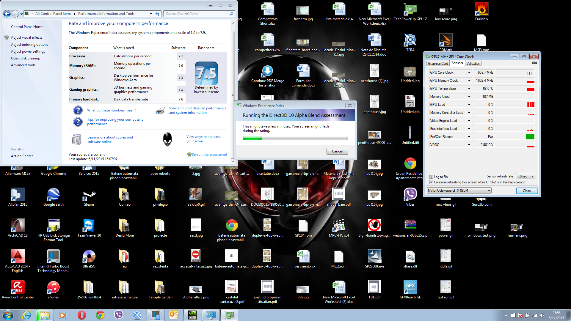

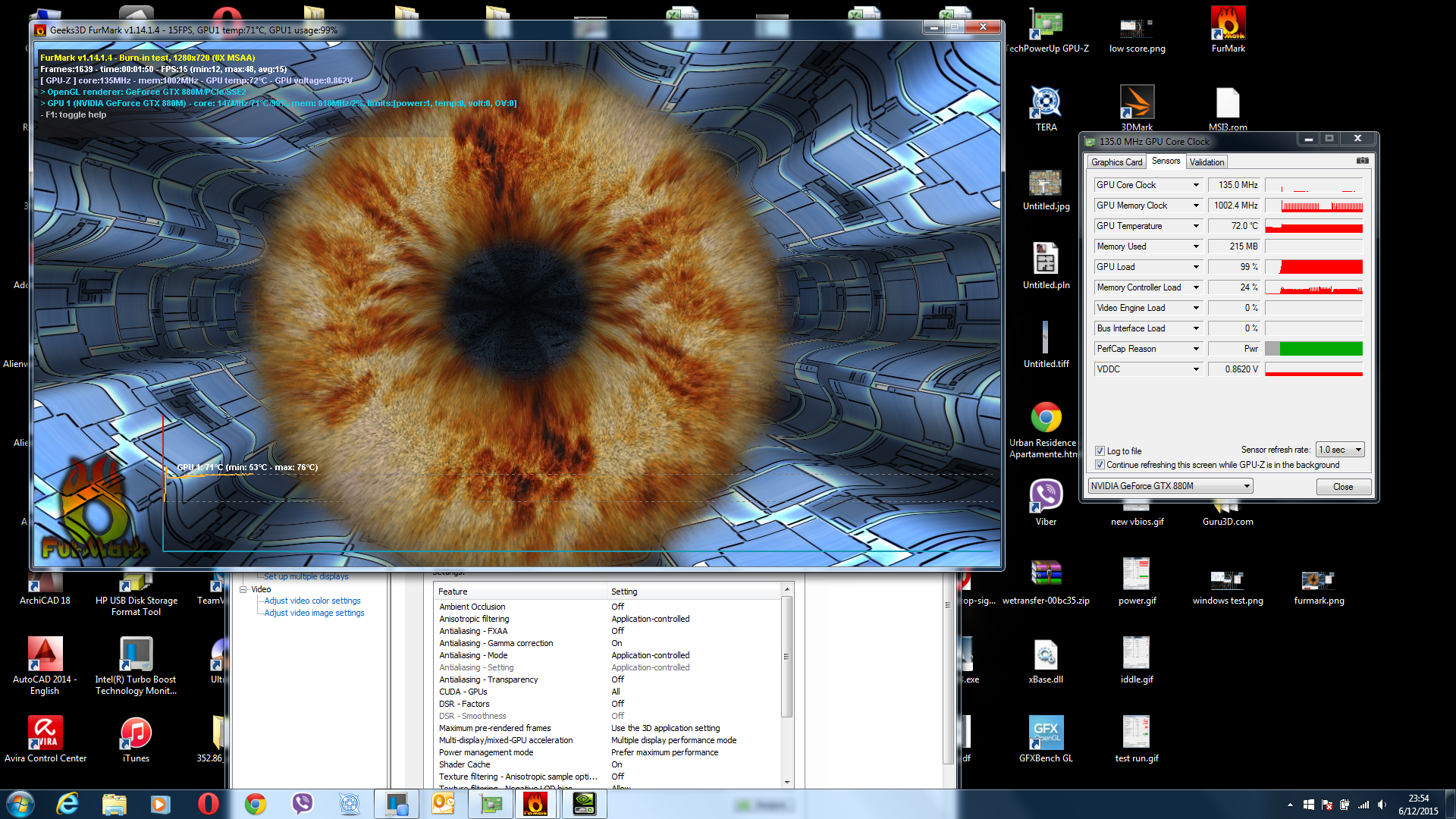

Robbo Posted June 13, 2015 Share Posted June 13, 2015 the same [ATTACH=CONFIG]15229[/ATTACH][ATTACH=CONFIG]15230[/ATTACH] I don't think you listened to my post, you have temperature problems (amoungst other issues) with your card. GPUz is showing about 70 degC when idle in some of your previous screenshots - that's too high. Investigate repadding your heatsink like I mentioned to you in my last post. Secondly, don't use Furmark to validate what's happening with your cards - it's a power virus & NVidia automatically throttle the cards when they detect it running, so it's just not a useful test. Thirdly, your card is behaving weirdly with throttling clocks, I suggest you revert to the stock vBIOS you were using then retest things like 3DMark11, etc, while monitoring your clocks & temperatures with GPUz. Actually, reverting to the stock vBIOS you had is what I would do first, then I'd test 3DMark11 while using GPUz, and depending on the results and what you saw in GPUz I would then repad the card. Klem gave you some good advice about how to install the NVidia drivers properly using DDU. EDIT: did your card ever work properly when you were using the stock vBIOS? If it didn't then there's probably other reasons for why your card is not working properly, like too much heat, but you would need to show that using GPUz when at load. Quote Link to comment Share on other sites More sharing options...

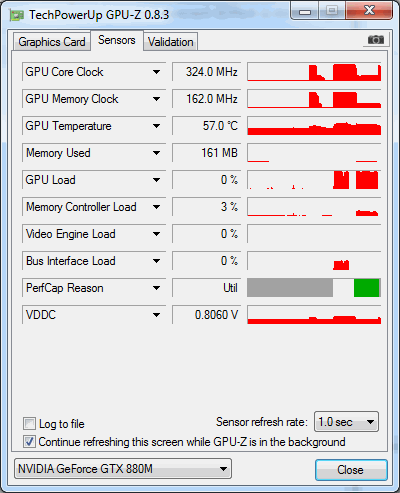

Kedawg Posted June 13, 2015 Share Posted June 13, 2015 using 3dmark 11 and stock vbios... i have tryed all tips that you guys gave me .... nothing. now the card it is staying in 54 and doing anything. when using 3dmark i noticed that when the first benchmark is starting i have 50 fps and after 1 sec it drops to 20 ~ 14. At the same time when it drops gpuz is showing perfcap reason PWR and green bar.... the max temp was 80. i repasted cleaned and change thermal pads.... Quote Link to comment Share on other sites More sharing options...
Robbo Posted June 13, 2015 Share Posted June 13, 2015 [ATTACH=CONFIG]15235[/ATTACH]using 3dmark 11 and stock vbios... i have tryed all tips that you guys gave me .... nothing.now the card it is staying in 54 and doing anything.when using 3dmark i noticed that when the first benchmark is starting i have 50 fps and after 1 sec it drops to 20 ~ 14. At the same time when it drops gpuz is showing perfcap reason PWR and green bar....the max temp was 80.i repasted cleaned and change thermal pads....Good stuff. That's very strange though, Perfcap PWR means that it thinks it's reaching the TDP limits of the vBIOS, but that shouldn't happen during 3DMark11 and shouldn't make the clocks throttle dramatically while at 100% load as is shown in your GPUz screenshot. Some of the latest drivers have proven to have weird power limitations & throttling issues with some systems, I suggest you try an earlier driver, try using DDU, and then install 327.23 drivers - it seems that those don't include any limitations based on this thread I found:https://forums.geforce.com/default/topic/754922/nvidia-crippling-the-gtx-880ms-with-there-new-drivers-look-for-a-nvidia-response-/I believe you should be able to use some of the later drivers with no issue too, but I have read that some of the latest drivers have been causing strange throttling problems, but I'd try 327.23 driver after a DDU clean to just rule out that it's not the drivers causing your issue. Yep, so install that driver & do the same testing, see what happens. Quote Link to comment Share on other sites More sharing options...

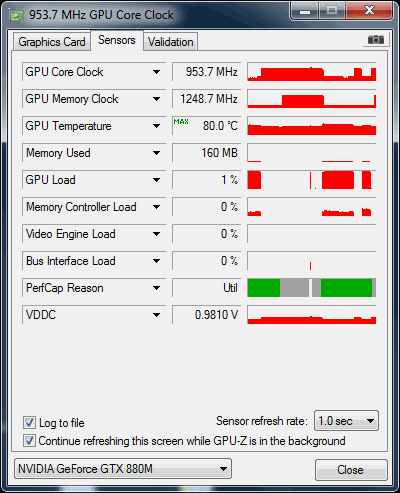

Kedawg Posted June 13, 2015 Share Posted June 13, 2015 fresh everything .... ans still like this... every time i start something that is demanding gpu ... perfcap reson pwr Quote Link to comment Share on other sites More sharing options...
Robbo Posted June 13, 2015 Share Posted June 13, 2015 [ATTACH=CONFIG]15238[/ATTACH]fresh everything .... ans still like this... every time i start something that is demanding gpu ... perfcap reson pwrDriver 327.23?? Quote Link to comment Share on other sites More sharing options...

Kedawg Posted June 13, 2015 Share Posted June 13, 2015 327.23 3dmark 11 6669 point. Now i think it is the tthermal throttling.... any idea where i can find i good gtx 880m headsinkSent from my SM-G900F using Tapatalk Quote Link to comment Share on other sites More sharing options...
Kedawg Posted June 13, 2015 Share Posted June 13, 2015 Well... the most of the time is thermal throttling and a some pwr throttling every now and then....Sent from my SM-G900F using Tapatalk Quote Link to comment Share on other sites More sharing options...

Robbo Posted June 14, 2015 Share Posted June 14, 2015 Well... the most of the time is thermal throttling and a some pwr throttling every now and then....Sent from my SM-G900F using TapatalkSo 327.23 fixed your power throttling for the most part (you could experiment using some of the later drivers too, to see which ones don't throttle but yet give you good game compatibility with the latest games). Your 3DMar11 score seems a bit low still though because I get the same score as you with my 670MX - might be the thermal throttling you mentioned. What was the Graphics Score you got in 3DMark11 (not the P score)? You should get in the region of 8500 for the Graphics Score.What card did you upgrade from - that will determine whether you have the 75W or 100W heatsink. The only difference between the two is that there is a bit more copper on the 100W heatsink, and less aluminium - they're both 3 pipe heatsinks. I'm using the 75W heatsink on my overclocked GPU, and it's fine, but your 880M will be drawing more power. I'd make sure you've got 580M/675M heatsink, part numbers found in the following thread, and you'll need to make sure you're using an NVidia X-bracket, as the post heights are different to the AMD X-brackets which will affect the amount of pressure received on your GPU core from the heatsink:*OFFICIAL* M17x R3 Owner's Lounge Thread - Part 3 | NotebookReviewThe heatsink part number I think you want is V1K2G Quote Link to comment Share on other sites More sharing options...
