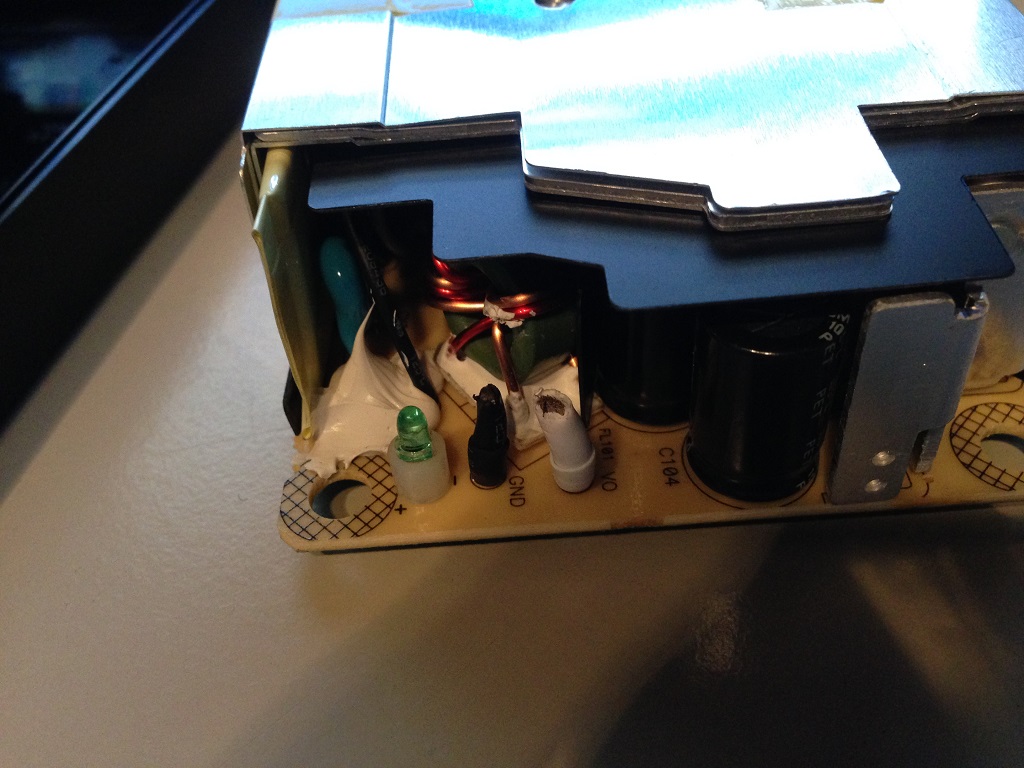

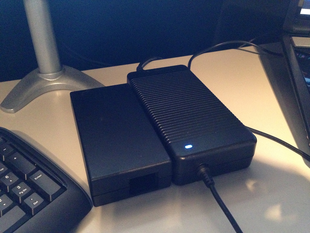

  9. Ok , so i had a hour today time and i got into the PSU . I screwed open the original psu and compared them how to wireing was with the Dell 230W psu . the both had : Msi GT70 0NE Original PSU -Ground Collor : Black - Vo Collor : White. Dell 230Watt psu -Ground Collor : Black - Vo Collor : White. - Remaining red wire ( you guys told me before it was a green or a blue one , but it was red ) So didnt solderd them of the PCB but just cut them in the mid lengte inside the psu and solderd the orginal cable tough it. fingers crossed and powerd it on ! YEAH BUDDY worked like a charm ! So then the Overclock where it all was done for . And it worked in combonation with Throttle stop . got at the OC 99% Gpu load. And went from everything @ ultra ( except A.A ) from 45 fps stock to 60 fps overclock ! I want to thank you for the fast respons ! Regards , Jean Pauul
  10. Does anyone has a link or can tell me how to cut the wire ? I have sleeved and made enough of my own cables on my desktop , so i have to tools to do it , im just not into laptop psu's If some one can give me a link or make me a picutre or something i would appreciate it . I have order a DEll 230 watt psu and recieving it tomorrow ! Regards , Jean paul
  11. Ah nice ! , cheers for the fast repley. The PSU that you linked is the same as in the dutch webstore ( i have there 2 coupons i can use so i get it for 40 euro ) If i do cut the wire ? how to do it ? do i need to go into the PSU it self or can i just cut the cable , strip it and resolder it with the right jack ?
