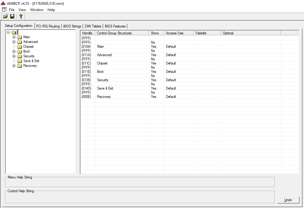

I've opened bios file but what to do next? Do You have an idea where is this option and how to unlock it?
Everything in column "show" is set to "yes" and in "access/use" to default - not only in the main menu (in the picture) but everywhere... Oo

Hello! I am trying to unlock the bios of MSI GT72 6QD. Latest version is: EC 1.09 and bios 1.18...
Opening in amibcp I see everything on "SHOW".. so I don't know exactly what to modify.. can you help?

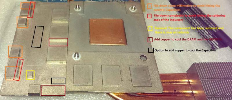

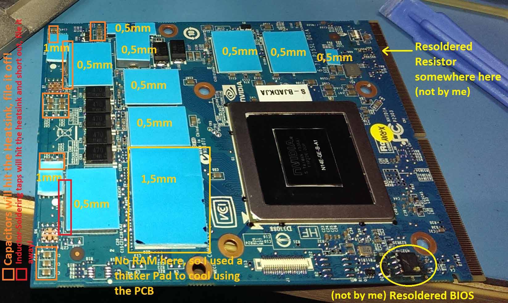

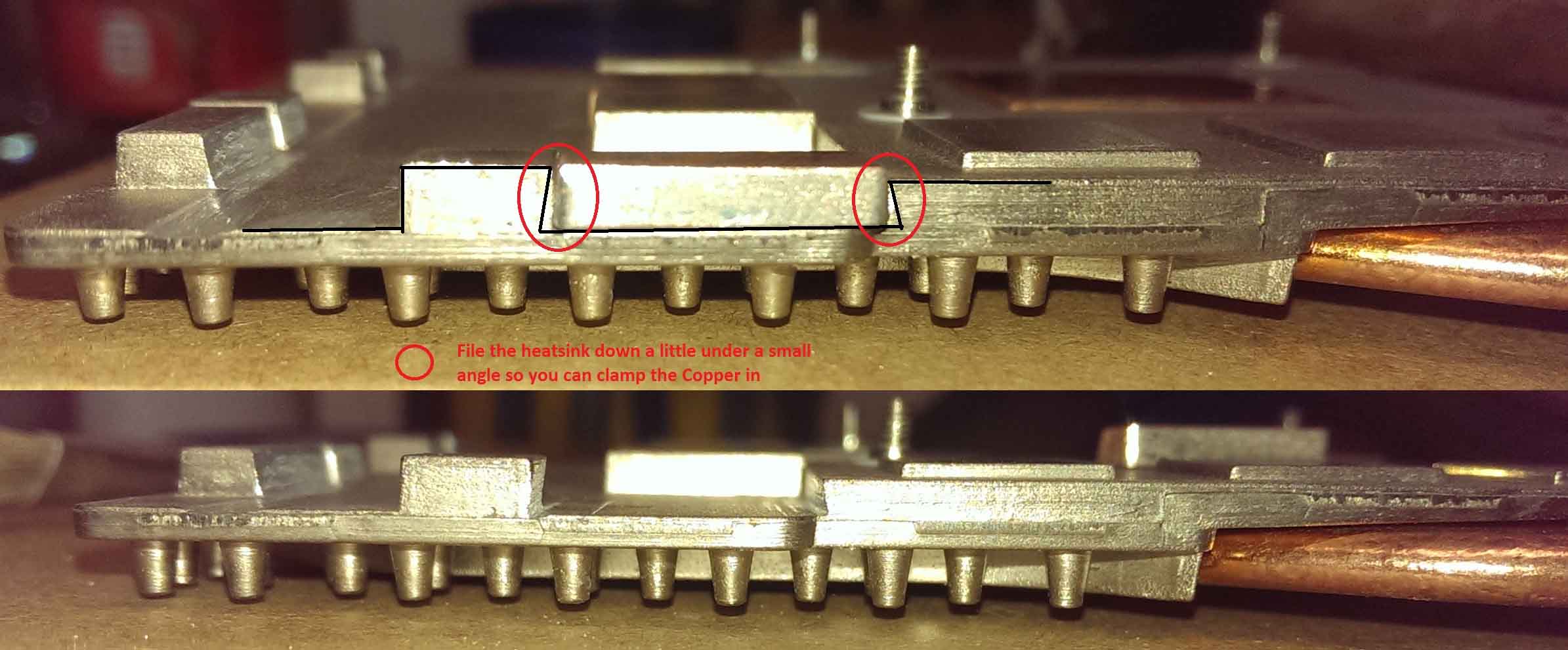

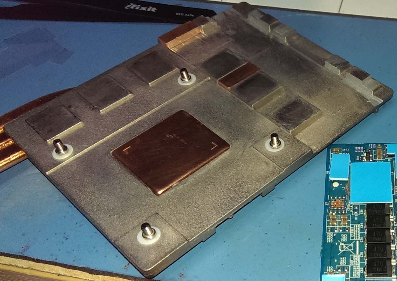

I just wanted to thank you and reply that the GT765M is working great in my MSI GT680R with the MS-16F21 V1.1 Mainboard.
I have flashed the unlocked Bios to my Mainboard before but I don't know if it matters because I didn't change anything.
Only the Cooler I bought on eBay for a 460m has been modified. (Because it lacks the cooling blocks for the Capacitors, I didn't try any heavy load.)
The Card is from Schenker electronics. http://www.ebay.de/itm/122008771567
I think, that the Bios of the Card had been modified, because there has clearly been soldered on the Bios chip and a Resistor on the Board. (I marked them on the first Picture)
To install the Nvidia Drivers I had to modify the Device code in the .inf files of the Driver. Is there a better way to do this than by the Editor?
Till now the Graphics card works great using 2 Displays for watching Youtube Videos in Firefox and playing Classic WoW.
I didn't try heavier games or Benchmarks, because I didn't want to risk damaging anything because of the not perfect cooling solution.
btw, the GPU Temperature does sit on 48°C Idle (firefox) and ~58°C in Classic WoW with full details.
For everyone else who wants to try this, I'll add some Pictures which hopefully explain the process.
Picture of the Card ready to assemble. Only the Thermal Compound on the GPU is still missing.
(Don't file anything off your Graphics Card!!! Just the Heatsink)
Picture of the Heatsink before the modification.
How to easily install add Copper parts to the Heatsink.
Picture of the Heatsink after the modification, ready to install. (I did not add Copper to the spots for the Capacitors)
BTW I removed the X-Shaped metal Bracked from the back of the Graphics Card. This is a pain in the ass to do and you should be very careful not to rip off any components of the board or destroy any circuit on the board. But it was necessary due to the way the Card is mounted in the MSI GT680R.
