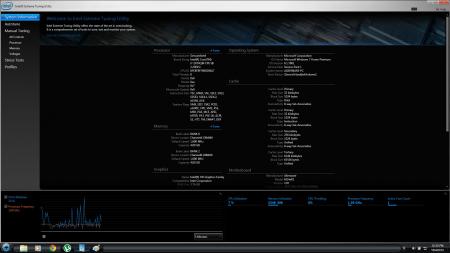

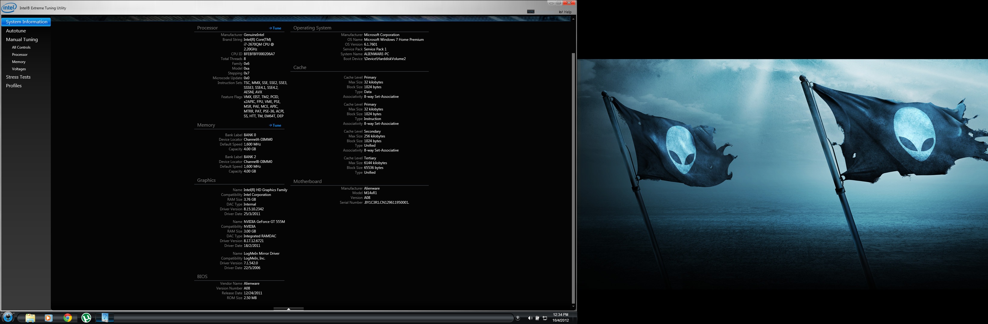

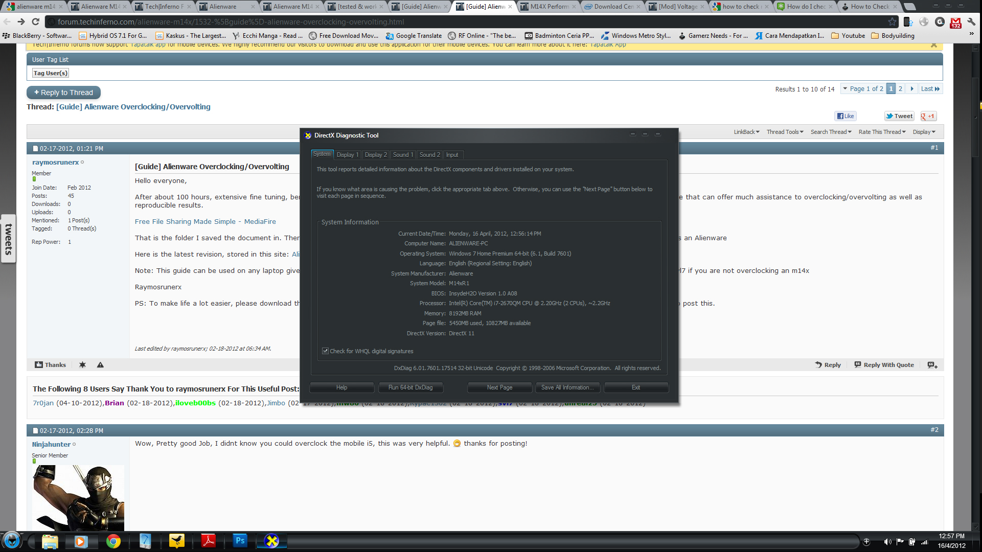

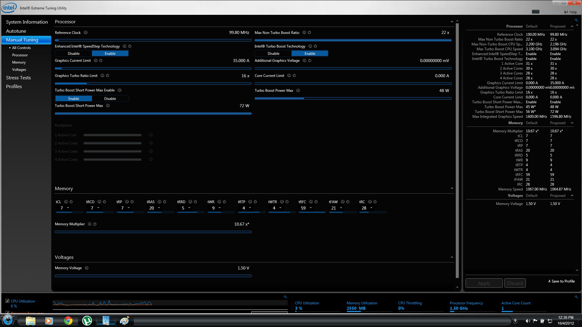

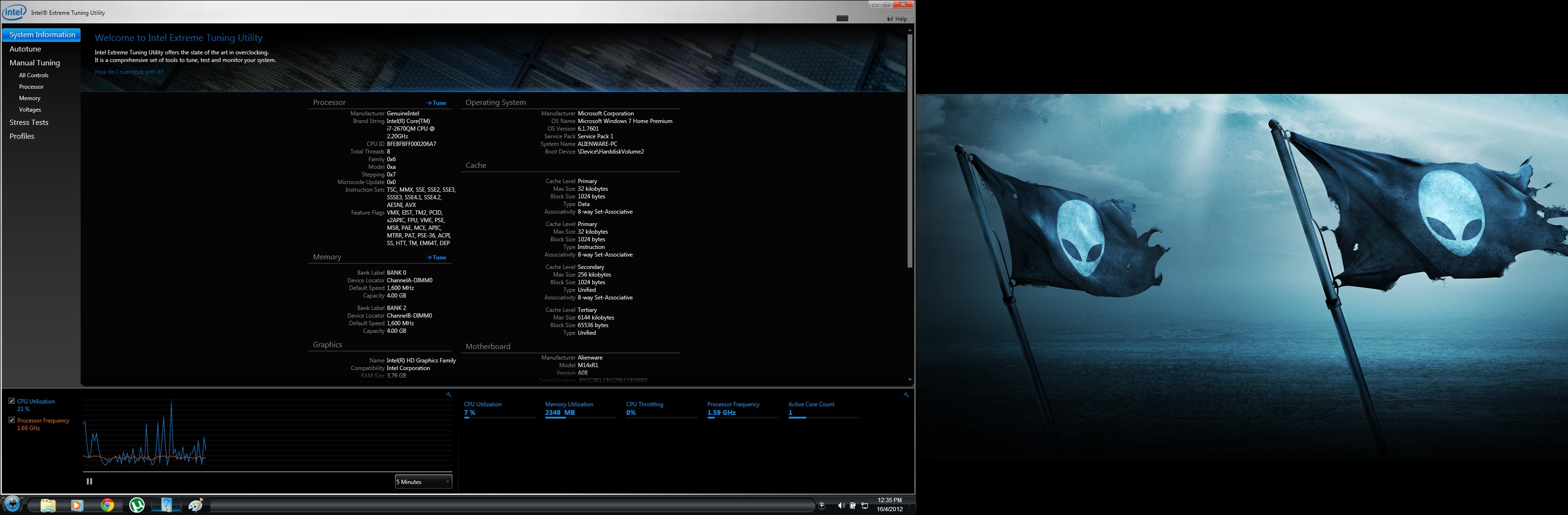

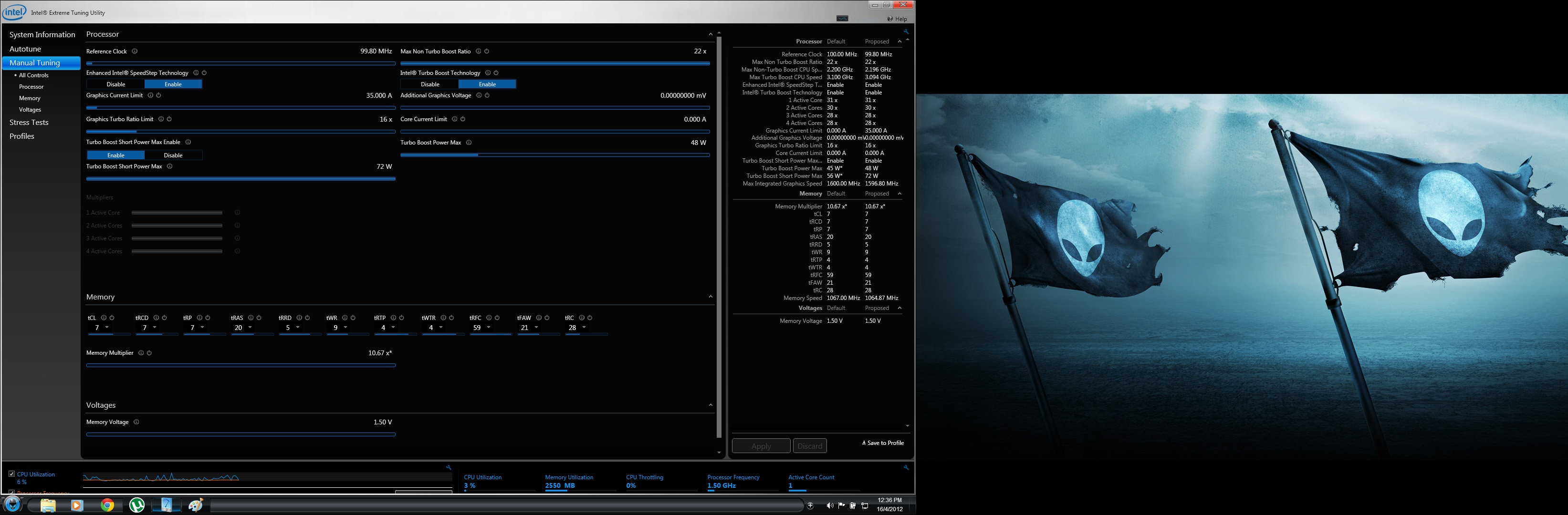

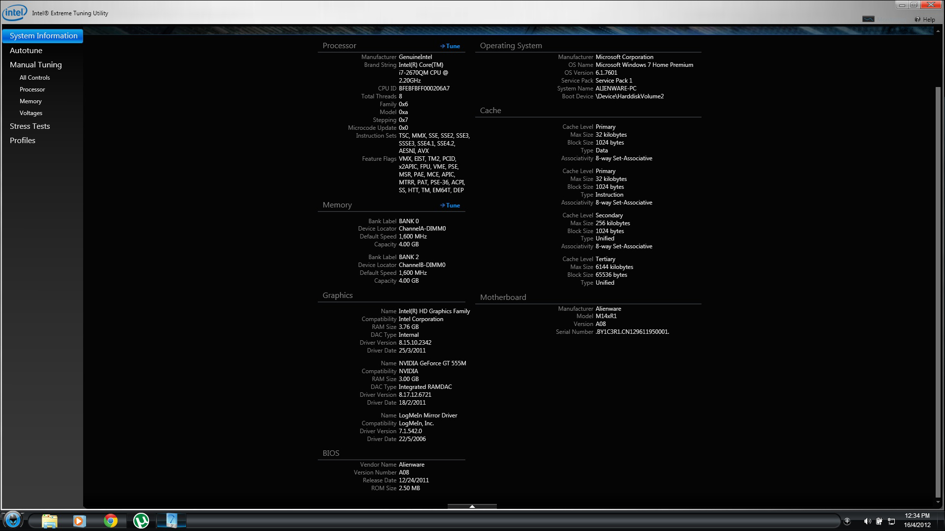

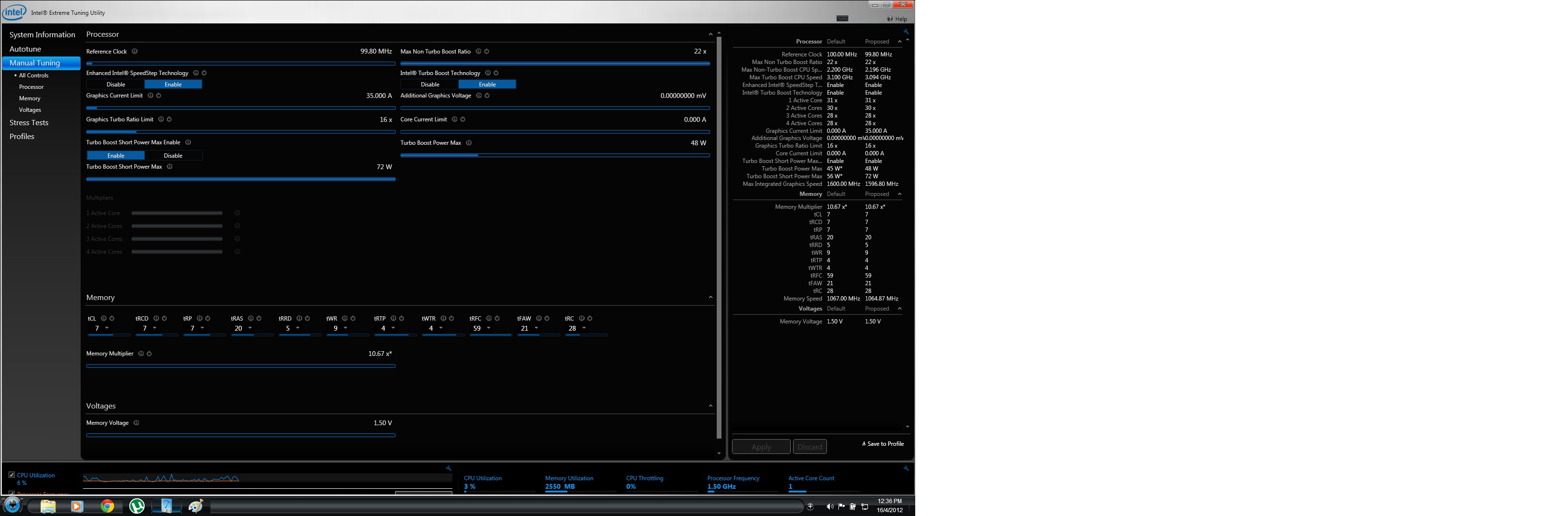

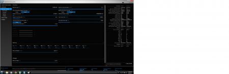

Hi, I just tried to overclock and I followed every step in your "Alienware Overclocking Guide (Rev 2)" and everything went smoothly, except during step 3 when I tried to raise the reference clock. At the beginning the reference clock was 99.8MHz and I followed your step, raising it by 3 then apply. My laptop screen went black, but the FX lights were still on, it was stuck like that for almost an hour and I got worried so I did a manual shut down(pressed the alien head until it turned off) and it was ok, everything was fine. The Turbo Boost Power Max is 48W and the Turbo Boost Short Power Max is 72W. But the reference clock didn't go up it was still 99.8MHz I tried it a couple of times and it's still that way. Can you help me? Oh yeah I am using a 1920 x 1080 monitor to extend the display of my alienware
Here's a screenshot of my spec and the intel ETU
Can you just raise the baseclock via the bios instead? it may be easier... but if yours crashed at 3% maybe try lower :)
How do you use the bios? Sorry I'm still new to this
Download the PDF and check it out. To enter the bios... When the system starts up... Press F2 when it says it on the screen in the lower right before the Window logo is even displayed.
I was unable to adjust the Turbo Boost Power Max and Short Power Max to 99W, XTU just didn't allow me to adjust those values at all. Which version of XTU did you use? I downloaded the v3.2.0.24
