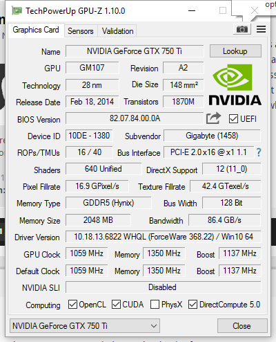

Hello all!
I am very frustrated after my experience with my eGPU.
The reason I start to do it was the death of my GeForce GTX 770M that came with my Alienware 17 (end 2013 model). It is an i7 4th Gen with 2.4 Ghz (Up to 3.2), 16 GB RAM, 250GB SSD from Samsung.
So I bought one GeForce 750Ti, one PSU with 520W from Seasonic and a EXP GDC v8.0 (the alienware have only a mPCI-e to use). Everything was fine. But...
After I took off my GTX770M from Alienware and uninstall its driver, put my GTX 750Ti with mPCI-e and install its driver, see my GPU recognized by device manager, I decided to test eGPU playing games. Terrible! Games was very slow at medium configuration video and sometimes I got BSOD. :(
Here is my GPU-Z: d8f.png
Please someone help me!! Thank you now!

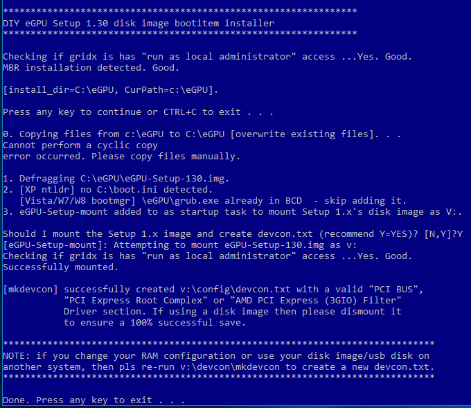

These are the two screen shots I got once the program was mounted. I went into configurations and also disabled the optimus feature. So far no success. When I am going into the Boot Menu after restarting. There are only 3 drives I am seeing that I can boot from and egpu 1.3 is not one of them. Please let me know what do you think I should look into. Thanks!
The Setup 1.30 bootitem exists in your BCD. Strange that it isn't being presented during bootup. Are you using some other bootloader?
In any case, the immediate solution is to use a USB stick installation instead. The installation instructions with Setup 1.30 explain how to create that.

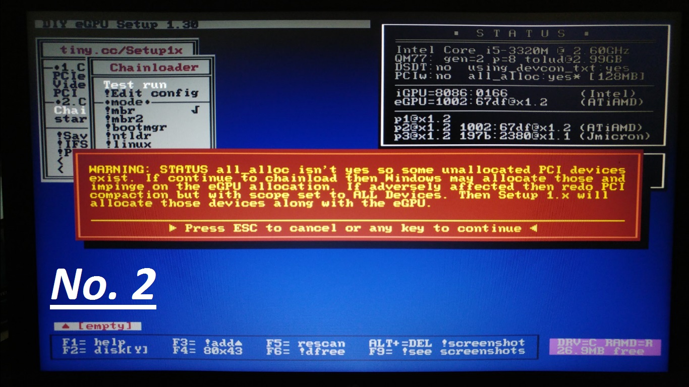

hi guys hi @Tech Inferno Fan,

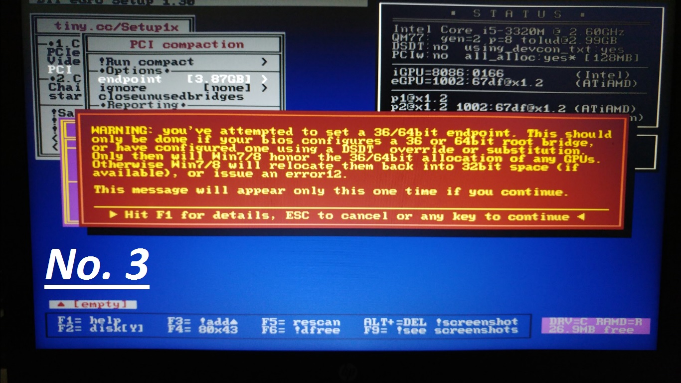

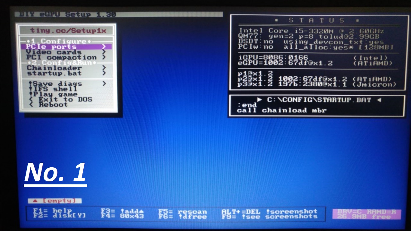

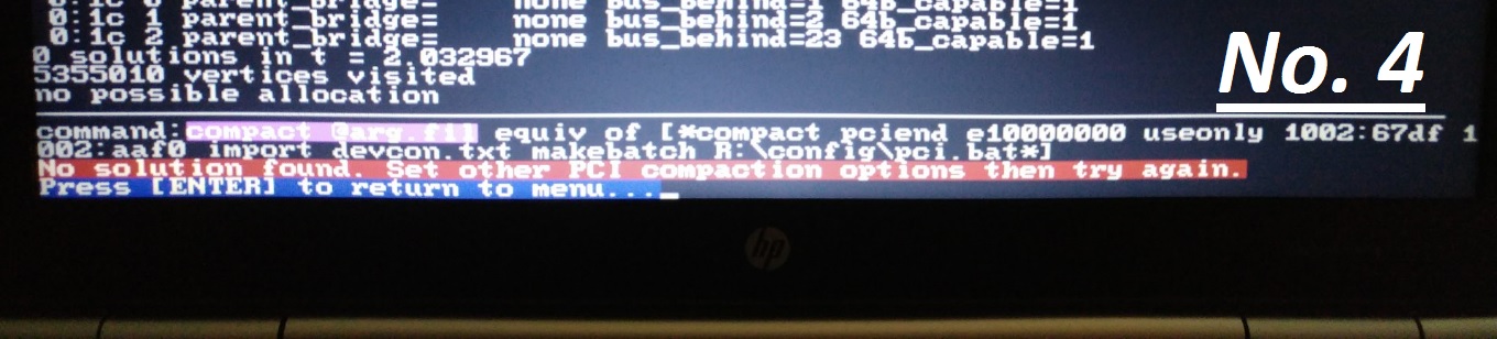

i wanted to setup an egpu for my hp elitebook but got the error code 12. so i did get the diy setup 1.3 from nando to get rid of the error but i couldn't manage to do it.
first of all the hardware
hp elitebook 8470p
- i5-3320m
- 4+2 GB RAM
- intel hd graphics 4000 (no dedicated gpu built in)
- 256gb samsung 850 pro ssd
- win 10 pro 64 bit
egpu
- radeon rx480 8gb
- PE4C V3.0 (PCIe x16 Adapter) with expresscard
- dell d220p-01 psu
the tolud is under 3 gigabyte. i was able to hotplug the gpu 2 times while the system was booting up without any errors and could play games. everything worked perfectly. but i don't want to sit 20 minutes everytime hotpluging the egpu until it works. so this is where setup 1.3 comes in. unfortunately i couldn't get it working and need your help.
here are some pics with "failures" i get while setting it up. sorry for my english and thank you.
pic 1: setup 1.3 overview with its status
pic 2: warning i get if i try to test run the chainloader
pic 3: warning i get if i try to set a 36 bit endpoint in pci compaction
pic 4: error i get setting up the pci compaction (error highlighted in red)
Edited by Pr1me
We've found Elitebooks typically require a DSDT override to be able to use AMD or GTX9xx/GTX10xx cards due to those requiring PCI apertures > 256MB.
So first things first, do you have a 'large memory' Device Manager item in place indicative of the DSDT override working? Pls work through this thread to check: https://www.techinferno.com/index.php?/forums/topic/5874-guide-dsdt-override-to-fix-error-12/
Second thing is your PCI compaction with endpoint=56.25GB above failed probably because you have a non-English v:\config\devcon.txt file (run c:\eGPU\eGPU-setup-mount as admin to view) where the "PCI BUS" entry cannot be identified and skipped, but acts to exclude allocation. Pls remove the non-English PCI Bus section or PM me the file contents so I can identify what needs to be removed.

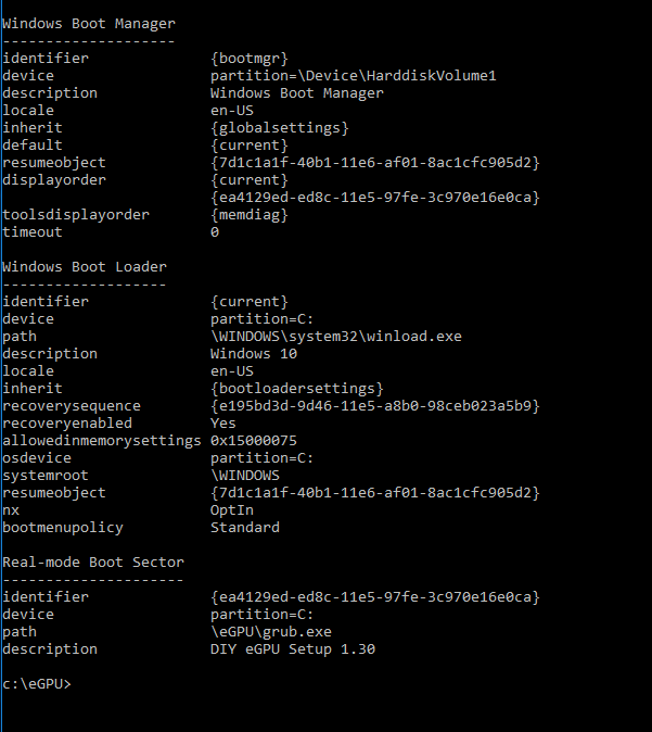

This is my project for a HP ElieteBook 8460P and a MSI GTX750 using the EXP GDC Beast with the express card.
I was able to get the OS to read that there was a NIVIDA graphic card connected to that port with out DYI eGPU but I had the Code 12 issue.
I learned about DYI eGPU through some searches. Purchased it and installed it. I believe I followed the directions but when I reboot and select the DIY eGPU 1.3 option nothing happens.
I do not go to a bios screen. I am stuck at this point.
Pls run c:\eGPU\uninstall-disk-image (as admin), then re-install DIY eGPU Setup 1.30. If you still cannot bootup Setup 1.30 then pls create a USB stick install (as per supplied instructions) and test it instead.

so with the edited devcon file it is now possible to set the endpoint to 56.25GB but the gpu won't show up in the device manager. i did remove the 4GB RAM stick leavin just the 2GB in it and everything seems to work.
to use more RAM i need to do a DSDT override .... right?
edit: ZIP link for the Windows Binary Tools is down.
Edited by Pr1me
Yes, to use the 56.25GB endpoint requires a DSDT override to be in place as the warning message advises you when you perform such PCI compaction.
