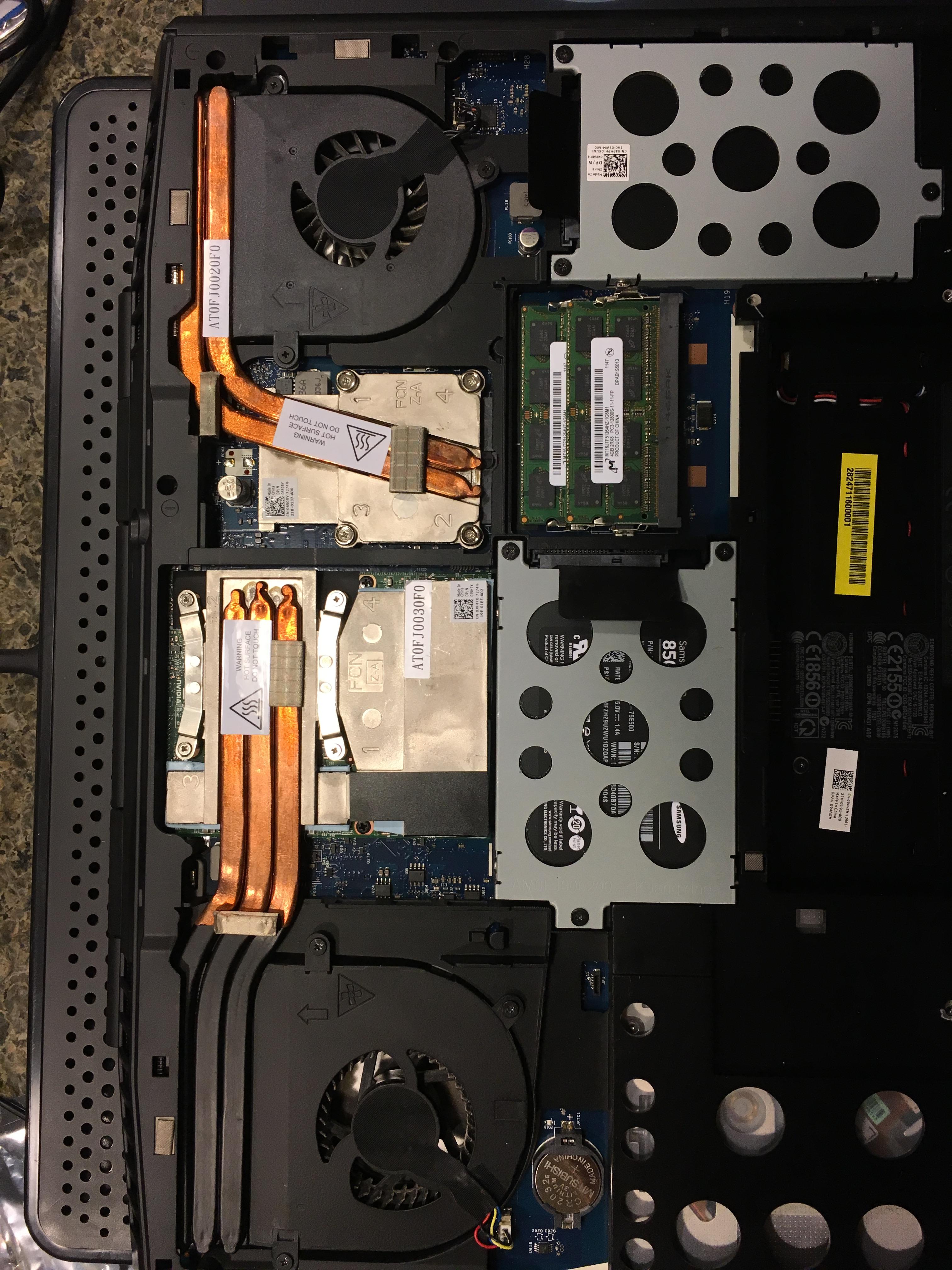

ill work on it more tomorrow.  here's a pic of the bottom of the rig. isn't that the 100w heatsink?  I thought I remembered reading something about the 100w one having 3 heat dissipation pipes.  I cleaned everything out with bottled air (which I've done recently as well) pretty sure they weren't clogged.  I'll probably pull everything tomorrow do a complete re-install new paste etc. check everything again and see how it works, but at this point I'm not convinced its' going to run any cooler.  How can I check to make sure the gpu fan is operationally sound, I've watched it kick on and start running, id say it was somewhere around 60c when I kicked on, but id need to test that again, I only looked at it once while I had the bottom plates off and was loading into a few games to see while monitoring with gpu-z....  lemme know what you think.
-diffuse
Yep, triple pipe heat sink for 560M/660M 75W #J9H7X http://dell-spare-parts.info/catalog/product_info.php/products_id/227538/osCsid/49d66e0a8c7a7062a9ce692ad599a99a
Rearrange thermal pads, look for gaps (against light) then use a thin sheet of paper to check contact...finally apply the thermal paste.
Proper 100W Heat sinks:
675M 100W #MT1DN $55.67 http://dell-spare-parts.info/catalog/product_info.php/products_id/229053/osCsid/49d66e0a8c7a7062a9ce692ad599a99a
680M 100W #9CNMG $54.49 http://dell-spare-parts.info/catalog/product_info.php/products_id/224279/osCsid/49d66e0a8c7a7062a9ce692ad599a99a
Thermal issue resolved, you could try flashing svl7's vBIOS for Clevo GTX 680m (4GB version) improved performance including throttling...

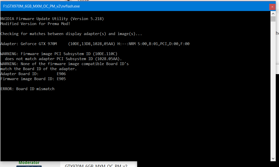

@J95 hey man sorry to bother you but I tried to flash v2 Vbios but I think its says wrong (something something ) and the window close .
Can I reboot now to try in safe mode ? or should I try again ? Do I have to flash STOCK first then flash v2 ? I have v1 at the moment

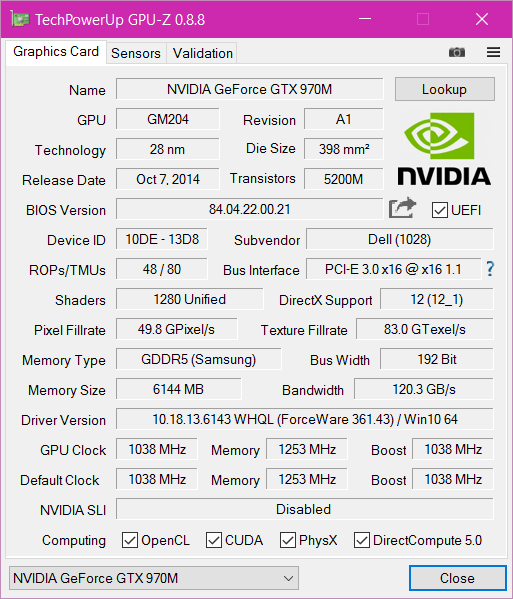

Device manager -> Disable 970M
Latest GPU-Z -> dump current vBIOS  -> check vram '6GB version'.
Copy extracted "GTX970M_6GB_MXM_OC_PM v2" to desktop (GTX 970M 6GB)
Rename .rom "970M.rom"
GTX970M_6GB_MXM_OC_PM v2 -> SHIFT right click "Open command window here"
nvflash.exe -6 970M.rom
Type "Y" twice (to override PCI subsystem ID mismatches)
"Flash successful" -> device manager -> re-enable 970M -> reboot *otherwise* repeat the steps above.

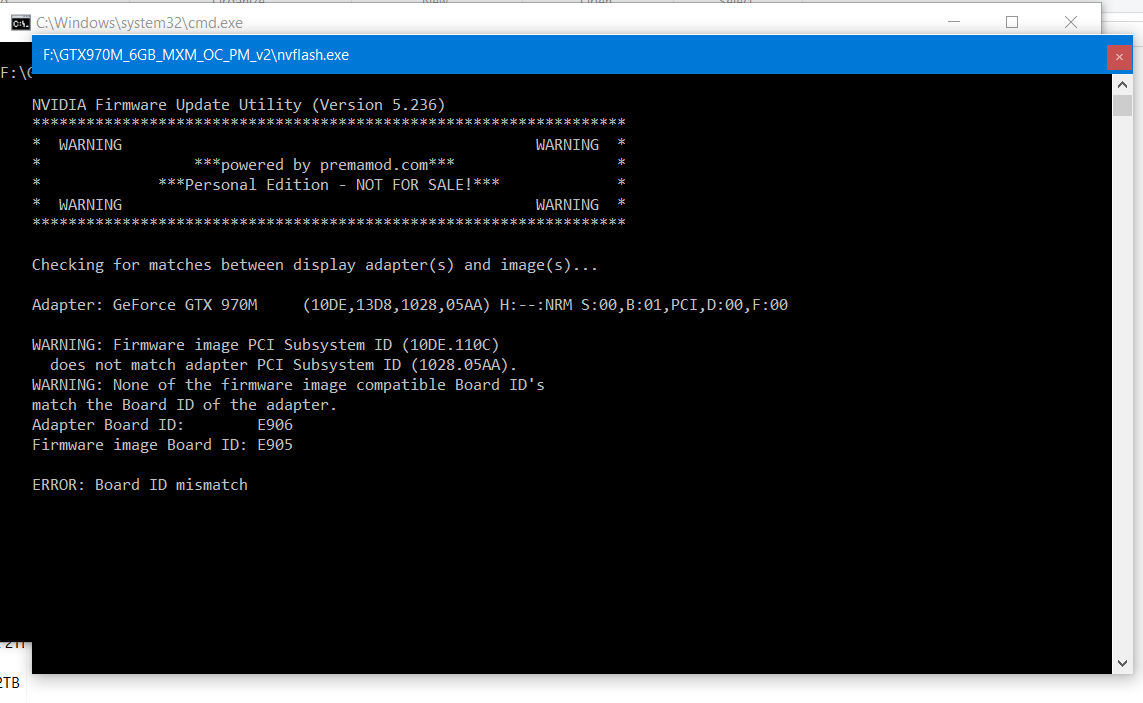

7 hours ago, HaloTechnology said:
@J95 I tried your commands but still its closes because of ID board Mismatch ? when should I press Y ? is there something I am missing ?
nvflash.exe -6 970M.Rom <<<<<< correct right ?
Try NVFLASH_WIN_5.218_x64 (password premamod.com)
GTX970M_6GB_MXM_OC_PM_v2
When prompted...type Y  to override PCI subsystem ID mismatches.
