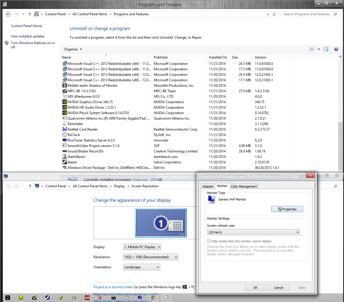

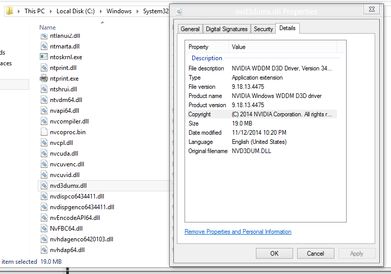

J95 Posted November 21, 2014 Author Share Posted November 21, 2014 Hi again,Nor v344.65, v344.75 works for me. Screen still gets garbled up, like out of focus...little lines like a Van Gogh painting ((no example, did not make screenprint) So still on v344.11. Any suggestions? -Thanks!- Hi man. v344.65 worked fine for 2 days, blurry screen all over again. I'm back to v344.11. Temporary Fix. Latest games. NV driver v344.75 -> Display.Driver folder -> extract .dl w/ 7-Zip v9.25 x64. nvwgf2umx.dlnvwgf2um.dl nvd3dum.dl nvd3dumx.dlBackup first. Copy/overwrite all DLLs v344.75 to the corresponding directories (safe mode). C:\Windows\System32\nvwgf2umx.dll C:\Windows\SysWOW64\nvwgf2um.dll C:\Windows\SysWOW64\nvd3dum.dll C:\Windows\System32\nvd3dumx.dllInstalled version 344.11 -> Dlls v344.75 @godfafa try this too. @JoostvanBoxmeer I don't have an M17xr3 anymore (Amir) http://forum.techinferno.com/alienware-m17x-aw-17/3702-m17x-r3-gpu-upgrade-gtx-780m-37.html#post113499 3 Quote Link to comment Share on other sites More sharing options...

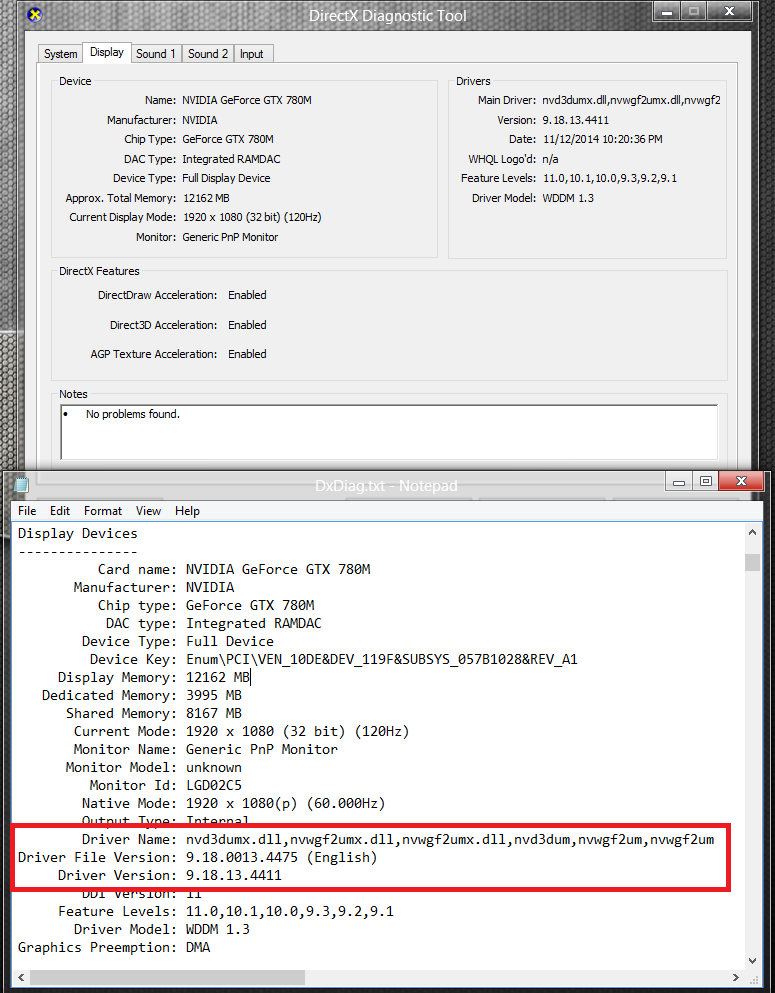

J95 Posted November 22, 2014 Author Share Posted November 22, 2014 Hi again,Nor v344.65, v344.75 works for me. Screen still gets garbled up, like out of focus...little lines like a Van Gogh painting ((no example, did not make screenprint) So still on v344.11. Any suggestions? -Thanks!- Hi man. v344.65 worked fine for 2 days, blurry screen all over again. I'm back to v344.11. Temporary Fix. Latest games. [ATTACH=CONFIG]13196[/ATTACH] NV driver v344.75 -> Display.Driver folder -> extract .dl w/ 7-Zip v9.25 x64. nvwgf2umx.dlnvwgf2um.dl nvd3dum.dl nvd3dumx.dlBackup first. Copy/overwrite all DLLs v344.75 to the corresponding directories (safe mode). C:\Windows\System32\nvwgf2umx.dll C:\Windows\SysWOW64\nvwgf2um.dll C:\Windows\SysWOW64\nvd3dum.dll C:\Windows\System32\nvd3dumx.dllInstalled version 344.11 -> Dlls v344.75[ATTACH=CONFIG]13197[/ATTACH] @godfafa try this too. @JoostvanBoxmeer I don't have an M17xr3 anymore (Amir) http://forum.techinferno.com/alienware-m17x-aw-17/3702-m17x-r3-gpu-upgrade-gtx-780m-37.html#post113499 Screen refresh rate reverts to 60Hz upon restart LGD02C5 (5 months) and the messed up monitor profiles/v34x.xx bugs, all fixed...Posting soon. [ATTACH=CONFIG]13199[/ATTACH] AW LGD02C5/120Hz Fix1- Display.Driver_v344.11_75_LGD02C5.7z -> v344.75 core DLLs+ -> 120Hz reverts to 60Hz Fix -> Blurry screen/text fixed. Unlocked vBIOS Recommended Set refresh rate to 120Hz -> Uninstall current drivers DDU Download GeForce 344.11 WHQL Extract driver 7-Zip v9.25-x64 Delete Display.Driver folder -> Copy/Paste (7-Zip) [Link Removed]2- Display.Driver_v344.75_LGD02C5.7z v344.75 -> Blurry screen/text fixed. Unlocked vBIOS/cards -> don't install this version, it removes the Power target adjust ability & readings/greyed out. Download GeForce 344.75 WHQL Extract driver 7-Zip v9.25-x64 Delete Display.Driver folder -> Copy/Paste (7-Zip) [Link Removed] -> v344.80 HotFixBoth options include CUDA nvcuvenc Mod, all AW Models/cards supported.@JoostvanBoxmeer @godfafa try v344.11/v344.75 core DLLs+ (1). I don't have time to test OCing, godfafa compare results... 2 Quote Link to comment Share on other sites More sharing options...

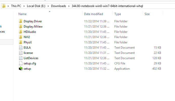

J95 Posted November 23, 2014 Author Share Posted November 23, 2014 Ok used DDU to remove the driver, extracted the new one and deleted Display.NView Display.Update and Display.Optimus, but could´nt find NVWMI , copy/pasted nvdmi and startet setup , but failed to install :/ Win8 -> Disable driver signing.Download Geforce 344.80 Beta Extract driver with 7-Zip -> Extract to "344.80-notebook-win8-win7-64bit-international-whql" Display.Driver folder -> copy/overwrite nvdmi.inf (unzip). Extracted driver folder -> run setup.exeSafe to delete. My driver folder. @JoostvanBoxmeer Nvidia finally fixed the blurry screen & refresh rate (5 months) bugs v344.80, unbelievable coincidence..WTF. Spent many hours doing this...... , nvdmi.inf_v344.80_AW_M17xR2_R3_R4_M18xR1_R2_GTX_680M_780M_880M.zip nvdmi.inf_v344.80_AW_M18xR1_R2_GTX_680M_780M_880M_SLI.zip 2 Quote Link to comment Share on other sites More sharing options...

BamXx Posted November 27, 2014 Share Posted November 27, 2014 Win8 -> Disable driver signing.Download Geforce 344.80 BetaExtract driver with 7-Zip -> Extract to "344.80-notebook-win8-win7-64bit-international-whql"Display.Driver folder -> copy/overwrite nvdmi.inf (unzip).Extracted driver folder -> run setup.exeSafe to delete. My driver folder.[ATTACH=CONFIG]13230[/ATTACH],ok did that , but got blackscreen while installing driver , rebooted a bit later and still got an blackscreen as soon as windows finished booting :/ i went a bit thru the post and shall i repeat the progress with remounting the card? Quote Link to comment Share on other sites More sharing options...
J95 Posted November 29, 2014 Author Share Posted November 29, 2014 ok did that , but got blackscreen while installing driver , rebooted a bit later and still got an blackscreen as soon as windows finished booting :/ i went a bit thru the post and shall i repeat the progress with remounting the card?As I said, you need to disable driver signing first.Please follow the instructions below.- Windows 8 - disable driver signingCommand Prompt (Admin) Win key + X Type:bcdedit /set {current} testsigning yes-> "The operation completed successfully" ->reboot ->Install drivers.Exit test mode, cmd (admin).bcdedit /set {current} testsigning no->reboot. Quote Link to comment Share on other sites More sharing options...
