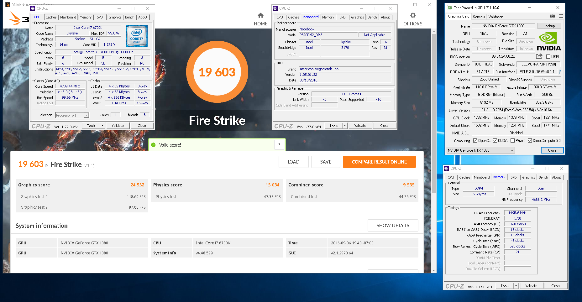

21 minutes ago, johnksss said:
 http://www.3dmark.com/fs/9595299
That is a 6700k, where do you get 6920hq from that?
I think you might want to go back and check first before jumping the gun my friend....
These are more closer to what you should be looking at.
http://www.3dmark.com/compare/fs/10011170/fs/10001580/fs/10059807
And like i have pointed out many times before. A single gpu physics score will always be higher unless the person benching does not know what they are doing by a very very long shot.
http://www.3dmark.com/compare/fs/9954310/fs/10053831# this is the score comparison that @Mr. Fox posted with your score versus another user with a 6920HQ at 4GHz.
http://www.3dmark.com/fs/10053831 This is the score that I pulled from the above link just now, to look specifically at the Physics score (35.11fps; 11,059 score).
http://www.3dmark.com/fs/9595299 This is a run from @Spellbound, who I asked to provide one of her benches with her 6700K at 4GHz for me, so I could check her physics score (39.79fps; 12,534 score), as I felt that the above 6920HQ run was way too slow. Also, I noted that in his other benchmark (the comparison in Mr. Fox's post to your score in Time Spy and the MSI score in Time Spy was from the same person) his CPU only went up to 3.6GHz (either he removed the overclock, or something else happened).
My original post, saying "something is wrong", is pointing out that the 6920HQ at 4GHz should have minimum cracked 12K, and not sat at 11k on the PHYSICS test.
You bashed me, and posted a single GPU benchmark with a 4.7GHz chip in response. That was pointless. Then you told me that single GPU gets higher Physics scores than SLI setups, which while it may be true, does not equate to 1500 points lost. And then you post benchmarks for single GPU where the highest CPU speed is 3.6GHz, which does not equate to the 4GHz that was supposedly on the MSI benchmark.
What exactly have I "misunderstood" now? Unless if I go and disable SLI on my notebook and run a single GPU firestrike right now, I'll end up with a solid 1.5k increase in score?

@D2ultima I don't know if you noticed, but Brother @Papusan has been complaining about Fire Strike physics score being goofed up for a while now. Since Time Spy was released they have been messed up. It's mostly a GPU test anyway and the physics scoring seems to have minimal effect on the overall score. The combined score has more of an effect, but even that is muted a little bit compared to 3DMark 11. It seems like more of a fluffy feel good benchmark that helps BGA turdbook owners not feel bad about owning something with a crappy CPU. If it took a powerful CPU to get a nice overall score the turdbook owners probably would not be running it. They would be avoiding it like most of them avoid 3DMark 11 and Vantage.
Yes, I did see. I was wondering when they'd fix it.
57 minutes ago, johnksss said:
Getting better @D2ultima
Higher Physics Score, but it still lost.
http://www.3dmark.com/compare/fs/10073122/fs/10073016
Okay. I've run the three benches I said I would. I DID see a benefit on single GPU in the physics test. But it was very slight, as reflected in the results.
http://www.3dmark.com/compare/fs/10073292/fs/10073334/fs/10073378
As far as I can see, this is what should happen. The slight benefit, logically, is due to the fact that SLI in itself has a CPU overhead to render. The same should be for crossfire. It's probably a good thing people haven't figured out a way to use NVPI to specifically disable SLI via NVAPI for the physics test alone, or that would be a way to boost scores without actually turning SLI on/off inbetween tests (which would really be impossible I think).
As for why multi-GPU is doing better in Physics with Maxwell (and Pascal, since Pascal is essentially die-shrunk maxwell overclocked), you've got me stumped right there. I couldn't begin to guess. It makes no logical sense to me.
