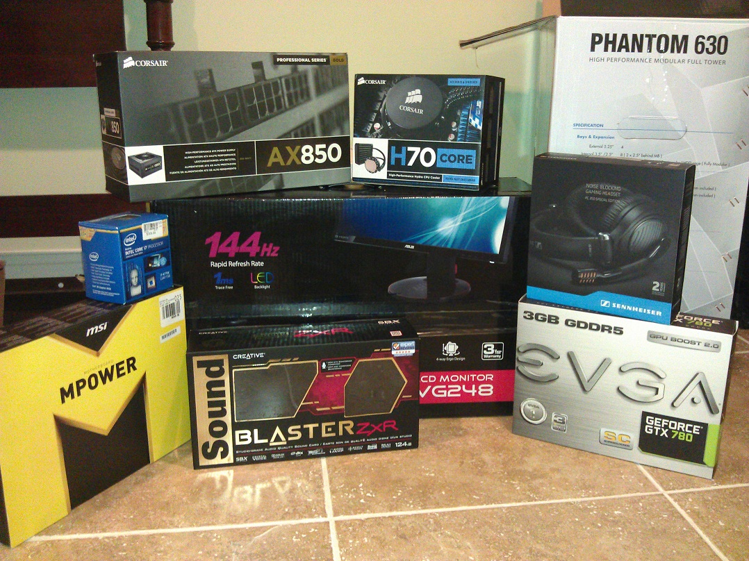

  8. Well boys, time for my first desktop build. :) The main tower is geared towards top performance, without going broke to LGA2011/Titan config.The accessories are geared towards FPS games, particularly competitive Counterstrike: Global Offensive.Here's the stock config: CPU Intel i7-4770k $280 Motherboard MSI MPower Z87 $190 Video Card EVGA ACX GTX 780 $660 RAM 2x4 GB Corsair Vengence LP 1600Mhz $60 SSD 128GB Plextor M3Pro (OS) -- HDD 750GB Seagate -- CPU Cooler Corsair Hydro H70 (2x Corsair 120MM fans pull) $50 Sound Creative SoundBlaster ZxR $200 Power Supply Corsair AX850 $120 Case NZXT Phantom 630 Full Tower $170 Monitors Main: Asus VG248QE 144Hz | Second: HP 2311xi IPS $250 Keyboard Steelseries 6Gv2 (Cherry Black) -- Headset Sennheiser PC 350 SE $250 Mouse Logitech MX518 (@400 DPI) -- My main tower cost: $1730(SSD/HDD pulled from laptop)Accessories: $500(Keyboard/Mouse purchased years ago) ----------------------------------------------------Total: $2230 [ATTACH=CONFIG]8624[/ATTACH]----------------------------------------------------------------Conclusions:1. Anyone who says 60Hz is fine for FPS is full of shit or needs to go to the optometrist/ophthalmologist to get those eyes checked out. I use the LightBoost StrobeLight mod to get the fastest refresh rate/latency possible, (120Hz Storbed is better than 144Hz). It's simply.... AMAZING. I switched back to 60Hz just to test the difference and my eyes felt like crap within a minute.2. "Sound cards do not make a difference from integrated". Wrong on so many levels. Your gear has to match the sound card, for instance my 150ohm impedance Sennheiser's are quiet as hell on integrated. They also don't sound nearly as amazing on a NICE sound card. I'm not talking about a SB Audigy 2 from 2001 or using iPod headphones. I'm talking Asus Xonar/SB Zx&ZxR with professional headset/speakers.3. Fuck the Haswell silicon lottery. I got an average chip. Can't clock higher than 4.5GHZ, even though I have tons of thermal headroom.4. If you are debating GTX 780 vs. Titan, get the GTX 780 Classified. That thing is an insane overclocker for $700. Otherwise a custom cooler GTX 780 is a good buy regardless.

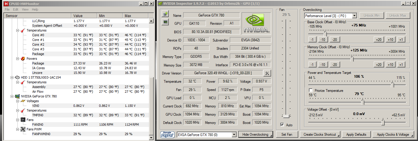

  16. stock fans idle: 1350-1400 rpm, 39% new vbios: 1100-1150 rpm, 29% So what's the consensus on the best OCing software? Is inspector the best because EVGA/MSI mess w/ boost clocks still? Weird OCing glitch with inspector? I can hit 1267mhz core stable in unigine heaven but when i bump my clocks up to 1275, it goes to 1280mhz. There's no middle ground at that point; it's either 1267mhz or 1280mhz and 1280mhz causes slight artifacts.

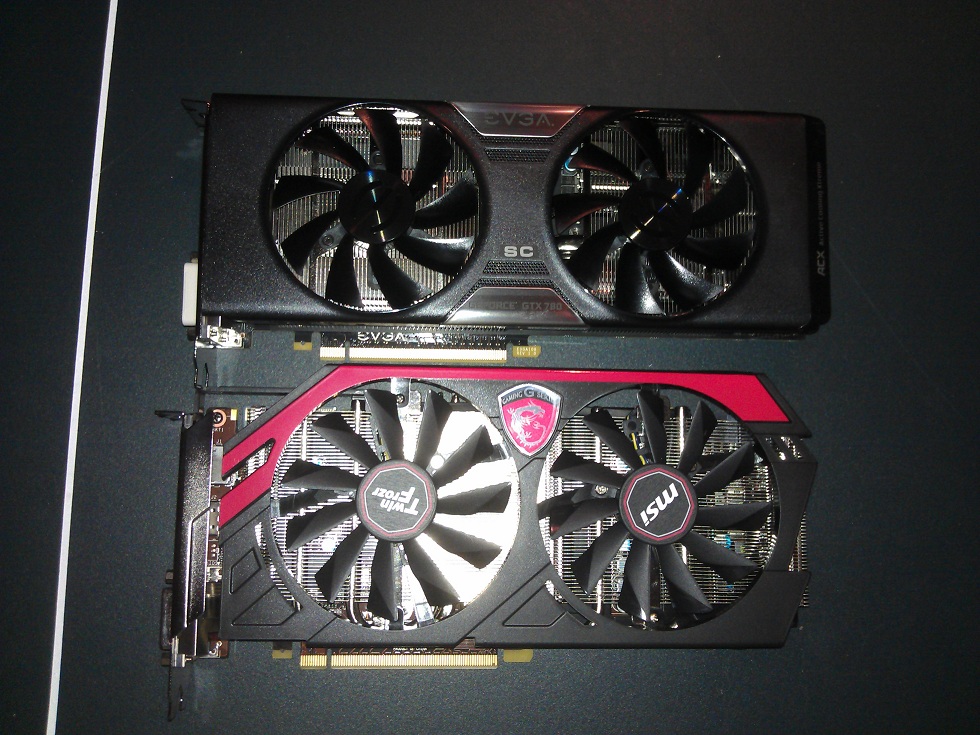

  18. New 780 ACX on top, old 770 Twin Frozr on bottom. The Twin Frozr cooling is way better IMO. 2 100mm fans ran at 30% the entire time... whisper quiet and the card never exceeded 74*C. The ACX fans can get pretty loud.
