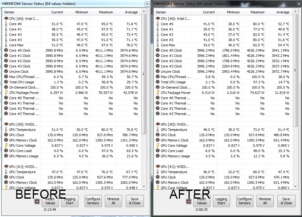

  7. so i finally got the liquid ultra and did a repaste job on my 4930mx, as well as i repasted both 780m's with ICD24. here is a 3DMark11 run with the same settings (cpu @4.0GHz - GPUs +80 / +100 since this is my 24/7 setting). check the temps ^^
    1 point
