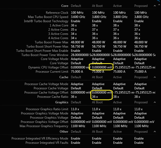

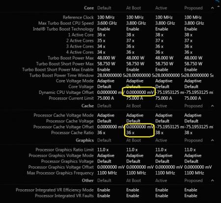

kaczor Posted April 26, 2015 Share Posted April 26, 2015 1. XTU writes directly to the BIOS. The settings are written after the first full shutdown. If they are deemed stable they will stick during the next boot.Once that is complete you can even uninstall XTU and they will remain in BIOS until a BIOS reset or load of defaults.OK, I must be doing something wrong:I start CPU-Z it shows max multiplier at 36I start XTU, CPU-Z now shows multiplier at 38 same as in XTUI exit XTU. CPU-Z still shows 38I do a full shutdown of the laptopI turn the laptop on and start CPU-Z once it boots. CPU-Z still shows multiplier at 36 until I start XTU again.2. Use the BIOS Mod to set "Advanced" > "Switchable Graphics" > "PX 5.0 Mode" to "BACO" and the FANs will spin properly according to dGPU temperature even after it enters lowest power state.(Also use ClevoHotKeyApp to set the system to "Entertainment" mode when full power is not needed in order to keep the system cooler)Unfortunately this did not work for me. I ran Firestrike benchmark after this BIOS change and it still crashed once GPU temp reached 96°C. GPU fans were on but stayed at low during the entire time.Any ideas?Thank you! Link to comment Share on other sites More sharing options...
Guest Posted April 26, 2015 Share Posted April 26, 2015 OK, I must be doing something wrong:I start CPU-Z it shows max multiplier at 36I start XTU, CPU-Z now shows multiplier at 38 same as in XTUI exit XTU. CPU-Z still shows 38I do a full shutdown of the laptopI turn the laptop on and start CPU-Z once it boots. CPU-Z still shows multiplier at 36 until I start XTU again.Unfortunately this did not work for me. I ran Firestrike benchmark after this BIOS change and it still crashed once GPU temp reached 96°C. GPU fans were on but stayed at low during the entire time.Any ideas?Thank you!1. You are not only starting XTU, but actually applying the setting, right? Are you sure you are doing a full shutdown? Windows 8+ defaults to standby or deep sleep. You can change that in Windows Power Settings under the Advance tab. (You can set multiplier also directly in BIOS btw, no need for XTU for that)2. I misunderstood your problem...that sounds like Clevo HotKeyApp preventing the FANs from working. Uninstall it, reboot and see if they spin properly. Then install it fresh without using custom FAN profiles. Link to comment Share on other sites More sharing options...
kaczor Posted April 26, 2015 Share Posted April 26, 2015 1. You are not only starting XTU, but actually applying the setting, right? Are you sure you are doing a full shutdown? Windows 8+ defaults to standby or deep sleep. You can change that in Windows Power Settings under the Advance tab. (You can set multiplier also directly in BIOS btw, no need for XTU for that) I'm using windows 7 and I tried both - start menu shutdown and command line "shutdown -s -t 0" If I do the multiplier directly in BIOS then yes it does work, however I also undervolt the CPU (by -75mV) in XTU and there are no settings for that in the BIOS so I would prefer that XTU settings would persist. 2. I misunderstood your problem...that sounds like Clevo HotKeyApp preventing the FANs from working. Uninstall it, reboot and see if they spin properly. Then install it fresh without using custom FAN profiles. Uninstalling HotKey fixed the issue. Thank you! Link to comment Share on other sites More sharing options...
kaczor Posted April 26, 2015 Share Posted April 26, 2015 More info: So anything I can directly set in PremaMod BIOS does persist across reboots. But the outlined settings in yellow have to be applied on every boot since I cannot set them in BIOS. Link to comment Share on other sites More sharing options...
Guest Posted April 26, 2015 Share Posted April 26, 2015 Looks like you only hit "apply" but not "save"... Link to comment Share on other sites More sharing options...

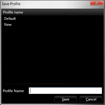

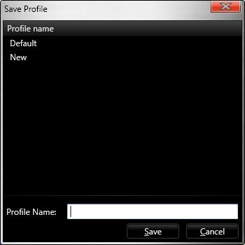

kaczor Posted April 26, 2015 Share Posted April 26, 2015 Save opens a profile save dialog box where I can save the current settings into a profile file: (and I cannot override default) Link to comment Share on other sites More sharing options...
Guest Posted April 26, 2015 Share Posted April 26, 2015 Nobody can override the default, that's the hardware default.What you want is to change the "at boot" values. Link to comment Share on other sites More sharing options...
kaczor Posted April 26, 2015 Share Posted April 26, 2015 Yes, but I have no idea how to change the at boot values. Link to comment Share on other sites More sharing options...
Guest Posted April 26, 2015 Share Posted April 26, 2015 Try to use an older XTU version...EDIT: Actually if you are using Windows in UEFI mode it prevents these settings from being permanently written to BIOS. You need to install Windows in Legacy mode in order for XTU changes to be 'permanently' in BIOS. Link to comment Share on other sites More sharing options...
kaczor Posted April 27, 2015 Share Posted April 27, 2015 Actually if you are using Windows in UEFI mode it prevents these settings from being permanently written to BIOS. You need to install Windows in Legacy mode in order for XTU changes to be 'permanently' in BIOS. Good to know that. I'm not ready to reinstall windows however so I'll just live with it. Link to comment Share on other sites More sharing options...
