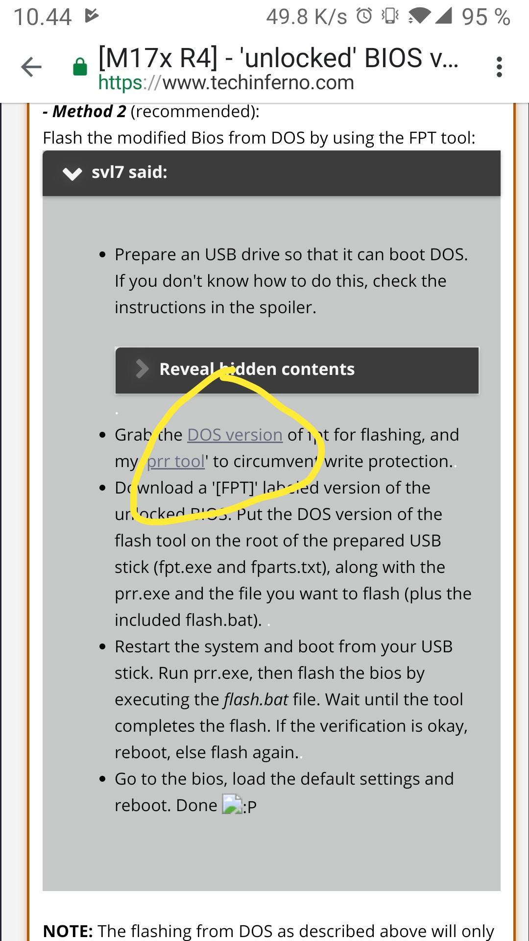

https://www.techinferno.com/applications/core/interface/file/attachment.php?id=11973
This is the download link. If you can not use it, it is because you have not made enough quality posts yet. (Read the rules)
A think you can try is pressing FN+F7
The exact function is unclear, but it should switch between IGFX, PEG and SG. You need to restart each time.
Also you need to have installed Alienware OSD (on-screen-display) and Alienware command center for it to work.

Ahh got you thank you so much! :) what about the FPT tools ? they show me 404 as well.
I tried FN+F7 it does not switch my GPU still, and when i head into my BIOS , ther is no discrete graphic card detected / shown

About the FPT tools look some few posts further up. I posted some working links for those too.

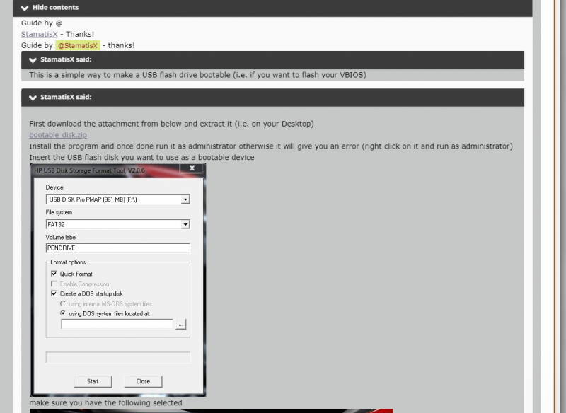

I just subbed for Tier 1 :) got the files not sure about the bootable_disk.zip now
You lost me here... What bootable_disk.zip?
