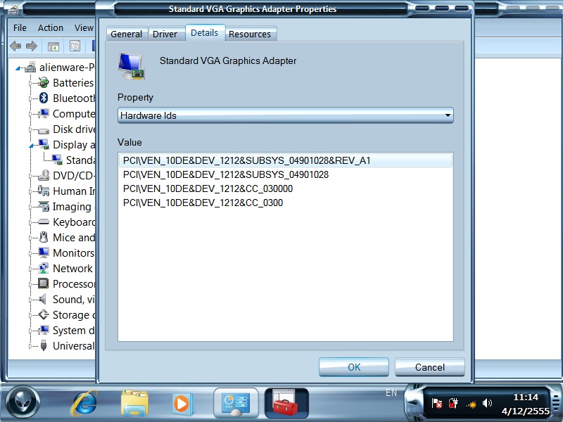

Hi svl7, I want to upgrade my M17X R3 3D(120Hz, GTX460M) to GTX675M.
I alread replaced it but it can't work completely. I can't find vbios, Can you help me?
This is my hardware ID as in attached picture.
Model: GTX 675M
Part #: N13E-GS1-LP
CUDA Cores: 336
VRAM: 2GB GDDR5
Clock/Memory: 598MHz/1500MHz
TDP: 75W
Interface: MXM 3.0B
Size: 82x105mm (3.2x4.1”)
SLI Ready: Y
3D Capable: Y
[ATTACH=CONFIG]5542[/ATTACH]
Model: GTX 675M
Part #: N13E-GS1-LP
CUDA Cores: 336
VRAM: 2GB GDDR5
TDP: 75W
Interface: MXM 3.0B
SLI Ready: Y
3D Capable: Y
