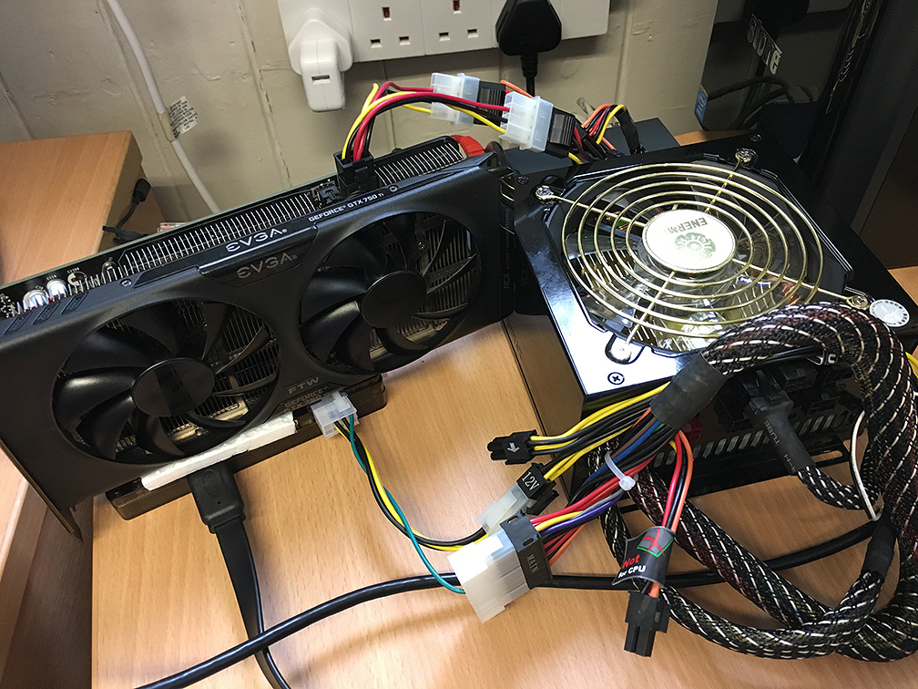

Hello guys,
I’m stuck on an issue and I don’t know how to resolve it and I'm so close to getting it working!
Some background info:
Windows 10
Lenovo T530
16GB RAM
EXP GDC V8 Adapter
Intel i5-3320M @ 2.6GHz
TOLUD = 3.49GB
NVidia GTX750 Ti FTW GPU
iGPU Intel HD4000
Enermax ELT500AWT (500 watt) PSU
I’ve got an EXP GDC V8 adapter that plugs into my laptop via the ExpressCard slot. I bought the eGPU Setup 1.30 as my laptop has more than 3GB of RAM and I didn’t want to take it all out. I’ve managed to successfully (after many hours!) create an AML file so that I can perform a DSDT substitution using Setup 1.30. That all works fine and I get the large memory appear in Device Manager and my system boots fine without the BSOD. I install the latest drivers for my card and disable my internal screen and have only my external on. I’m trying to play 7 Days to Die – it loads fine and I can start a game and then 5 seconds later…The eGPU turns off and my internal display turns on and it’s just running the iGPU.
I’m using 36-bit compaction on both iGPU + eGPU with chainloader is set to 'mbr' and I don't get any errors in the Device Manager.
Am I doing something wrong? I’m pretty much just doing trial and error with the configuration in eGPU 1.30.
Here's my setup currently:
Regards,
gooch
Edited by goochmonster
Added a picture of my setup

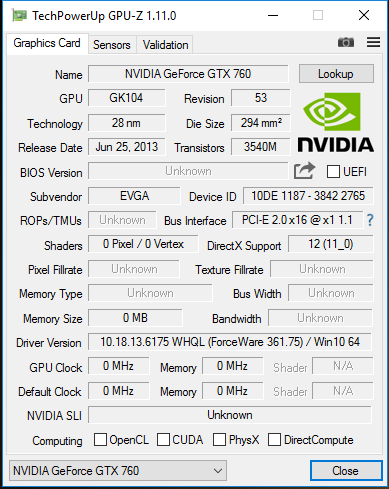

Hi everyone
I have exp gdc v8 and my specs
Dell N5110
i7 2670qm
8gb ram
gt525m@hd3000
egpu@EVGA GTX 760
HM67 chipset
My problem m-pcie slot work only 1.1 speed
I tried force gen2 speeds but card doesn't work.

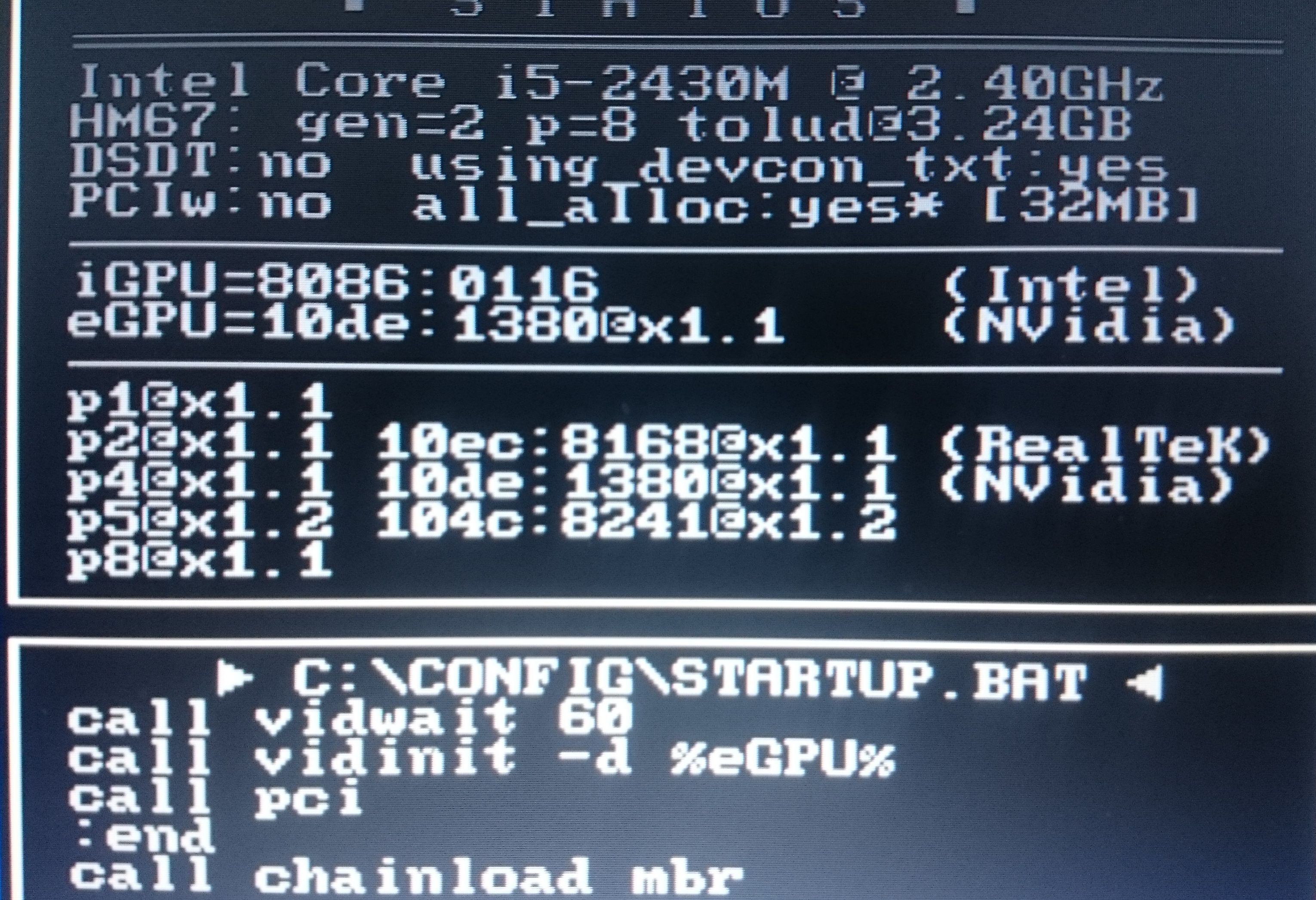

I finally got my eGPU setup working! In the end I returned the graphics card I had and bought another one (EVGA GTX 750 Ti with the single fan) and it works flawlessly. I'm very pleased with the performance. Now, on to my next issue...
@Tech Inferno Fan How do I automate my STARTUP.bat file so that it will perform PCI compaction and apply my DSDT substitution without me manually having to do it each time I restart my machine?
This is the contents of my STARTUP.bat:
call vidwait 60
call vidinit -d %eGPU%
call pci
pt MEM writefromfile 1 0xDAFE8000 WDK_DSDT.AML
:end
call chainload mbr
Any help would be greatly appreciated.
Regards,
gooch
call vidwait 60
call pci
:end
call chainload mbr
Regards,
gooch
Your startup.bat ais already set to replay the pci.bat from the last PCI compaction.  No changes are needed.
