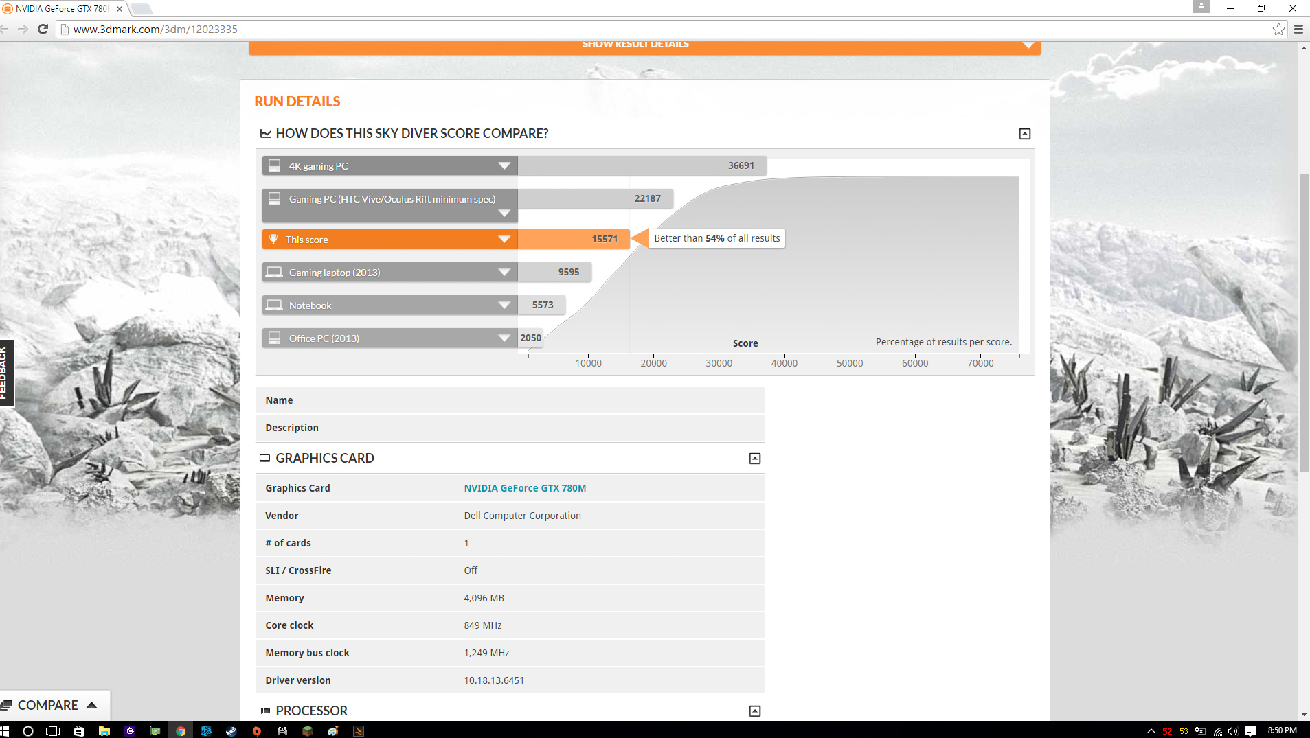

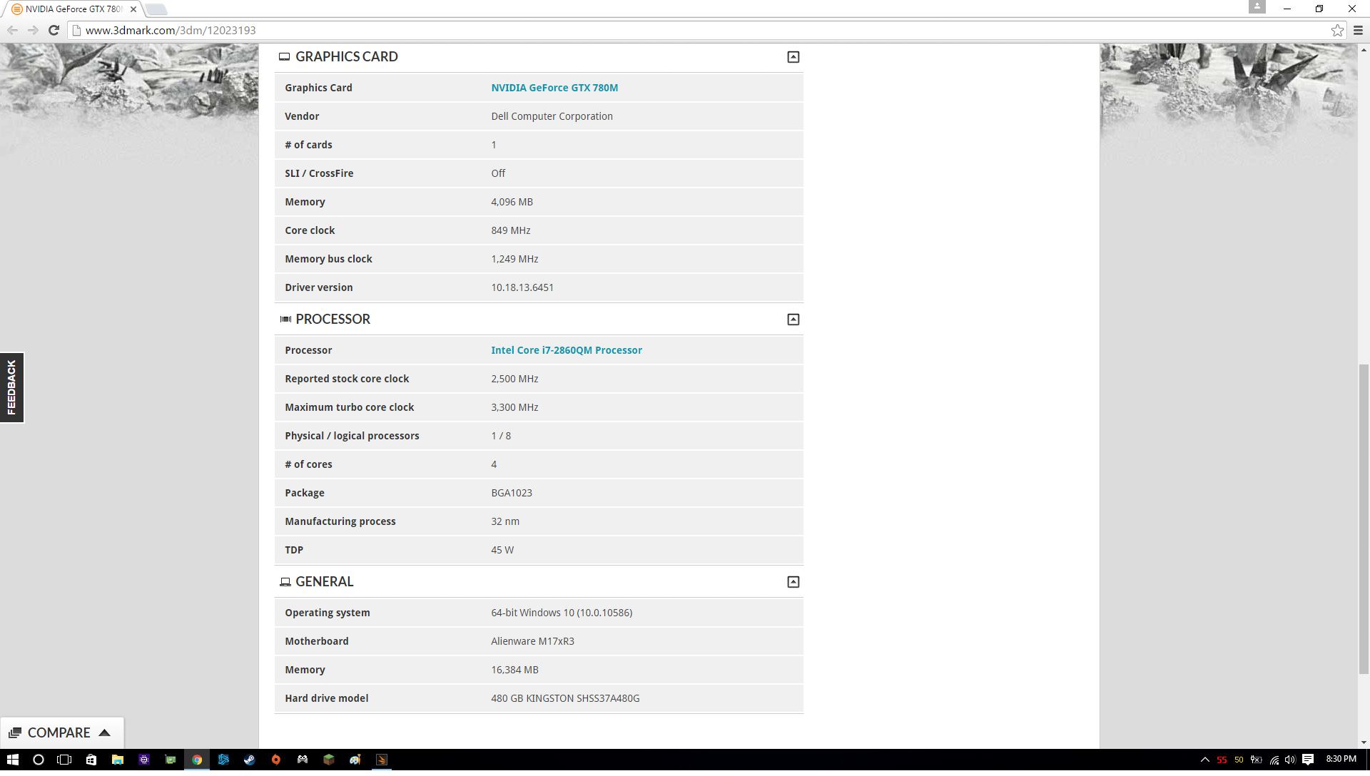

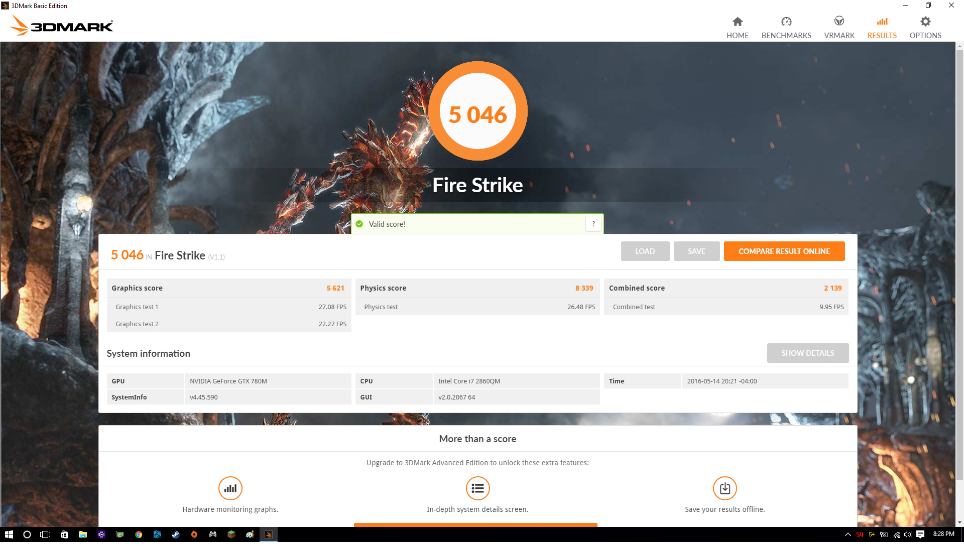

BDogg464 Posted May 15, 2016 Author Share Posted May 15, 2016 (edited) ok so downloaded a free 3dmark benchmark and ran it, its just a basic edition so i just ran it as is. It was a firestrike benchmark here's the screenshots of the results. Is this good? Bad? Normal?? just trying to make sure this card is running how it's suppose to. Edited May 15, 2016 by BDogg464 edit Quote Link to comment Share on other sites More sharing options...

Zoldago Posted May 15, 2016 Share Posted May 15, 2016 I never benchmarked a 780M in a R3 with firestrike, but i knew a guy that installed a 970M in an R4 (1 or 2 weeks ago) and he got something around 6300 pts in firestrike. So i think your 5000 pts are ok. Quote Link to comment Share on other sites More sharing options...

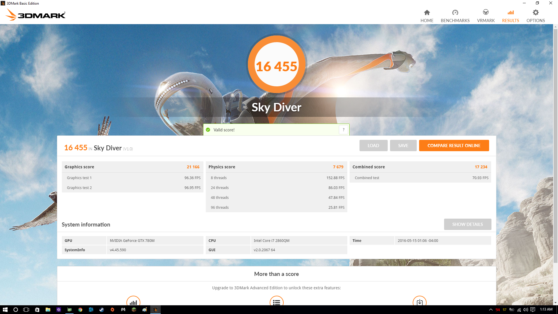

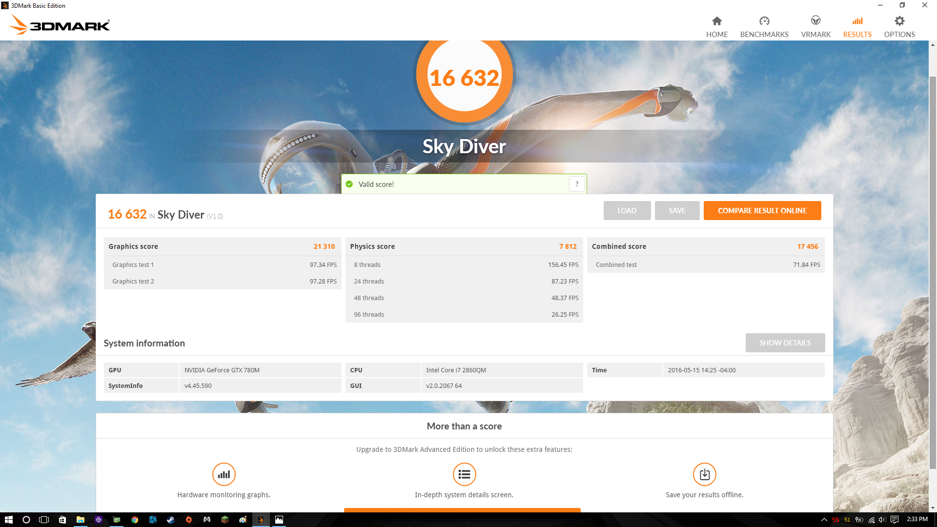

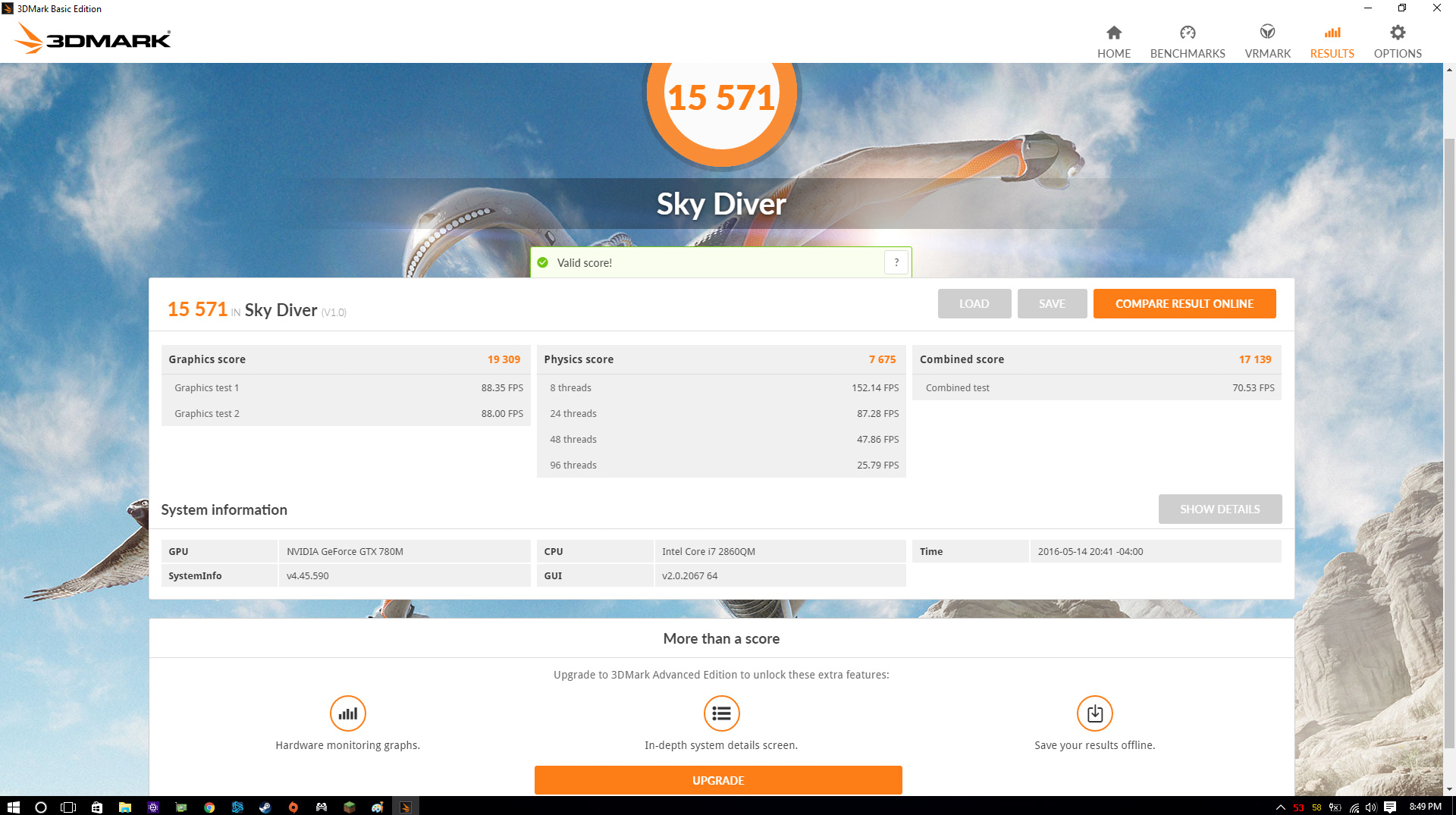

BDogg464 Posted May 15, 2016 Author Share Posted May 15, 2016 This is before and after bios flash slv's from this site no changes only vbios is different. I did'nt expect to see to much or any from simply flashing to an unlocked bios and not changing anything. But still looks like it changes the behavior for the better. So what are people setting these things to with their overclock settings? I know nothing about this card and just kinda been messing around with it. +100/+185 makes a nice stable improvement for me over the stock clocks. Hav'nt messed with any voltages know to little. Don't know what people have been tweeking that to or anything. I see alot about people undervolting these. Quote Link to comment Share on other sites More sharing options...
