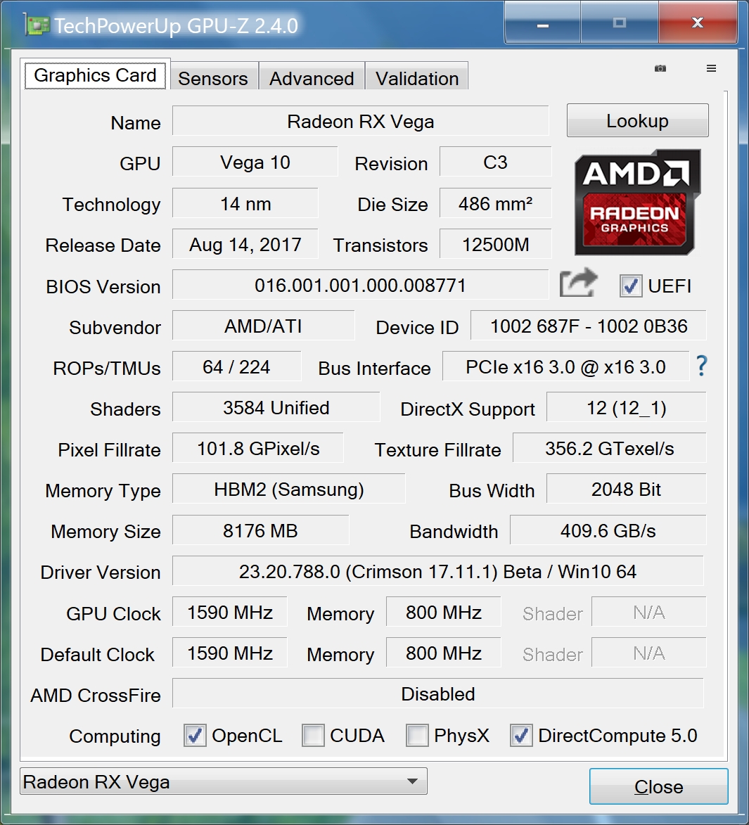

Can anyone account for the following? According to GPU-z, my Vega 56 is using all 16 PCIe lanes. It was my understanding that the Ultrabay supported only 8 (the other 8 lanes being used for the internal NVIDIA GPU).
I ran the bus render test, but it still says 16 lanes.
I also saw something else that is of some interest today: Windows has re-enabled both the Intel and the NVIDIA graphics module - yet this is no longer causing any problems. No idea why. Better drivers? A change in how Windows 10 treats systems with multiple graphics modules?
Edited by Bos Maior
Got my Vega 64LC and its the same thing in gpuz, it shows 16lanes. And yes my windows also re-enabled inel/nvidia gpu's.

I wonder if the fact that GPU-Z is reporting 16 lanes is down to Gerald's adapter having a PCIe x16 slot to plug the graphics card into, or whether the card really is using 16 lanes somehow.
On 04/11/2017 at 2:55 PM, Bos Maior said:
Cool stuff!
I used SiSoft Sandra to check what type of PCIe bus the external graphics card uses. It's PCIe 3.0 x8, attached to a x16 controller. The bandwidth is 15.63 GB/s - as one would expect.
