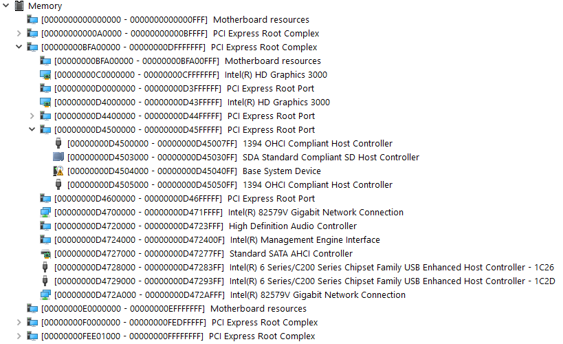

Somik 0 Posted February 20, 2017 Hi, I have tried below setup and am still stuck with BIOS blue screen error. Can someone please help me with the correct modded BIOS and the steps to use it? Would really appreciate any help in this matter. Thanks in advance. My setup- HP Laptop DV7t-6c00, GTX 1050ti and eGPU Beast 8.0 BIOS is F.1C Steps so far - > Connected eGPU and got blue screen, so TURN ON eGPU only after Windows loads > After windows load, turned on eGPU and got error 10. Installed the mobile driver & resolved it. > The got error 12. Performed DSDT with zero error to get Large Memory. Error 12 was resolved. > Now Device Manager shows that GTX 1050ti needs a restart but i still get BLUE screen BIOS error with auto-restart whenever i start laptop with the eGPU as ON. It goes on in loop. Quote Share this post Link to post Share on other sites
gsdhb 0 Posted March 14, 2017 On 6/10/2015 at 8:14 PM, E-Tech Austria said: hy! I'm new here! i've a dell latitude e6530 with hd 4000, 16GB RAM, windows 7 64 Bit and a vidock 4 with an gtx750ti OC! So i need do DSDT Override my laptop, because my tolud is over 3,5gb! So i did it like writen down at your manual but i still got now this error: Does anybody know the problem or a solution? I'm logged an with my account but i'm listed in the group administrators! BR from Austria First option you to do is check Dell Latitude E6530 Manual in which you will get complete long term process regarding how you fix error 12(most appearing error) while DSDT Overridding your laptop. Check it now. Procedure is given below: At Windows boot menu, select Setup 1.35. Boot Setup 1.35 -> menu-based. Select PCI compaction->Endpoint=56.25GB (36-bit) Select PCI compaction->Run compact. ... Select startup.bat->Test Run. Select Chainloader->Test Run. Quote Share this post Link to post Share on other sites

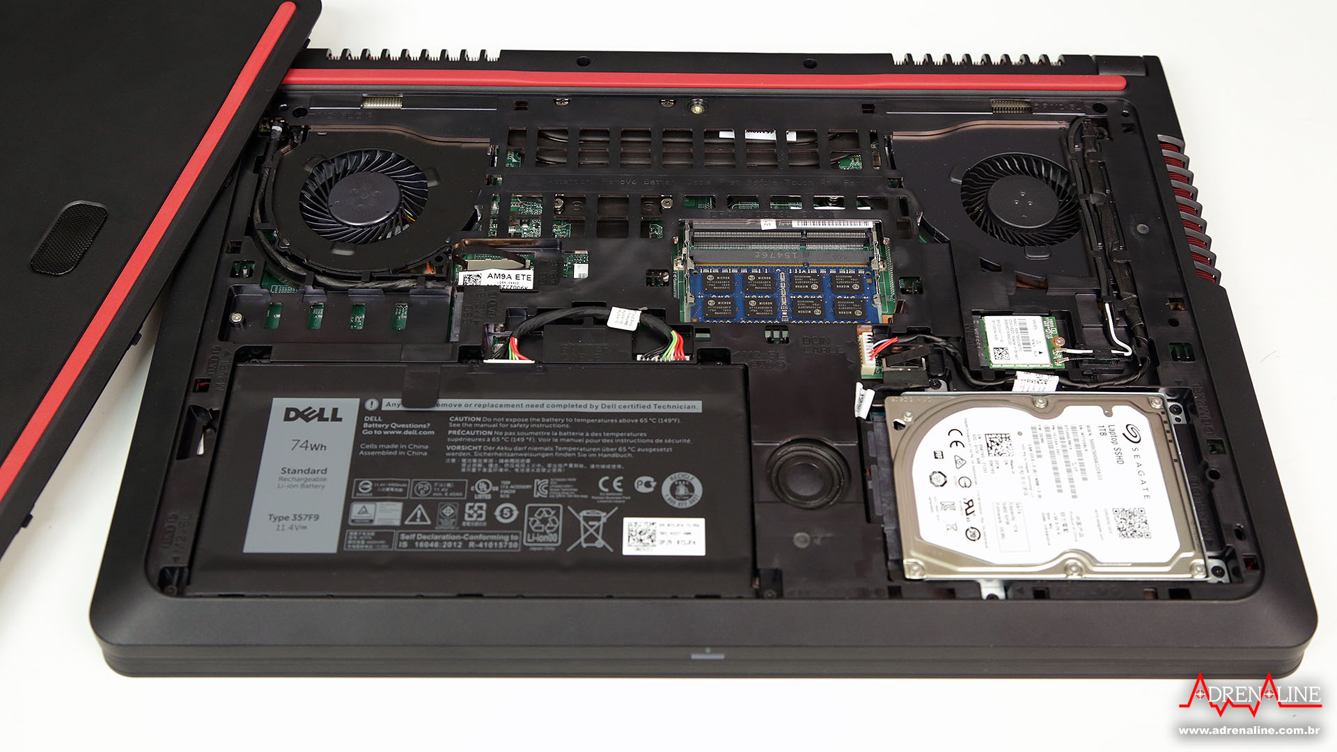

MrNightman 0 Posted May 17, 2017 (edited) I recently purchased an Inspiron 15 7559, with a gtx 960m. I am currently toying with the idea of an egpu setup for it. But it seems i need a NGFF Version like pictured. Just curious if anybody has had any luck getting this setup on a dell inspiron 15 7000 gaming laptop working or not? this is what im working with underneath Edited May 17, 2017 by MrNightman Quote Share this post Link to post Share on other sites

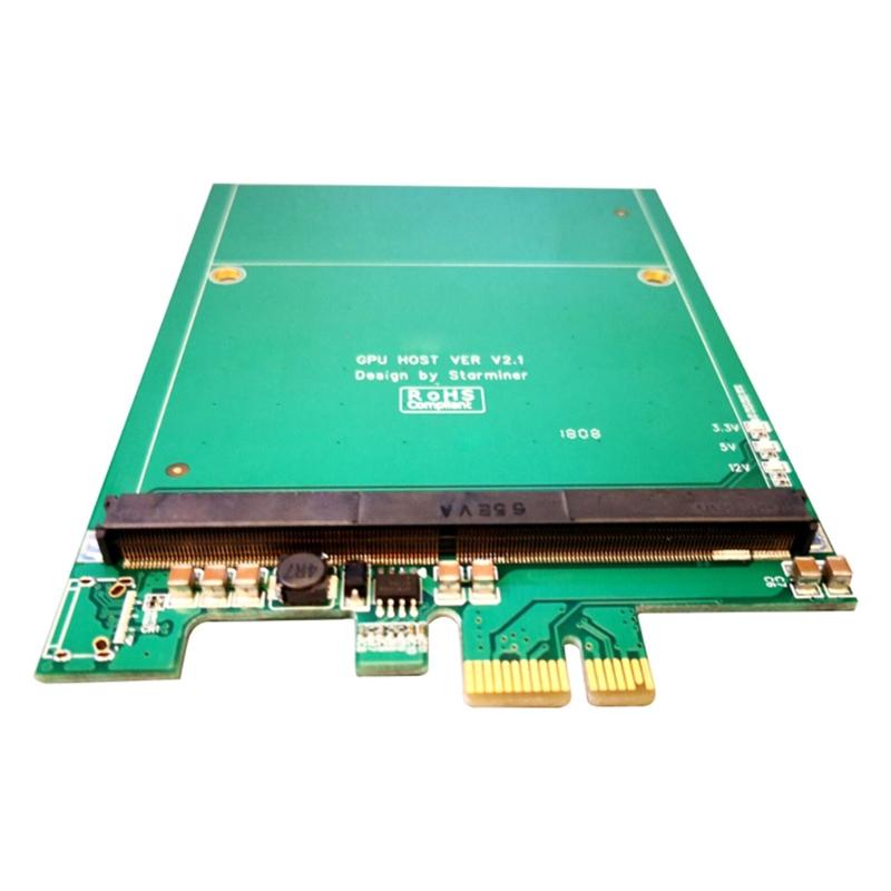

DeG 2 Posted May 10, 2022 Hi all, Acutaly i test this material power on and mxm gpu face is hot if i have materal not detected in sysdm.cpl its suxx iaml looking why; Quote Share this post Link to post Share on other sites
