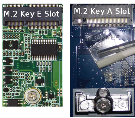

Good day everyone i wich to know if i would be able to do some of that awesome eGPU modding,
Laptop: Lenovo z5070
OS: Windows 10, 64-bit
CPU: Intel® Core Intel i5 4210U CPU @ 2.7GHz
iGPU: Intel® HD Graphics 4400
dGPU: NVIDIA 820M
Im thinking into getting a NVIDIA GTX 960 or 970

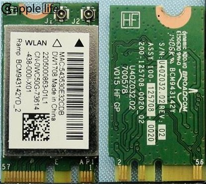

the mPCI-e integrated in my laptop  its M.2 NGFF its the M.2 Key A Slot the right one in the image
with this Wlan and bluetooth adapter
184974_40efc903c8a2917d069d4eb862c6979d.

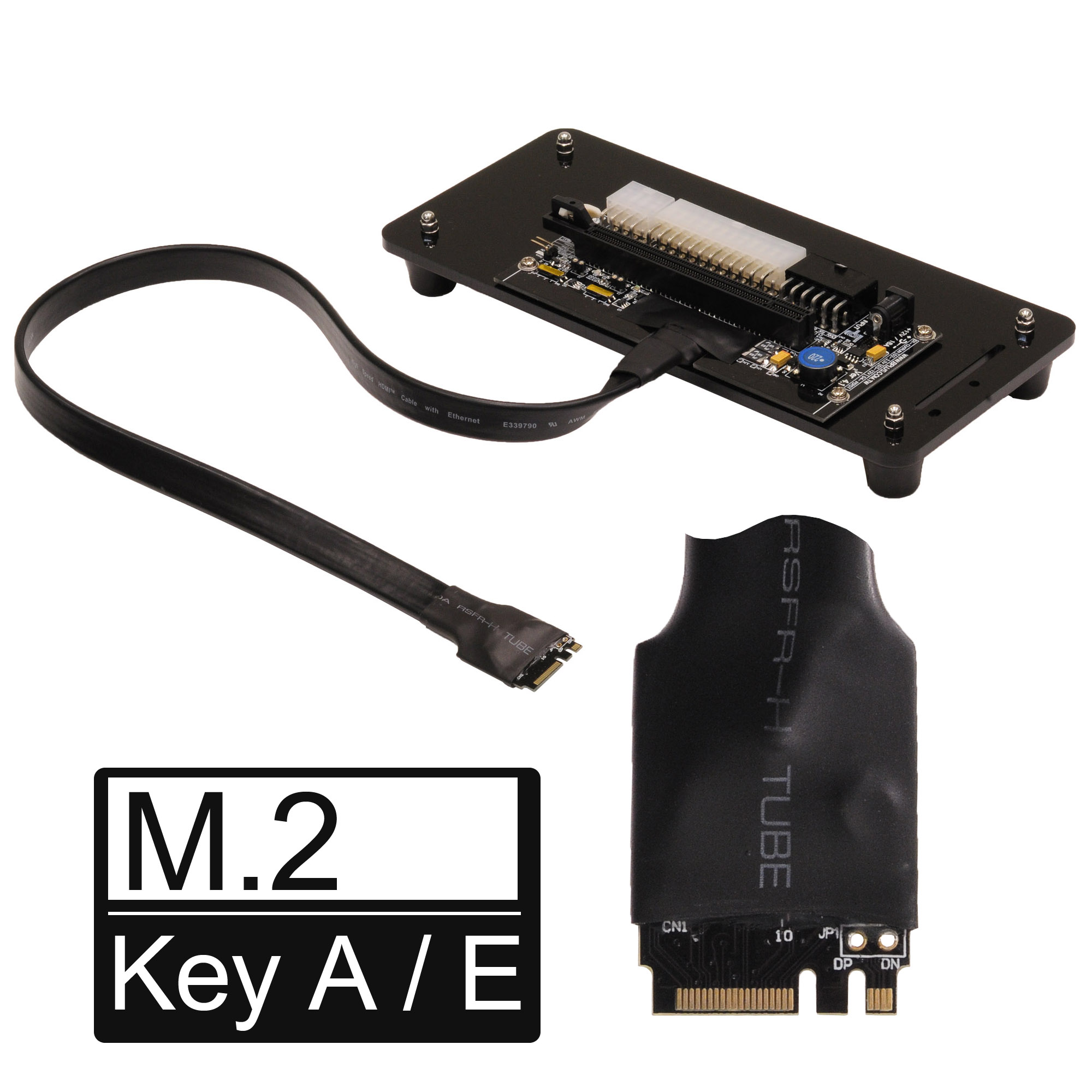

 I wanted to know if this PE4C V4.1 (PE4C-M2060A V4.1 ) will work
http://www.hwtools.net/Adapter/PE4C%20V4.1.html   Many Thanks!!

the mPCI-e integrated in my laptop  its M.2 NGFF its the M.2 Key A Slot the right one in the image imageproxy.php?img=https%3A%2F%2Fwww.thinkpenguin.com%2Ffiles%2FM2-Key-A-E-SLOT.png&key=479adcf8ada665bbff7bef443dbace40e53616ea137605755290132478fd11d9       with this Wlan and bluetooth adapter imageproxy.php?img=https%3A%2F%2Fs3-eu-west-1.amazonaws.com%2Fi.applelife.ru%2F2014%2F12%2F184974_40efc903c8a2917d069d4eb862c6979d.jpg&key=704f1174e00ad99b1f4bdc6f72268e4b77929c78dd6ac8e1de3e5383d7242a78    I wanted to know if this PE4C V4.1 (PE4C-M2060A V4.1 ) will work
imageproxy.php?img=http%3A%2F%2Fwww.hwtools.net%2Fjpg%2FPE4C-M2060A%2520V4.1_1000.jpg&key=e904ad4804e09270fd2b3c61fea3701e52d2597aacc0ba7fb15156b812c48a5e
The PE4C with key A/E is the right for you, but after insert the adapter is not sure it will work , as I know you are the first with that laptop model. The problems can be: not whitelisted slot, tolud.. And some of them can be very difficult to solve.. But you can try if you feel lucky, and you have spare time.
I've made a eGPU setup with a "tested" laptop and I've worked for a month for make it work almost properly.. Maybe yours will be plug and play.. Or with egpu setup software you can do a mod easily.. Bye.
Thanks for the reply, sorry for the questions but i cant seem to find the way to know the TOLUD, because in my case i dont find any PCI BUS its just PCI EXPRESS ROOT COMPLEX ( COMPLEJO RAIZ PCI EXPRESS, in spanish) also can i uncheck the whitelist from the BIOS??
imageproxy.php?img=https%3A%2F%2Fsslcdn.techinferno.com%2Fuploads%2Fmonthly_2016_02%2F56c56c9d70545_Capturadepantalla%285%29.thumb.png.0b14a773b19c8982630a9eca4a7863d0.png&key=6392f7762b5d156a315783c32cbcd6b9e0700a5eed472c84200859ab3031d166
and for last wich do you think would be a GPU card with less errors or less incompatibility issues ATI or NVIDIA???
Sorry for my bad english and for asking too many questions. MANY THANKS!!
Surely you need a gtx nvidia card, as gtx960 or better, and a dell da-2 as supply, but after that you must to try what happens with your laptop, maybe for start if you have another mpci card you can try if the laptop recognize it or get an error on boot, after that you can try the egpu software by Tech Inferno Fan.
