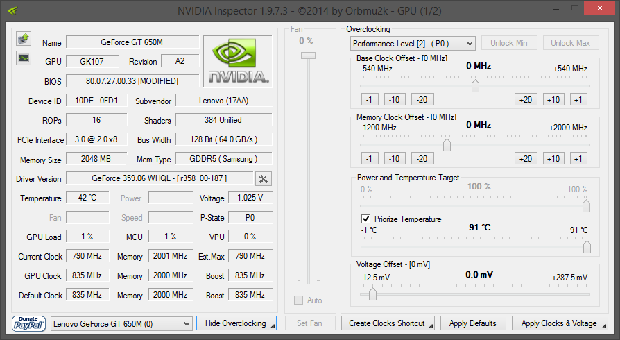

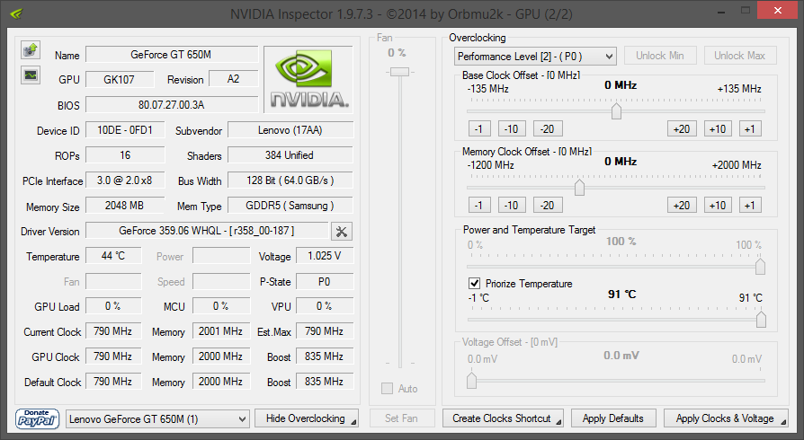

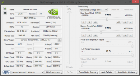

I can overclock the Onboard 650M just fine, but I cant for the life of me figure out whats going on with the Ultrabay. I have flashed it multiple times with the modded VBIOS, but I still cant get it working. This was working for back with I had W7 installed right when I got it. Recently I've had to switch back to the good ol Y500, but I need the extra boost from getting above +135MHz on the 2nd card. Any help would be awesome, thank you.
Looks like you have the correct 80.07.27.00.3A Ultrabay vBIOS for Windows 8.1/10, but it is not unlocked. So you need to unlock it to OC core past +135 MHz. Or go back to Windows 7/8 and use the existing Ultrabay vBIOS mod based on 80.07.27.00.33:

Ok, That's the last vbios I ran acrossed, and it didnt unlock my core. I tried flashing it multiple time, with no avail.
nvflash -i1 -r
nvflash -i1 -6 filename.rom
Any Ideas at to what I might have been doing wrong? Im going to try to flash again, with the file you linked. Maybe the download was corrupt that I grabbed earlier. I dont have to uninstall my Nvidia drivers and reinstall for it to work or something stupid correct? Also, im using the newest version of nvflash, which is 5.163 and not 5.127, could that be the culprit?

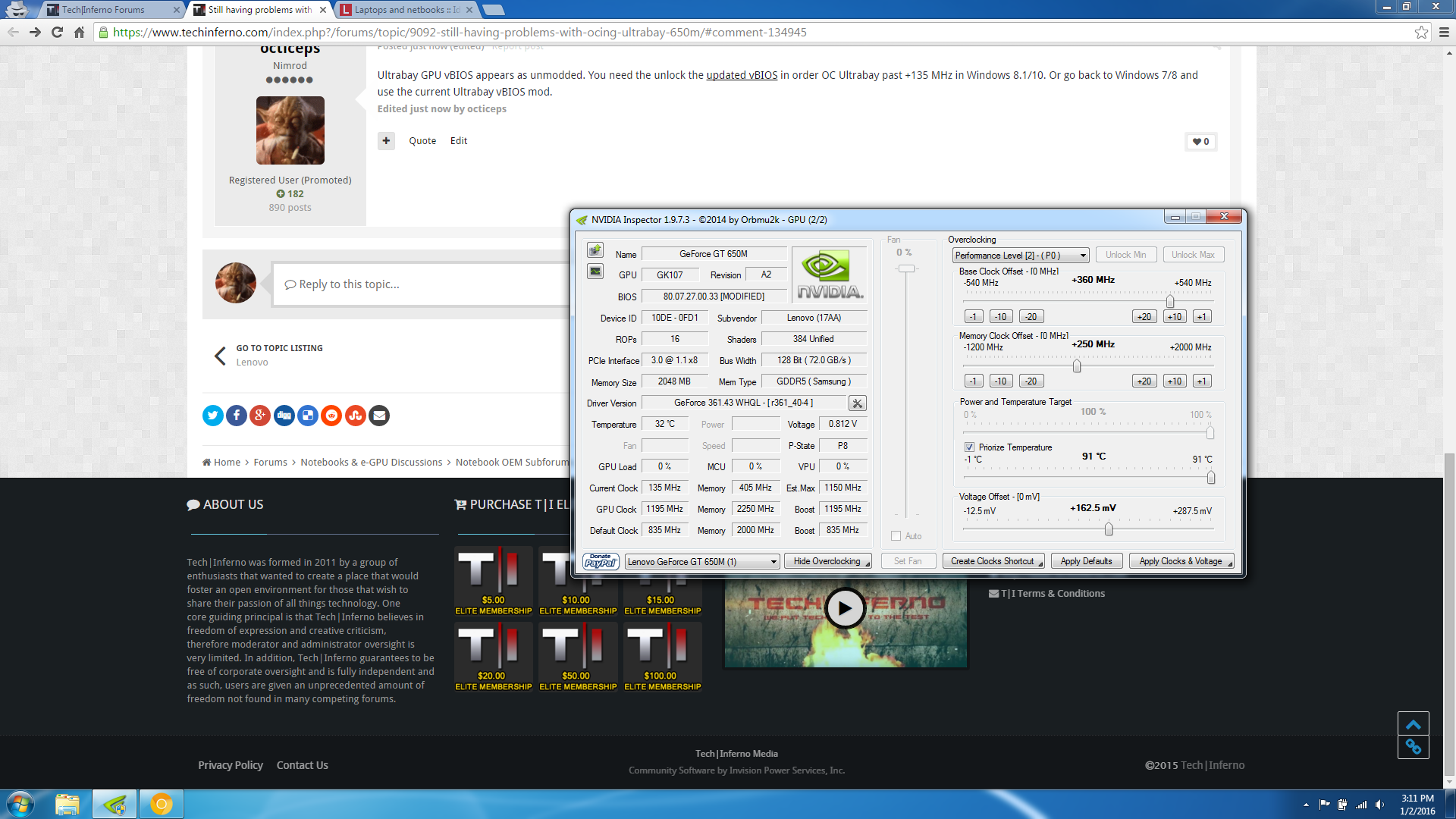

OK I got good news.  I saw in the main Y500 bios mod thread that someone tried using NVflash for Windows and got their ultrabay flash to take.  So I tried it using the latest version of NVflash for windows and boom, my ultrabay is now unlocked and shows the modded bios.  So I don't know if its something screwy with the version of Dos NVflash were using or what but the Windows one works.  Give that a shot.
  • 4 weeks later...
Super strange, because I tried this a bunch of times. Then the last time, I killed any running apps except the Command Prompt, ran the commands, and immediately REBOOTED. This time it worked! So, yep. All the instructions in the original y400/y500 thread still work, even in Windows 10 Pro (x64).
