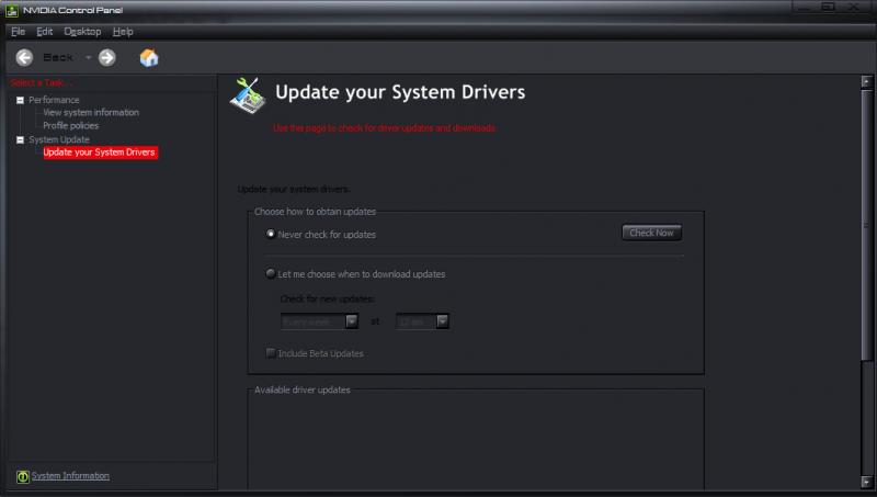

Gearsguy Posted September 21, 2011 Share Posted September 21, 2011 (edited) So looks like my 555M is gone. One can consider that a sort of a downer Anyways, I was playing Crysis 2 when I BSOD'd. Nice eh? Then I reboot back into windows, everythings fine. So after doing some windows stuff for a while (CCleaner, new theme, ect), I go to overclock my GPU so I can finish playing crysis, when I see that my NVIDIA control panel looks like this (and its gone from right clicking on desktop, I just use a desktop icon for it) Then I go into Device Manager to see if I need to reboot the driver or something, and my GPU is no where to be seen. Not even like default VGA adapter. Just the Intel HD. AND THEN, I went to install my drivers again as I still had the files with the modded INF, and it said no compatible hardware found no me gusta Edited September 21, 2011 by svl7 added [solved] tag Quote Link to comment Share on other sites More sharing options...

Gearsguy Posted September 21, 2011 Author Share Posted September 21, 2011 under device manager right click and select "scan for hardware changes" it might detect you GPUNothing :/ Quote Link to comment Share on other sites More sharing options...
